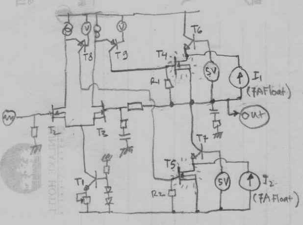

This is what I have in mind. All aspect from this design is from Mr.Pass's tutorial (I think he don't realize it)
First, the goal. I want to make amp, as simple as possible (minimal stages), with input stages that can handle big voltage (Mosfets here), low OL gain with high OL bandwith (passive folded cascode here-from SuSy), with this patent offcourse, sounds good, hopefully with efficiency.
The finals are mosfets (NP said for mosfets suitable for hot operation), cascoded 5V by bipolars, and around each final there is floating 7A current source.
The bias section (which I learn from "Smart Bias" patent) don' use VBE multiplier biasing scheme, but rather bias is determined by T1, and this T1 is put in heatsink for thermal compensation.
The finals are driven exactly the same way, for upper and lower section, both are Nch mosfets.
I know I break many NP's patent in this cct (how many that I break?)
There is still 2 question.
1. For the cascode device (here I draw bipolars) what is the most suitable? Mosfet also, or bipolars?
2. I wanted to exclude the final stage from the feedback loop. In ordinary design with VBE multiplier bias scheme, I can easily do that by taking feedback point from VAS.
But how to do it here?

This schematic is nonsens - " low " cascode is wrong. Don't look only at " Pass'es ", look also at Halcro or older Haggard connection. 😉

Upupa Epops said:This schematic is nonsens - " low " cascode is wrong. Don't look only at " Pass'es ", look also at Halcro or older Haggard connection. 😉
Is it wrong? I looked and didn't see an error, although it's
a greatly simplified circuit.
To Nelson : You have right, lower cascode is variable current source. But whatabout unsymetrical clipping ?
From the looks of it, you'll see severe distortion as the Cascodes
collapse, and that should be reasonably symmetrical - within
a couple of volts. I don't expect to see the output approach
the rail better than about 6 or 7 volt loss.

Nelson, I like Mosfets the same as you like - I know, how works this devices 😎 - solution is easy, little bit higher + rail voltage on VAS 😎 .

The 7A floating current source is not used variably, but always steady at 7A, at all condition.To Nelson : You have right, lower cascode is variable current source
Yes, the higher voltage at folded cascode/VAS will be usefull. I also forgot to draw gate stopper resistors.

Upupa Epops said:Nelson, I like Mosfets the same as you like - I know, how works this devices 😎 - solution is easy, little bit higher + rail voltage on VAS 😎 .
That's how we do it on X600 and X1000's. Works like glue on
a folded cascode.
