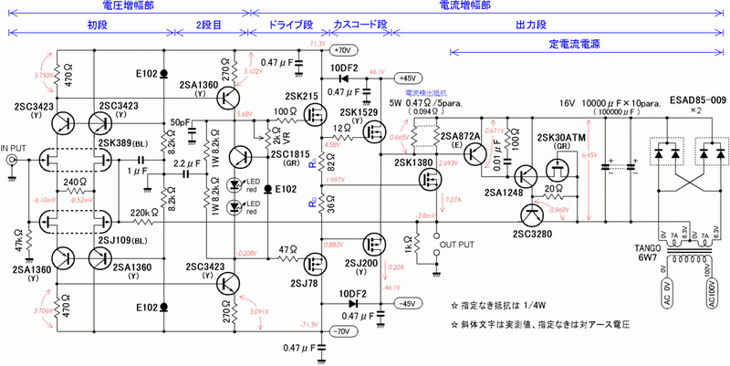

Would it be the device 87 is 2SK1380 and the device 97 is the 7A Tango transformer?

Mark A. Gulbrandsen said:
Hey that schematic looks like some of the old SAE's that I used to repair......! I think this guy is in the wrong forum...thats definately not an Aleph... Looks more like a vintage Bongornio to me(spelling?).
Im glad to hear that this schematic dosnt have anything to do with Aleph, cause i spent quite a bit of time trying to figure where the resemblence were 😀 with no succes :xeye:

mrothacher said:
Could the Aleph 0 be thought of like a power op amp with a big pull-down resistor? If so, I wonder if this would work with something like ZV5?
For resistor, read big constant current source, and you've got the
Aleph 0. Aleph 0s, also.
It will amuse you to know that the X150.5 amp uses that
approach to provide single-ended bias at lower wattages.
And yes, it will work with ZV5.
