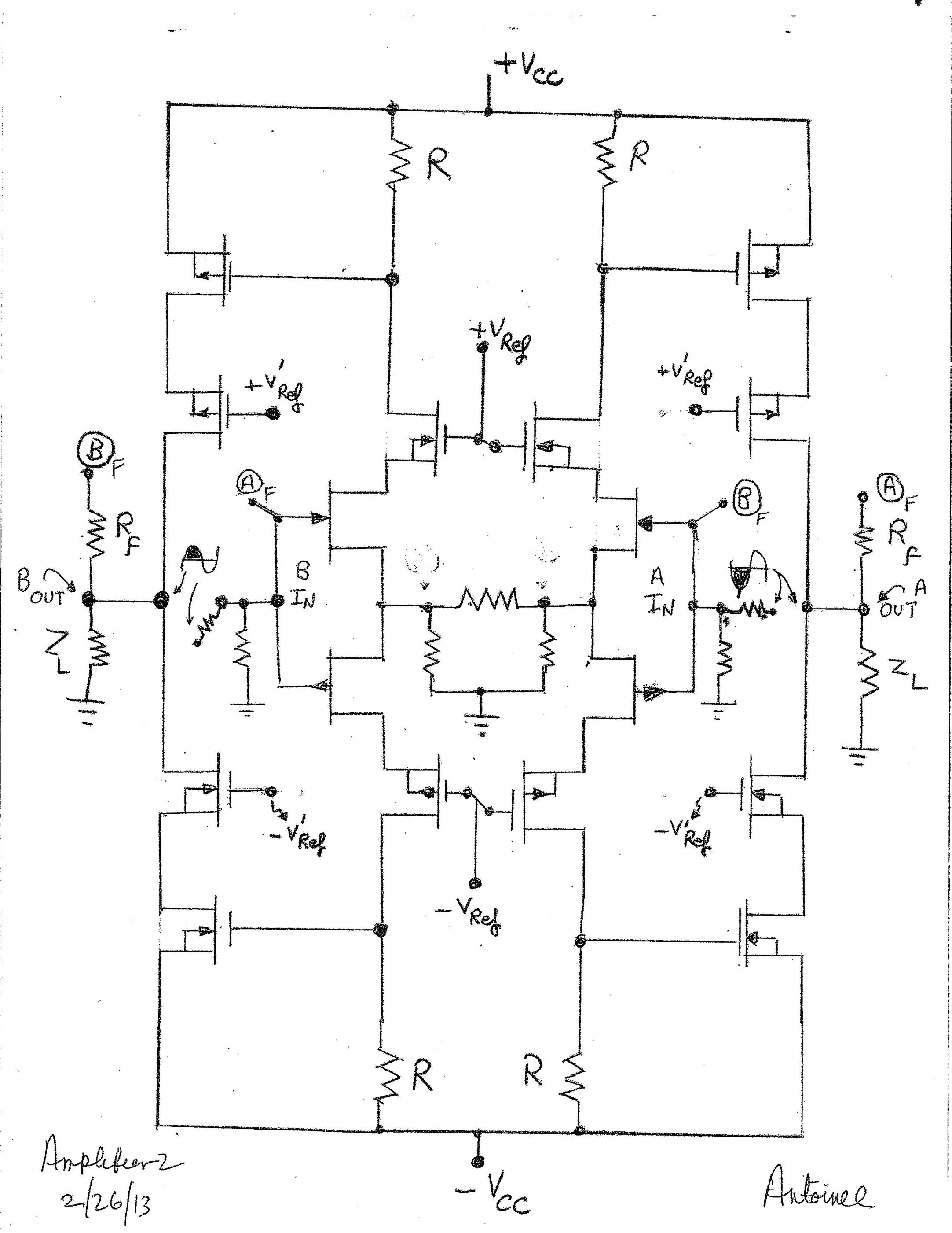

Cascoded Amplifier
There was talk in past posts about cascoding. I apologize to DIYers for asking late cascode questions which have already been asked and fully answered. The attached image shows a schematic which utilizes the cascoding practice of the transistors in the dual BA3 Front End schematic of post #225. Looks cluttered, may have a typo or several; but is actually simple to follow. Choose your wine. Classic cascode as in the FW article ZV8, or modulated cascode as in ZV9, or CLF [Xs amp literature] or mix and match.
- The current schematic like its uncascoded parent appears to approach an absolute symmetry of topology. Everywhere one looks, there are identical and complemetary mirror components [ in an ideal world].
- Some may refer to the negative feedback used in both schematics as Schade Negative Feedback. I prefer to call it Pass Negative Feedback which is specific to solid state devices. BTW, Pass Negative Feedback also appeared in Figures 1 and 2 plus the front page of US 5,376,899.
- But; this is a second distinct type of Pass Negative Feedback. It emanated from a second mirror [or identical] current source output [opposed drains of Right amp], crossed over and terminated at the summing port of the Left amp. And ditto for the reverse situation. A simultaneous double crossed Pass Negative Feedback.

Gone all the way with transistors. Others may wish to clarify the polarity of Schade Feedback.Got too many transistors in there. I thought Schade was postive.
