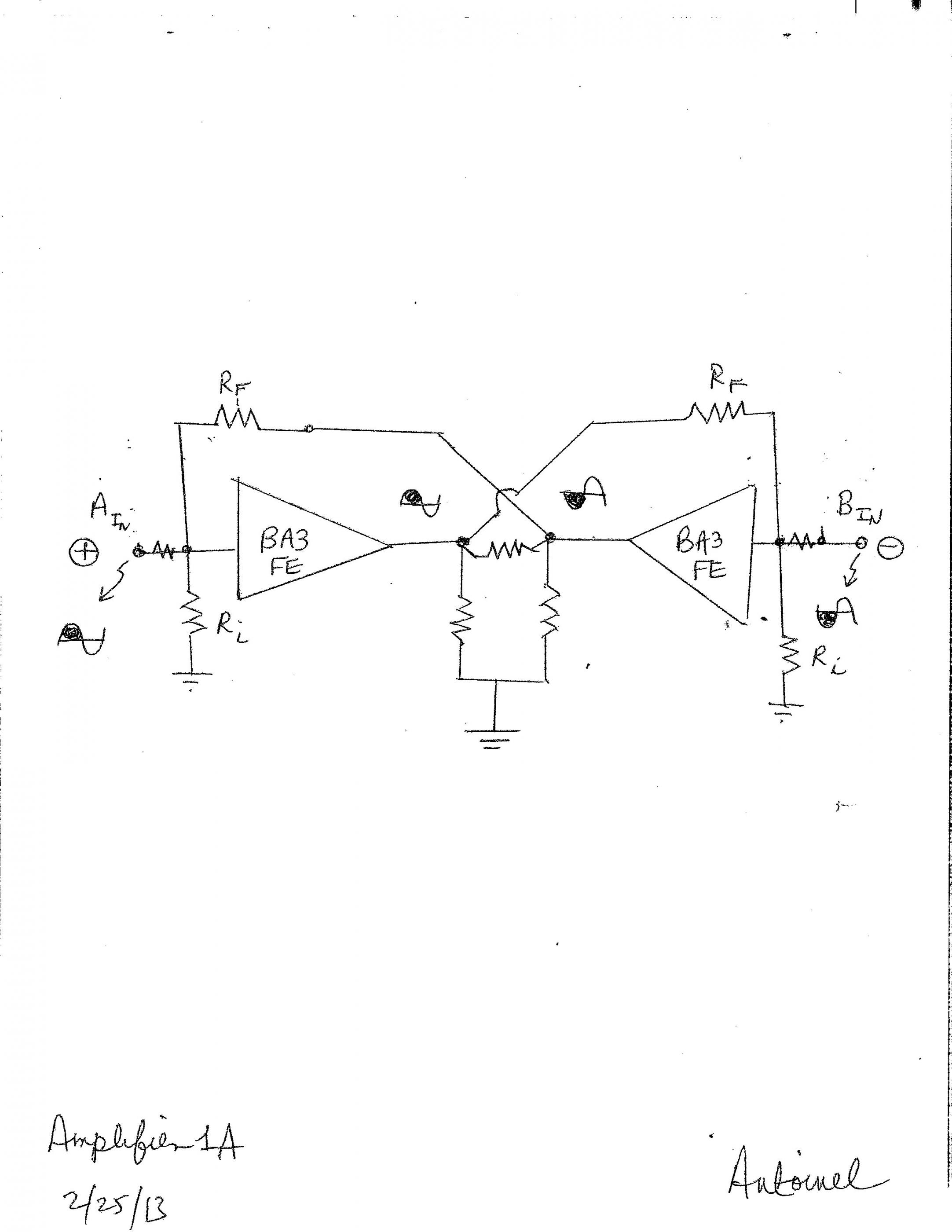

The schematic of this Amplifier was inspired by the literature of Pass Labs for its Xs amps, and the contributing literature of DIYers in this thread. Image1.jpg shows two side-by-side schematics of BA3 Front End amplifiers [cut and paste]. Their setup is meant to be balanced push-pull. Play this game with me. Partition the page into 4 quadrants care of 2 orthogonal axes smack in the middle of the page. Assume there is the highest degree of matching among/between components having the same function; e.g Q3 of both amps etc . Note the following:
  • Top right and left quadrants circuits are mirror images; identical performance.
  • Ditto for bottom right and left quadrants circuits.
  • The top and bottom right quadrants circuits have identical complementary symmetry performance.
  • Ditto for the top and bottom left quadrants circuits
  • The top right and left quadrants circuits have identical complementary symmetry to the bottom right and left quadrants circuits.
  • The circuits in the top right and bottom left quadrants have identical complementary symmetry performance.
  • Ditto for the circuits in the top left and bottom right quadrants.
  • I modeled both BA3 Front End amps with the triangles above them.
This total amp circuit [Amplifier] has a high symmetry and a high identical complementary symmetry. Take a look at the second picture Amplifier1A.jpg. Note the following:
  • Both amps have identical out of phase input and power output signals.
  • Note the feedback loops. The power output signal of the right amp is the feedback signal to the left amp. Simultaneously, the power output signal of the left amp is the feedback signal to the right. Each amp accepts this reality because of the system's high symmetry.
I do not imply or mean that the above pertains to the Pass Labs Xs amps in any form, way, or fashion. Just inspiration!
Best regards
