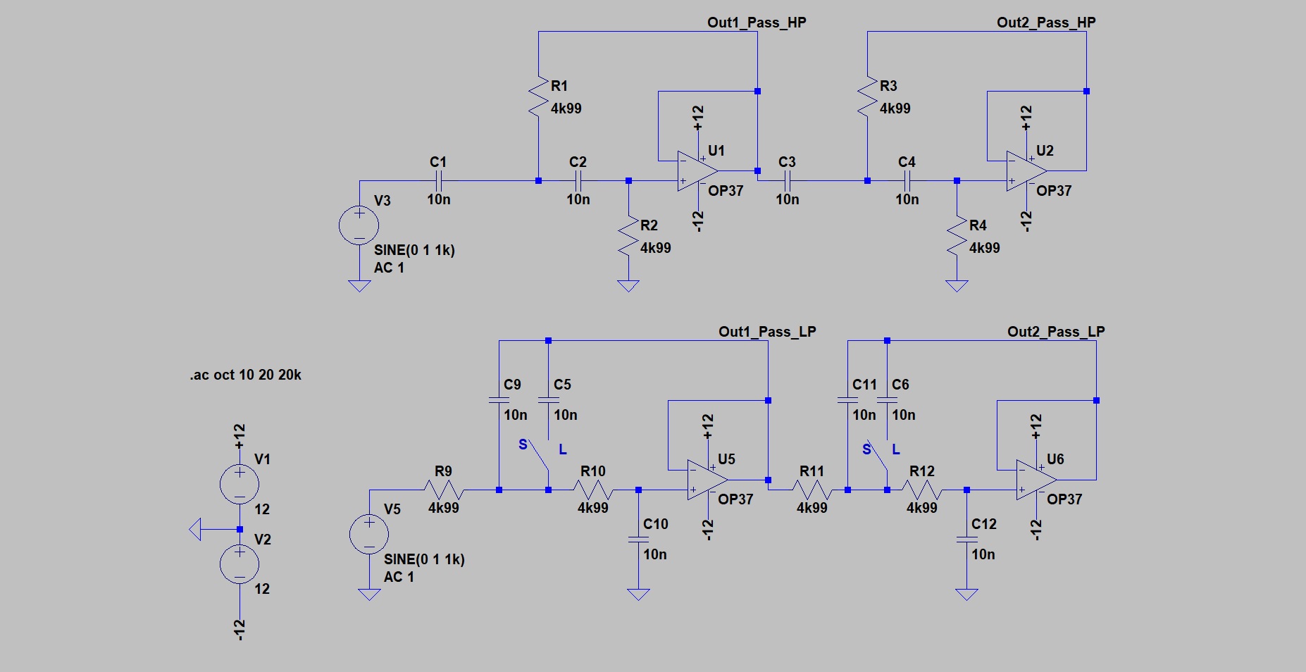

I tried to reverse engineer the B4. My guess is attached. The Rs have values ", 2R, 4R, 8R, ...
For the LP part of the B4 crossover, opening all DIP-switches will open R9 - R12 (see attachment). This means no signal will reach the inputs of U5 and U6. (Likewise, opening R1 - R4 will the audio straight to the positive inputs of U1 and U2. I guess maybe the gates are grounded via 1Meg?)
