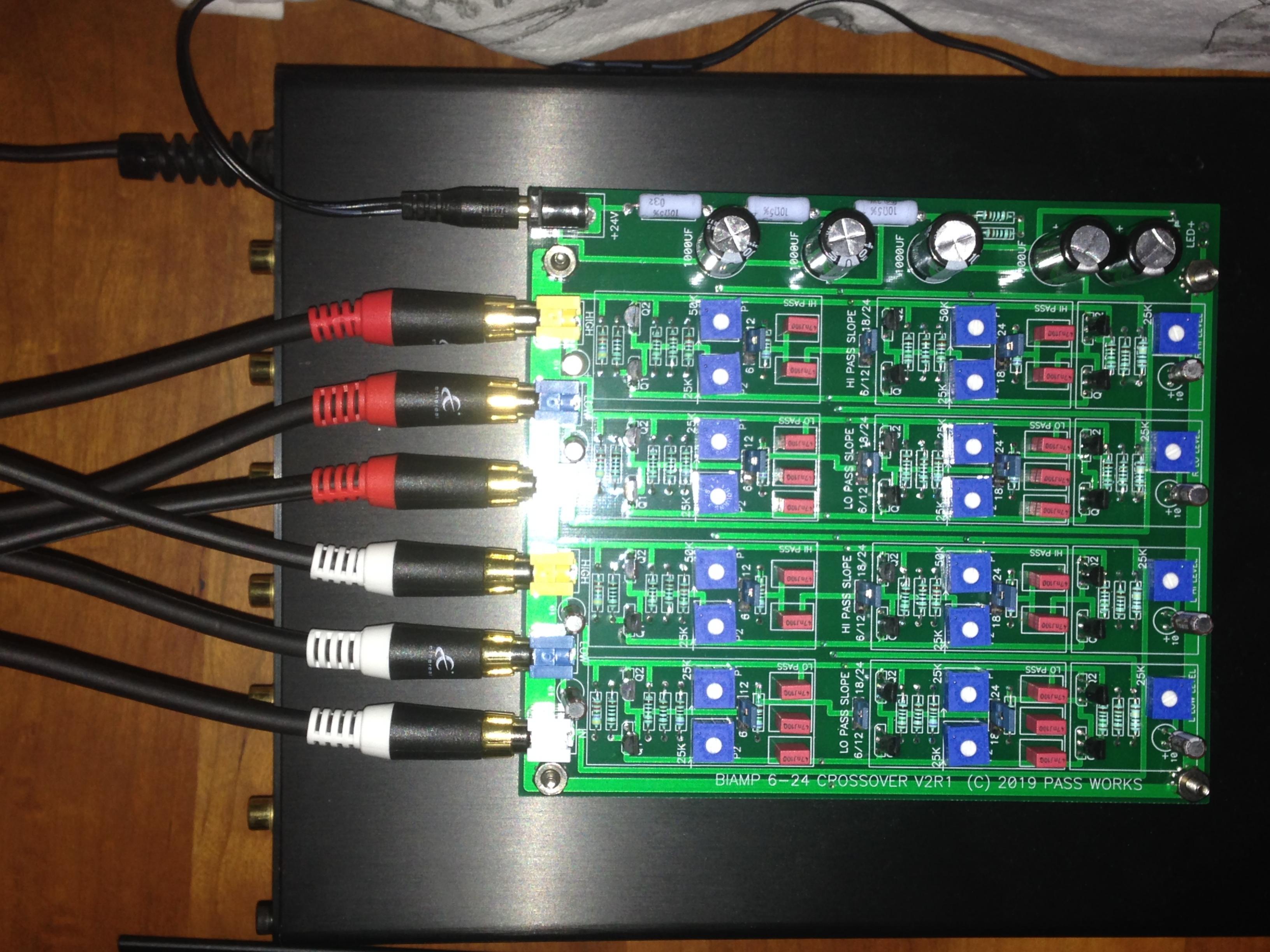

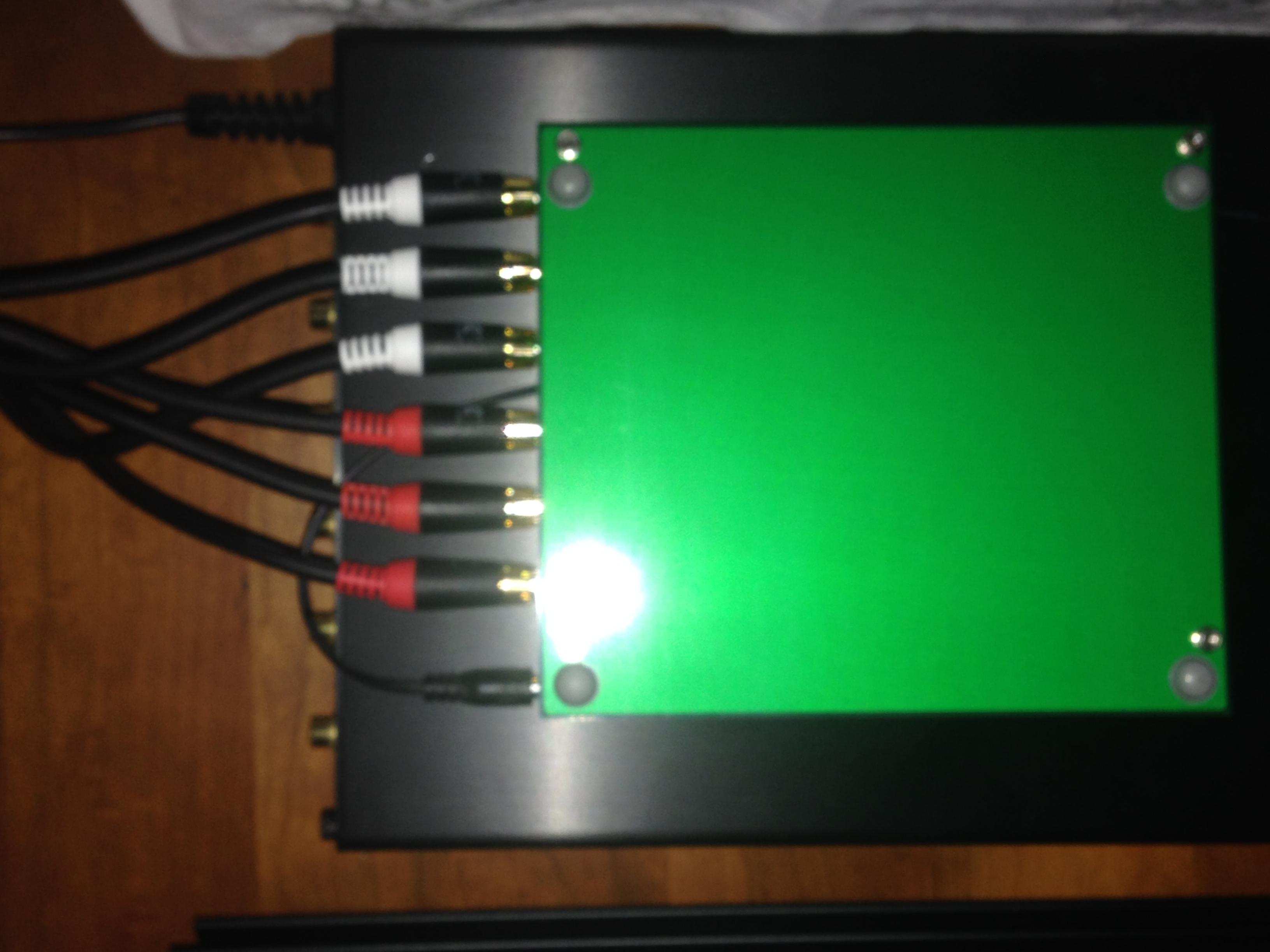

WBS is enjoying a unit with a ground plane board mounted under the main board,
which makes for a cheap shield for those not using a chassis.
The holes for the RCA connectors are a bit large, so maybe I should just provide
both types on the board if no one objects.

to WBS
Pics are good enough. I can see what I want to see. 😱 🙄 Looks very promising!
Have a good weekend!
Dirk
Dirk
Will this have level matching capabilities for OB drivers? similar to B5?
Match a top unit with bottom woofers?
JP
JP
JP, the level pots are to the far right of the photograph, from top to bottom:
Right high level
Right low level
Left high level
Left low level
They perform a similar task as the sliver knobs on the front of the B5.
Right high level
Right low level
Left high level
Left low level
