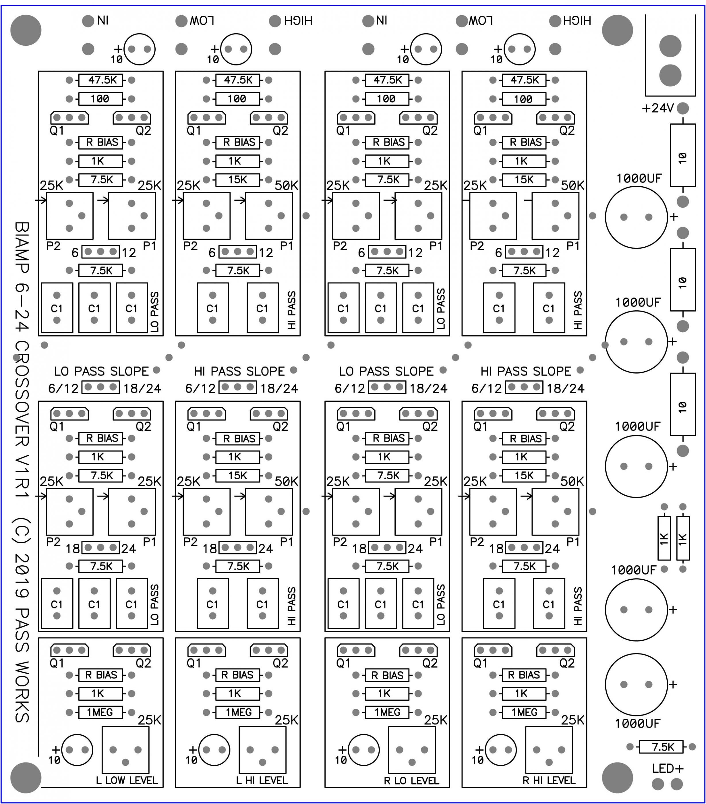

The upcoming design has 6-24 slopes, but also each pole is adjustable over
2 octaves via on-board pots. Cost difference between that and 6-12 is
marginal, and you can bypass unused circuits.

Will the Linear Systems LSJ74/LSK170 be suitable for this new x-over? I just noticed they are back in stock and am considering nabbing a pair for the new build.
Would be nice to know which grade and how much we need... or better a bom for buying the parts now 🙂
