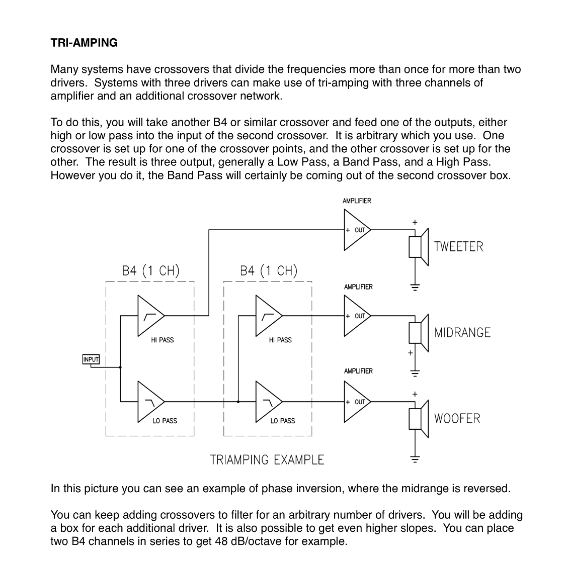

Use two for tri-amping

B5 and PAP both are 6 or 12 dB/oct biamp with Eq for the bottom and top.
B4 is 6,12,18,24 db biamp with no eq.
Both have level and frequency adjustments.
Thanks for the quick response. The bottom eq in B5 is for BSC? In the case of B4, how does one compensates for the BSC? Sorry for the many questions as I am trying to understand how best to fit into my system. Maybe I should get both the B4 and B5 kit 🙂
The B5 has configurable BSC in the high pass section and non configurable low frequency boost for dipole woofers in the low frequency section. I suggest going to the First Watt website and looking up both the B4 and B5 under products. The manual for each crossover can be downloaded with lots of detail on what adjustments are available.
