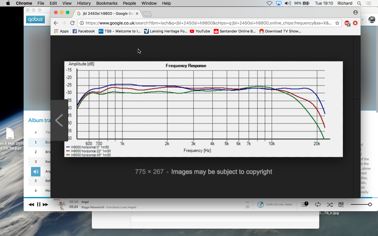

It’s been suggested that a tweeter isn’t needed.
I thought about adding 045BE , but after many conversations and living with 2435 in a 2-way I must admit I’m a little torn . I’ll add it if needed . I want to see how close I can get this combination to my TAD 2404 .

Got a driver voltage curve for it?
See post#2 for the SPL and impedance plot.
Truextent Diaphragms in JBL four-inch compression drivers
I have the 2446H with Yuichi A290 horn (blue plot).
The low end is open-baffle AE Dipole 15.
Plan to cross at 600Hz region (recommended for the A290 horn)
Post 34

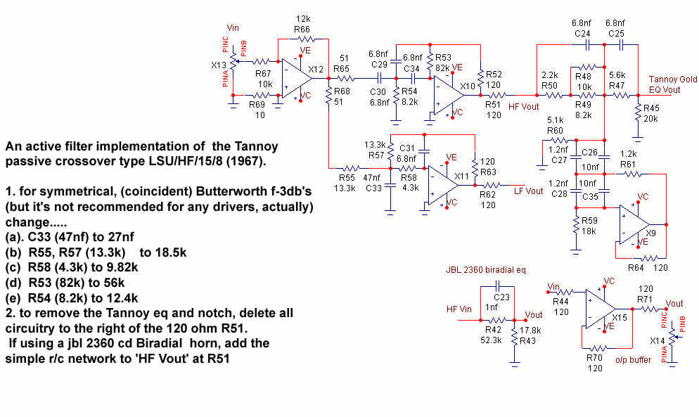

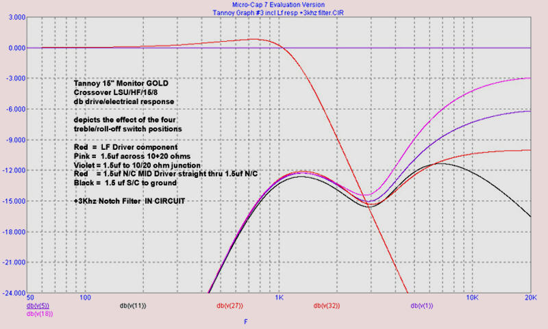

I want to try the DIY B4 in a biamp setup for a pair of Tannoy Monitor Golds. The circuit for the horn in the passive crossover incorporates a notch filter at ~ 3kHz and a slope correction at higher frequencies. I was thinking I could just retain that part of the passive crossover and use the B4 for the high and low pass. Does that make sense, or is it likely to be better to incorporate all of the corrections in the active crossover (which sounds pretty complex...).
I am attaching some curves representing the passive crossover corrections from John Riddley (tannoy). The violet line represents the correction without roll off in the tannoy crossover. The HPD probably uses a similar circuit - same tweeter. I have seen schematics for active crossovers, but the correction circuit looked very complex.

I'll be keen to see that schematic, though my electronics skills are pretty rudimentary.
The HPD succeeded the Monitor Gold some time in the 70s. The tweeter / horn remained little changed across many generations of the vintage Tannoys, and the HPDs and Golds have pretty much identical circuits for the tweeters in their crossovers. The earlier Reds didn't have a notch filter, so I guess they had a nice peak in their response.

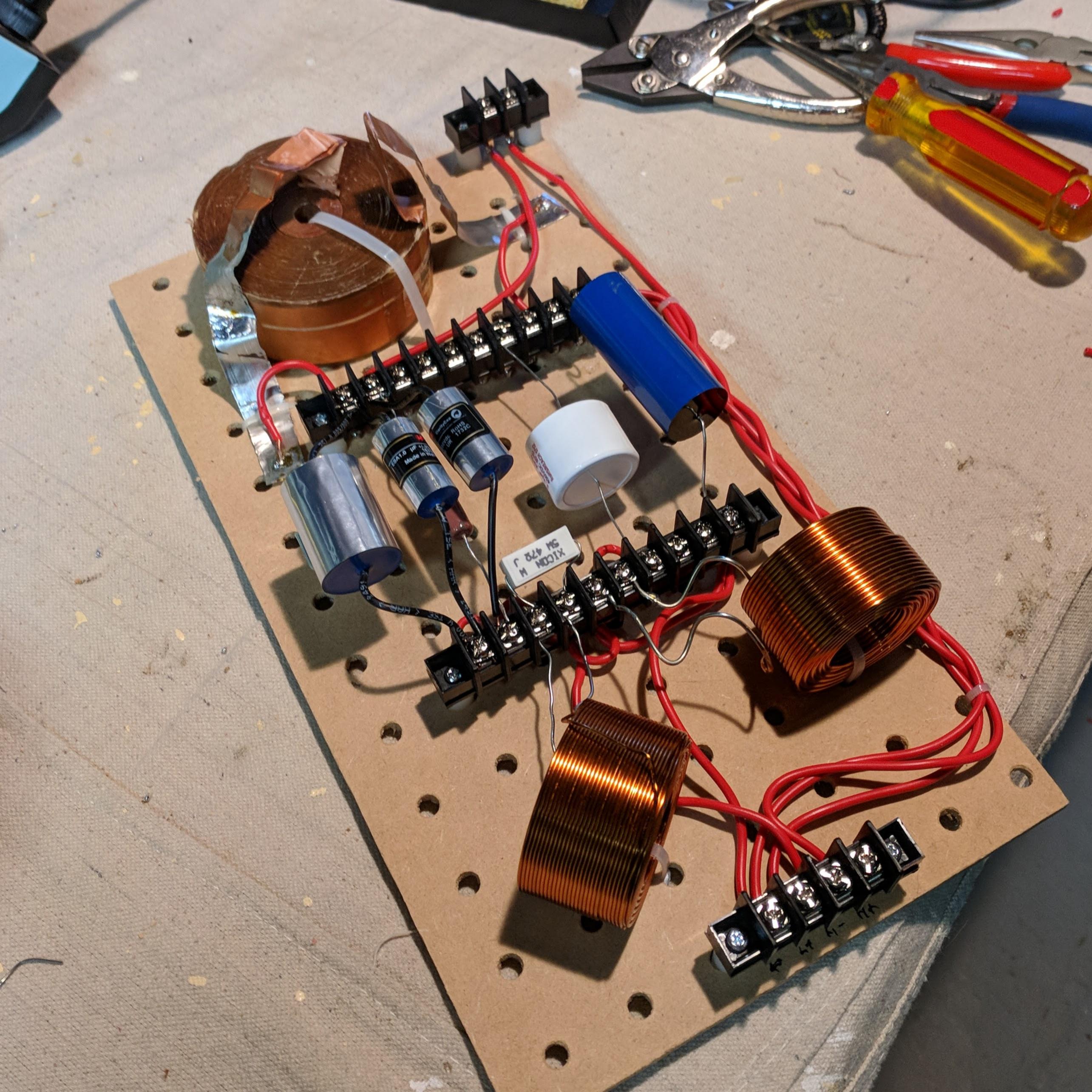

I had a look. The high pass, notch filter, and equalization look like the same design as the Monitor Gold. The results you get with a passive crossover seem to vary a lot depending on the type of caps you use in the tweeter circuit. I wound up building a crossover that allowed you to swap out the capacitors easily.
that's easy - just use good ones 🙂
and use proper chokes
and make air-choke autoformer , instead of eenyweeny original (autoformer still being necessary , due to 1.25db necessary uplift in mid range)
I think Pa also have air-core autoformer on input of HF section

It's not just how "good" they are - there seems to be synergy with certain types of caps. I just downgraded from Jantzen Superior Z caps to a mix of Clarity ESA and Mundorf EVO oil caps, and it sounds better.
