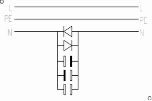

For the "bzzzz" from the amps, Nelson is right it's about DC residual on your AC line.
The Cleaner someone shown could be built easily. A rule of thumb seems you can do one with a big diode bridge, big capacitance bypassed by a high quality fim capacitor. This "DC block filter" can be conveniently built in a plastic box for safety, with a AC line plug in and an AC line plug out. Then you connect your amp on it and it won't bzzzzzz anymore 🙂
Afterwards you can even build one per apparatus eg one for your source and one for your pre. The rule of thumb is described here: per 100VA, 10.000uF capacitance
DIY Audio Projects
the site uses frames so I can't point out the right page. Go to tips and tricks then •230V/AC DC-Filter
I try to attach pic of schematic here
Technique was used long ago in power amps such as Mark Levinsons. Those modules can be placed right in each DIY apparatus, or in external box for hifi regular. One per element can make the DC block more efficient and capacitance adapted to each element's power consumption.
Less than 10 euro for the filter 😎
