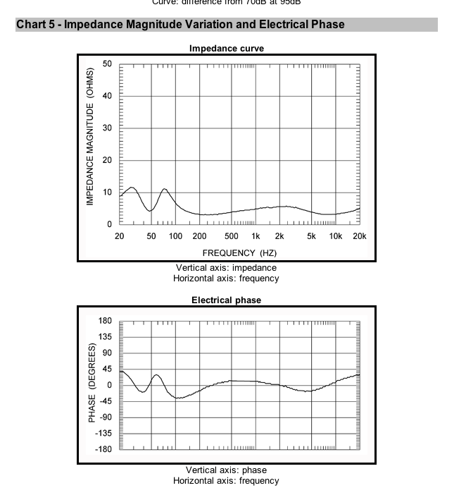

Measurements
I estimated the Thiel CS2.4's voltage sensitivity to be slightly higher than both average and specification, at 88dB(B)/2.83V/m. However, despite Wes Phillips' conjecture that this speaker is not too hard to drive, its impedance plot (fig.1) indicates that the CS2.4 demands a lot of current from amplifiers. Not only does its impedance drop to 2.73 ohms at 600Hz, but it stays significantly below 4 ohms from 100Hz to 50kHz, and there is a difficult combination of 4.5 ohms magnitude and –45° electrical phase angle at 80Hz. Thiel CS2.4 owners should make sure they have a good 4 ohm–rated amplifier to drive this speaker
here are the plots ....🙂 or 😱
