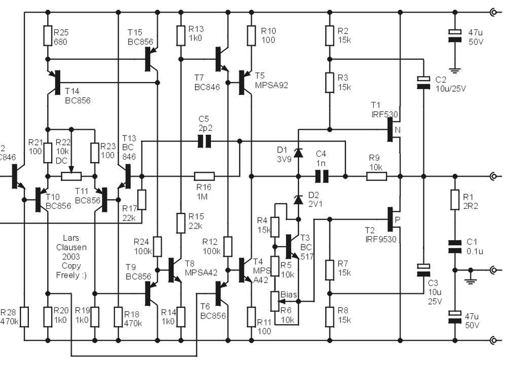

Other option with powerJFET
Nelson and the rest of the threaders,
Impressed with your contributions, I find this the time and place to throw in another idea.
For a long time I have been thinking about a topology to use a power JFET in a (almost) rail to rail output on an amp.
With normal bootstrap one output device can be driven to its rail, the other by far not. Using the power JFET also the top transistor in the schematic can be driven close to the rail.
This will improve the poweroutput for a given rail voltage and thus the efficiency.
When the Lovoltech parts will be available I want to try this idea. Any comments yet?

I believe that will work, but I notice that you pair the JFET
with a P channel Mosfet and use bootstrapping to drive it
to the negative rail.
If you want to use complementary Mosfet followers rail to rail,
you can bootstrap on both sides of the bias source, and drive
it from the center.

Nelson Pass said:I believe that will work, but I notice that you pair the JFET
Yes that's the idea.
In that case the driver has to go rail to rail still, shifting the problem.Nelson Pass said:
it from the center.
My idea a single ended driver can go from almost top rail to below bottom rail.
Still don't know if and how an NJFET and PMOSFET will team up.
Rick

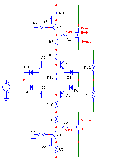

Hi, Mr.Pass,
I've been thinking about this. It is about your NP-PMA. This is an error correction circuit.
Does this NP-PMA always needs CCS for feeding its upper and lower? Or this NP-PMA can use the Double bootstrapped like the quote above? NP-PMA error correction always needs high impedance CCS or it can work with just double bootstrapped?
I know that CCS and bootstrapped differs in output impedance, but each has own pro's and con's in different areas.
If you want to use complementary Mosfet followers rail to rail, you can bootstrap on both sides of the bias source, and drive it from the center.

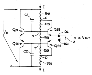

lumanauw said:I've been thinking about this. It is about your NP-PMA. This is an error correction circuit.
I think you'll have to refresh my memory. What is an NP-PMA?
Hi, Mr. Pass,
Hi and thanks Dimitri,
In 7 post above, you mentioned about using double bootstrapped for powering the VBE multiplier and inject the signal from the middle.
Since NP-PMA is not ordinary VBE multiplier, and it is Error Correction, can it be powered by double bootstrapped or it MUST be powered by double CCS?
This is the example of double bootstrapped for driving bias generator. Can this method used for driving Error Correction?
