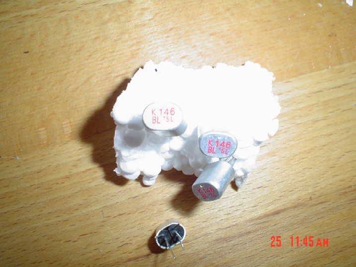

hitsware said:With Jfets aren't the source and drain interchangeable?
This is true for most JFETs, but not all. Sometimes the catalogs will show the die, as for instance the InterFET catalog. If the die is visually symmetrical, then you can interchange the source and drain.
However, some JFETs are asymmetric and exhibit different behavior when the drain and source are switched. I believe that there is some asymmetry in the Toshiba parts. I could be wrong, as I have a vague memory that the long discontinued 2SK146 (two almost as long discontinued 2SK147s in one metal can) may have had the drain and source leads swapped...
I believe at least some JFETs have different capacitances when Drains and Sources are swapped. Whether this is a deal-killer will depend on the application.
I also think I remember seeing a diagram of a JFET where the Gate tapered from Source to Drain (or vice versa).
This ties in with what Charles said. I'll try to remember where I saw these things.

Charles Hansen said:the long discontinued 2SK146 (two almost as long discontinued 2SK147s in one metal can) may have had the drain and source leads swapped...
