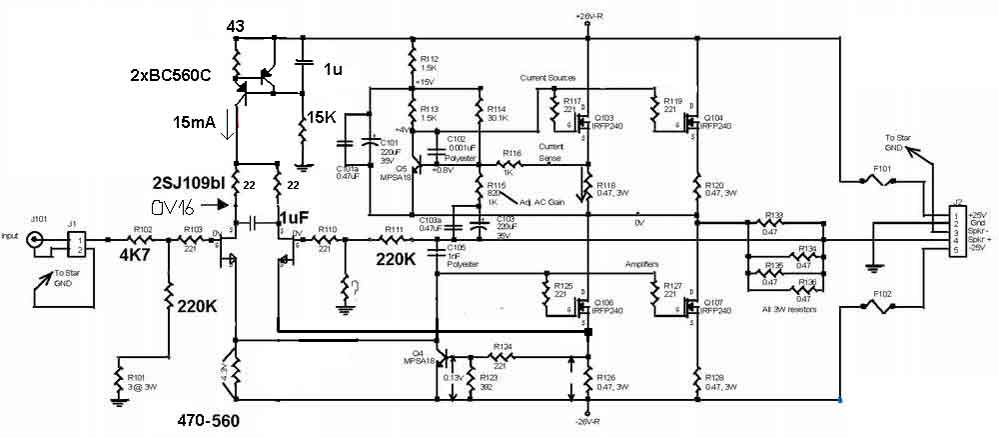

tnx to my friend Oly-few more details changed in my "Babbelfish Aleph J"
double BC CCS
folded cascode etc

Nelson Pass said:
I didn't use the 1 nF lag compensation or compensation on
the npn in the current source, but I do recommend about 7 pF
across the 221K feedback resistor.

The question is not how many devices Nelson is driving, but how much Gate capacitance. From there the conversation biurcates and you have:
a) Gates of devices that are cascoded
--and--
b) Gates of devices that are not cascoded
Cascoding devices doesn't so much make the capacitance go away as make it irrelevant. Crazy people like me are suspicious of cascodes for various reasons, but even I admit that they have their uses. (Particularly when the Lovoltech devices can't take much voltage.)
Non-cascoded devices present more of a challenge, but it's not un-doable. The Gate capacitance needs to be charged and discharged in order to get the job done. The more current you have available, the better. More specifically, what you're looking at is the slew rate. If you don't have enough current, you'll start seeing distortion in the high frequencies first. The current is still struggling to charge the Gate up to a given voltage when the signal passes it heading the other way, having already reached the top of the mountain and gotten tired of waiting, it's heading back to the valley. Since the Gate never got up to the necessary voltage, the waveform is malformed and this constitutes distortion.
There's one other thing to look at with slew rates, and that's the voltage you're trying to swing. If you're only going for 1/10th of a volt, it doesn't take as long to charge the capacitance as it would if you were trying to reach, for instance, 30V. In other words, you'll need more current in order to charge a capacitor to 30V in the same period of time that you could successfully charge it to .1V.
Having said all that, we've backed at least part-way into the answer. The front end in an Aleph doesn't need to swing nearly as much voltage as a normal front end because the Aleph output stage has gain. As a result, you're only looking for enough current to charge the output Gates over a few volt span, not 30 or 50V.
Grey

Everything you say is true. The trick is to take it one step further. Let me see if I can build a case this way:
1) Does the topology of a circuit have an effect on the sound quality?
Obviously. You can choose circuits that tend more towards even order harmonics or odd order harmonics. You can choose circuits that produce lower order harmonics or higher order harmonics.
2) Do the active devices in a circuit have an effect on the sound?
Of course. Active devices introduce distortion. They do not have ruler-straight transfer curves...which is why they call them curves instead of lines.
3) Do the passive devices in a circuit have an effect on the sound?
Though there's still some foolish rearguard action, this was demonstrated thirty years ago for caps and can be heard with any other component you care to name if you have a decent system.
So, where does this leave us?
Most people would put cascoding under category 1 and forget about it. Well, unarguably, it is a topology choice. But...it also falls under 2 and possibly under 3 as well, depending on how picky you want to get.
Inevitably, people focus on the device sitting under the cascode. Look, it's snug as a bug in a rug! We've taken all this load off the device...etc. etc. etc. Pretty much the same points you just made. Again, I say that it's all true. But note that there's a tendency to overlook the cascode device itself.
The cascode still has to swing voltage and current, even if it has relieved the device beneath it of the voltage burden. Who's going to relieve its burden? Another cascode device? (Yes, you can find examples of several cascodes stacked on top of one another, but let's just assume the usual arrangement.) Once you look at the cascode itself, you can make all sorts of arguments based on the capacitances of the cascode device or the thermal drift as the device heats and cools due to the large swings of current, etc. All I'm saying is not to get so blinded by the benefits to the gain device that you forget the cascode itself.
So what to do? For starters, don't use a cascode unless you actually need one. In the case of these Lovoltech JFETs, it's pretty much inevitable that you're going to have to in order to get anything more than the smallest signal out of them. They need help in order to stand even modest voltage. That's fine, and I'm quite happy to use a cascode in this case because it's actually needed.
It's like current sources. Some people use them the way they use salt on food--without thinking. It's a reflex action. There's a blind, habitual aspect to this that is bothersome. Sometimes the best current source is a current source. Sometimes the best current source is actually a resistor.
Likewise, sometimes the best cascode is no cascode.
Assume nothing. Make each component and each topology choice earn its right to be there. Never throw anything in "because that's the way it's always done" or "everybody knows this is best" or "because I saw it once in a Rowland Research schematic and they must know what they're doing." Actively point to each and every component of your schematic and ask yourself why it's there. If you can't answer, take it out. Even if you can answer, ask yourself if it's really necessary or is there perhaps another way to accomplish the same thing.
All this is just an elaborate way of reminding yourself to create simple circuits.
