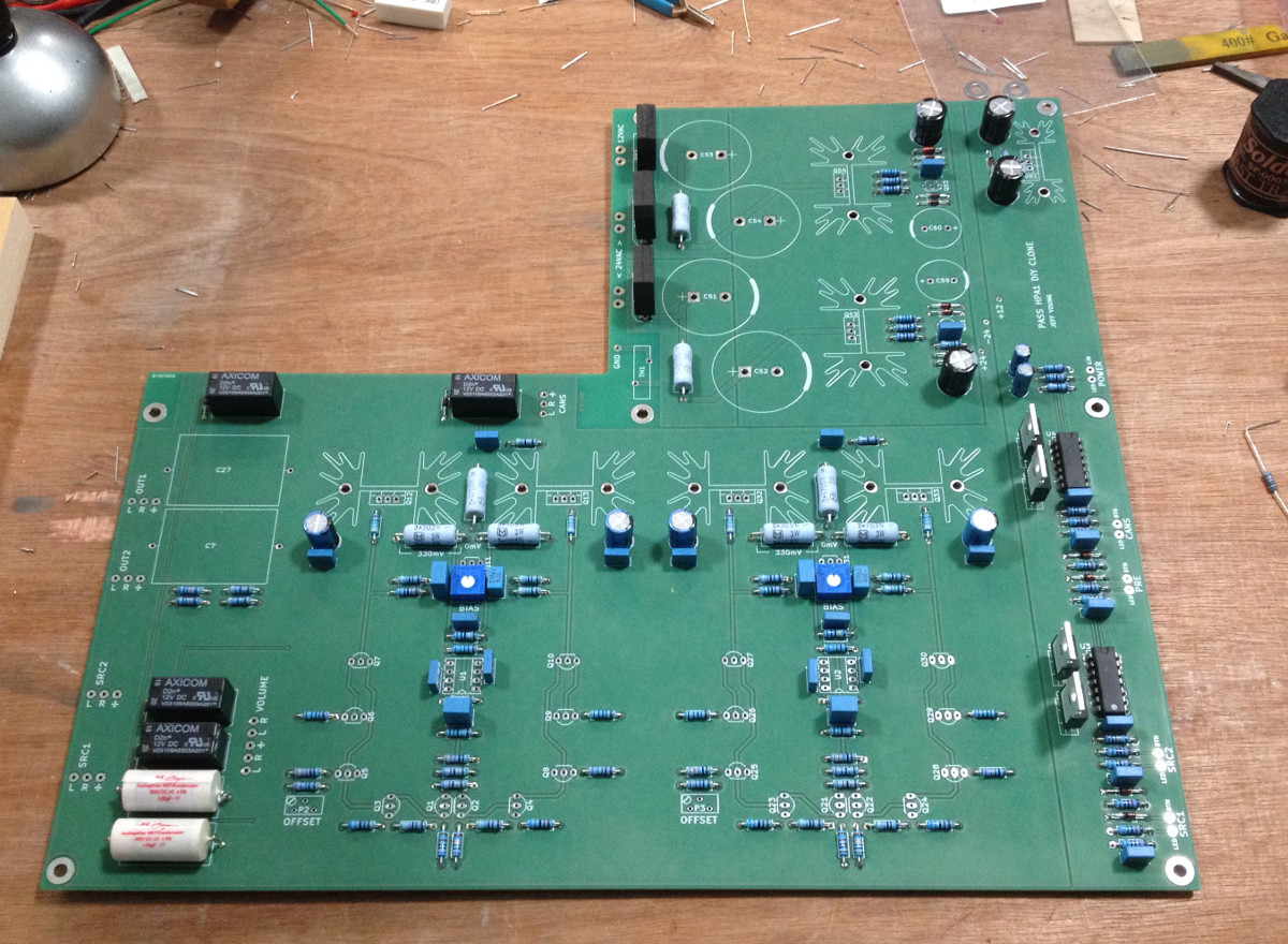

I agree about the Wilson. A Buffered Feedback mirror also has 3 transistors, but the connections don't appear to match what little we can see on the board.

Don't worry Jeff, the ones in the Cubie2 are actually normal cascodes, not folded. 🙂Oh no. Now I have to figure out what a "folded cascode" is....

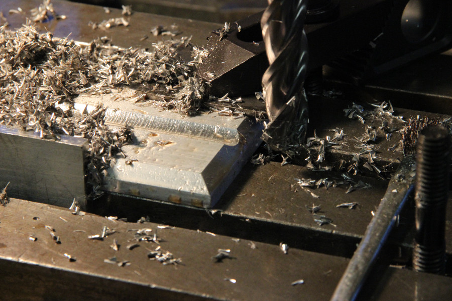

I got a bit of time to start on the front plate of my DIY HPA-1.
Copying the Pass Labs version isn't an option because my mill is the old-fashioned kind (I don't even have digital readout), and the setup charge for anodising single units is too high (which means an off-the-shelf volume know). But I am trying to keep it in the same vein.

Did you do that yourself? With a drill? How did you make the sides of that panel?
Can you give us more information?
Wow I thought only expensive CNC's could do this?

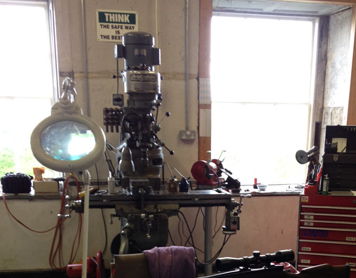

No, not a drill. An old 1950's Bridgeport milling machine. The sides were done with a 45º milling cutter (basically a big countersink), and the groove was done with a ball-end end-mill.
I cut it to size first on my table saw with a 120-tooth carbide blade.

OK, let's talk about matching.
The input JFETs I assume should be matched as closely as possible (given the constraints of N😛 matching). Presumably Idss is a good enough proxy for gm.
The cascodes are just "voltage umbrellas", so I'm guessing no matching required there?
The current mirrors are going to mirror the current through the JFETs, so I'm guessing don't need to be matched top-to-bottom. However, I think the transistors within each current mirror need to be matched for hFE in order to get a 1:1 mirroring?
The servo will zero the offset, so it seems the output MOSFETs don't need to be matched. But will matching them make their distortion profiles more consistent or anything?
