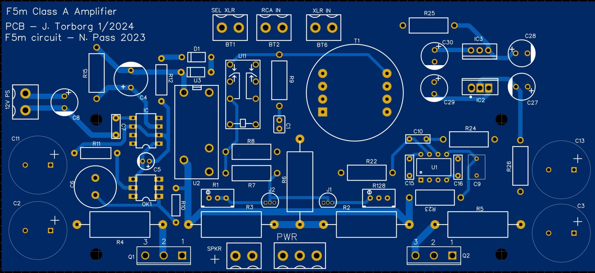

I've got a couple of chassis that I used for a previous pair of monoblocks that I'm going to repurpose for two F5M stereo amps. I designed a PCB to use the same mounting holes for the PCB and MOSFETs on the two side heatsinks.
In addition to the basic amplifier circuit, I added Jensen input transformer for balanced input (as well as RCA), a DC servo circuit, and a speaker protection circuit with delayed turn-on relay.
I just finished the design and haven't fabricated these yet, but plan to send them out in the next few days.

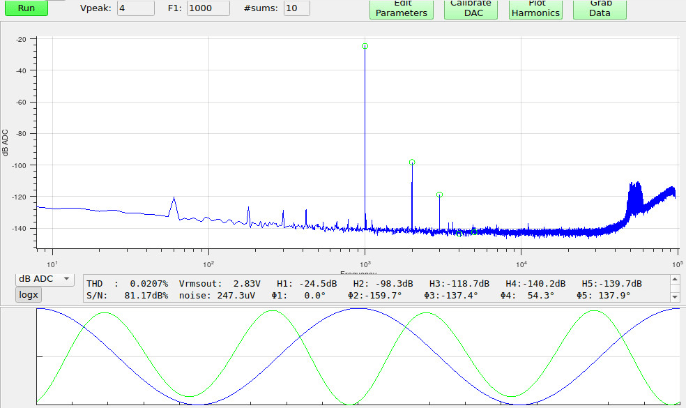

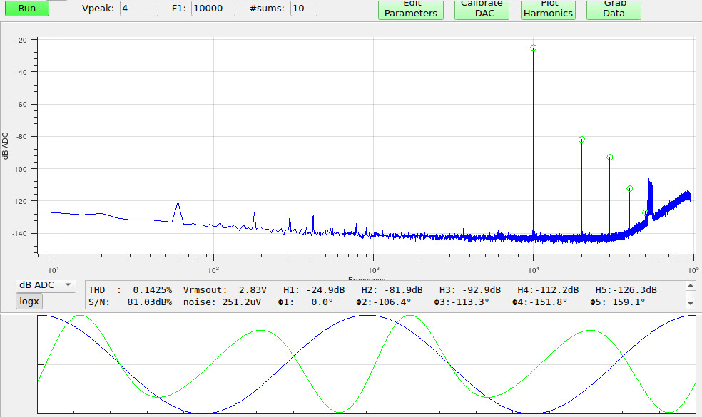

My FFT plot was normalized to absolute ADC levels. The fundamental at -25dB corresponds to 2.82Vrms output followed by a 10:1 attenuator.
Would you be kind enough to show a FFT for 10kHz at 2Vrms, for comparison ?

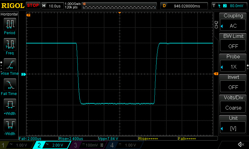

And maybe a 10kHz square wave into 8R//100n,
If not too much trouble.

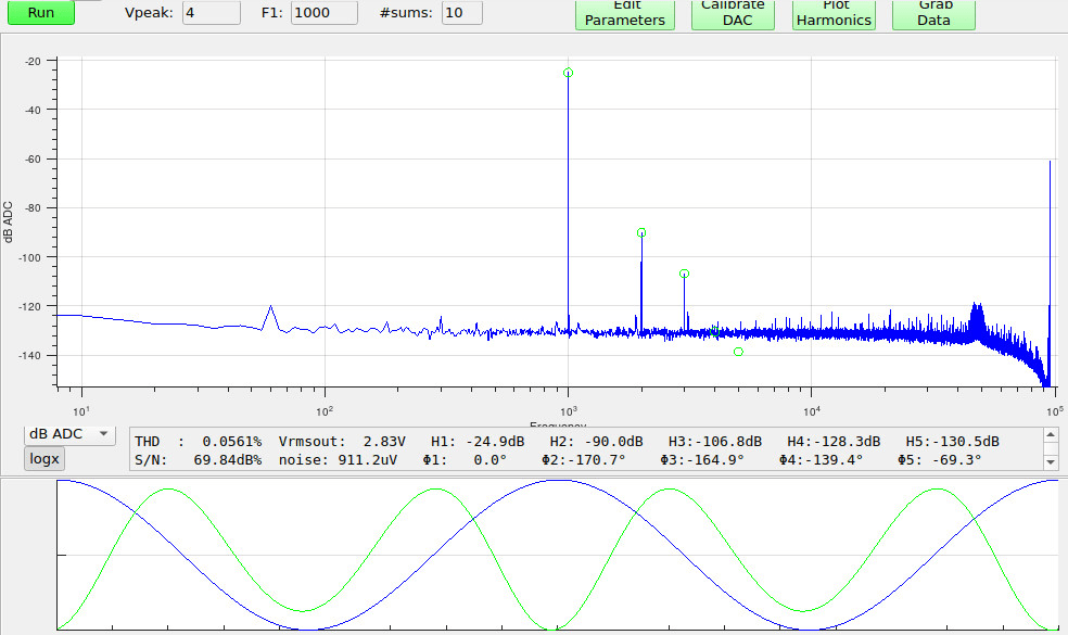

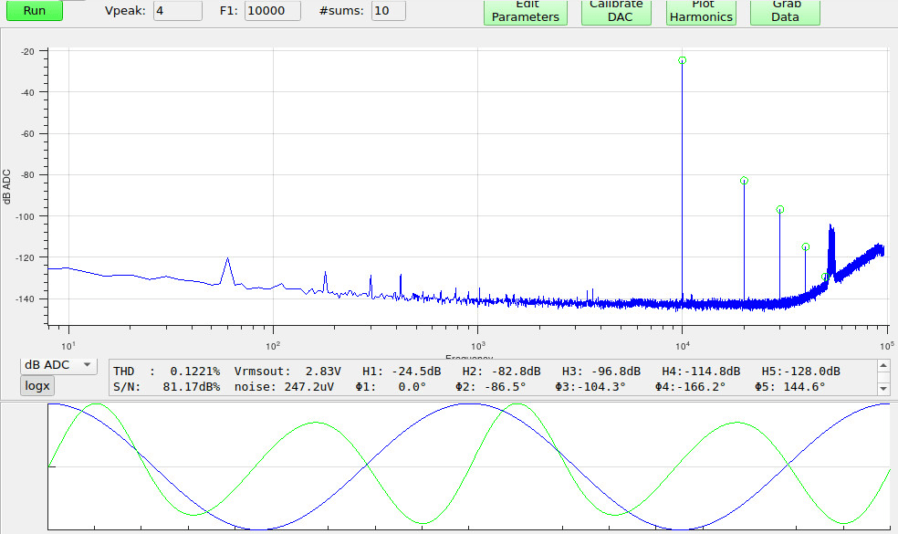

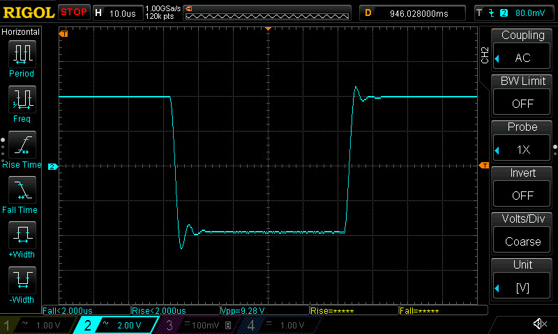

Here are some F5m measurements using the IRF FETs since I do not have any of the Harris FETs.
Spectrum 10kHz 1Watt 8R (4V peak)
Spectrum 10kHz 2Watt 4R (4V peak)
Spectrum 1kHz 1Watt 8R (4V peak)
Spectrum 1kHz 2Watt 4R (4V peak)
Square wave response 4V peak 10kHz 8R
Square wave response 4V peak 10kHz 8R || 100nF

So it appears that distortion is quite a bit higher at 10kHz.
Slew rate is about 3.5V/us.
And a little bit of ringing with reactive load.
Patrick
Patrick
