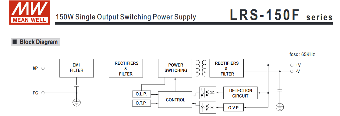

A question for the SMPS experts: how can I check from the datasheet of a p.s. whether the V out pin is connected to safety earth (that would prevent putting two ps in series for a +/- supply)

All Mean Well supplies are fully isolated from ground.
Hi
at the last page in the datasheet you see that.
the cap.

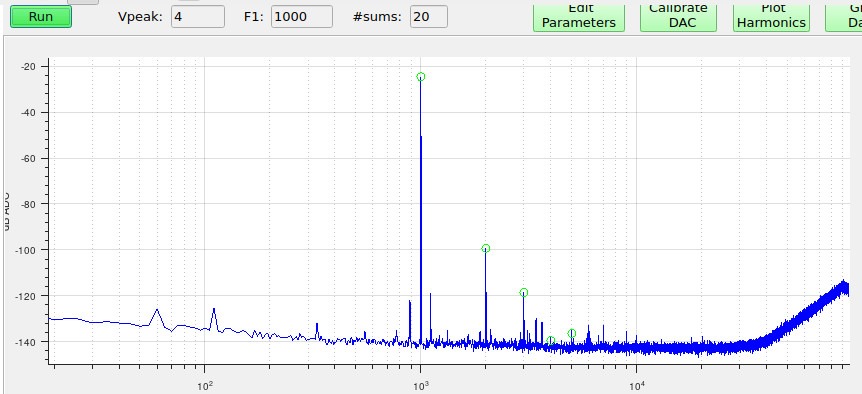

I recently acquired a pair of Mean Well LRS-150F switching power supplies, which is adequate to power two stereo F5m channels at 24V 1.3A.
I was interested in determining the noise level from 60Hz harmonics and the SMPS switching frequencies and what steps could reduce that noise.
My measurements were performed by custom spectrum analyzer software using M-Audio Audiophile AP192 (192kHz, 24-bit, balanced I/O) sound card. Carefully utilizing the balanced I/O, the measurement system has a noise floor down around a few microvolts.
Here are the primary results from my measurements and experiments:
All of the spectra shown below are for 1kHz, 1 Watt into 8 Ohms output.
The first image shows the spectrum before attention was given to the SMPS wiring to the F5m PCBs. In absolute terms, the noise level is that bad.

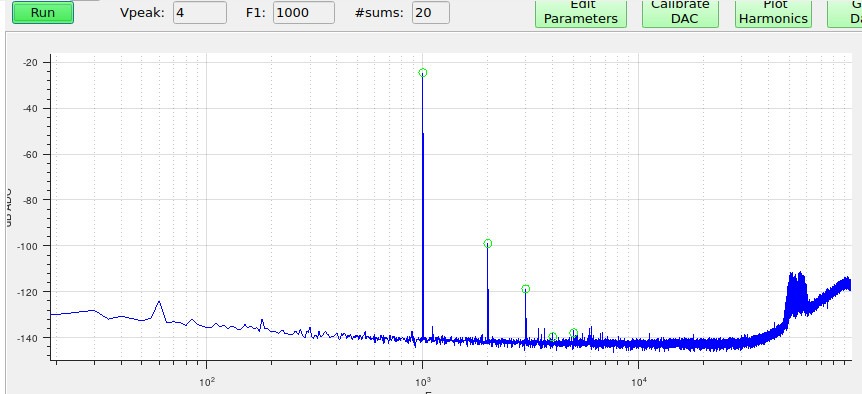

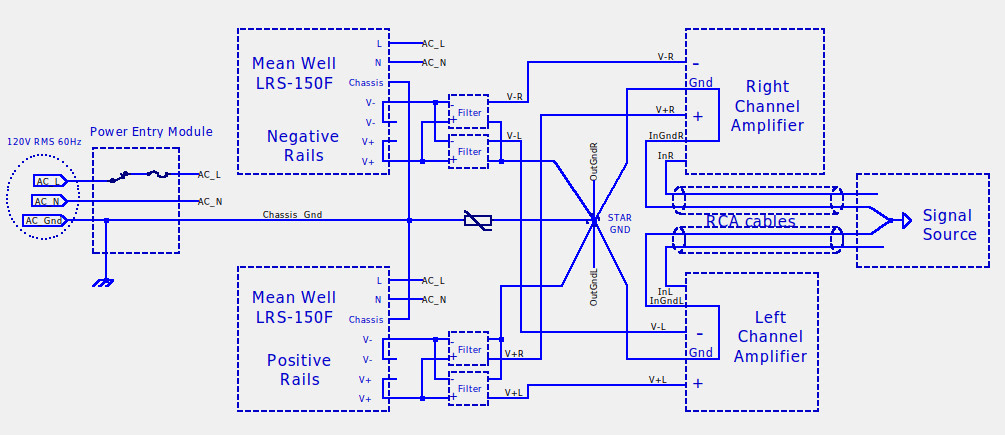

By careful implementation of the star ground topology shown in the second image, the noise levels were well below 100uV rms.

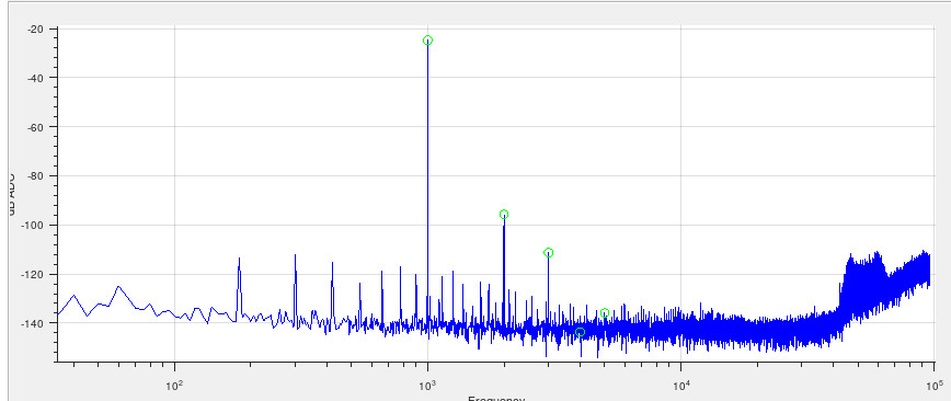

The third image shows the spectrum with both channels driven.

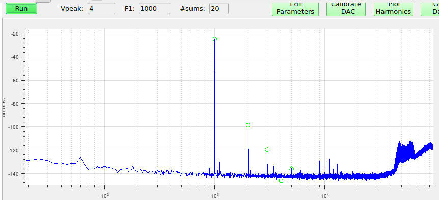

The fourth image shows the output spectrum with the other channel input grounded and its input ground floating, thus breaking any input ground loop. Little is changed, indicating that the star grounding implementation is working well.
Finally, the fifth image shows the output spectrum with both channels driven, and the power to the channel +24V/-24V rail filtered using DIYAudio Store SMPS filters. The noise in the 40kHz to 60kHz region has been eliminated, but there are more 60Hz related harmonics than before.
Bottom line: These Mean Well supplies should present no significant noise issues, particularly when good grounding practices are used.

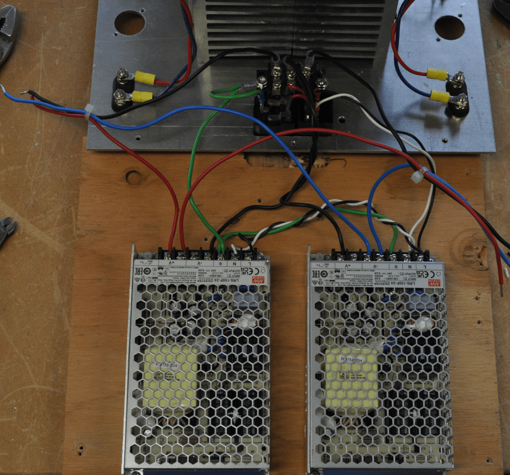

The Mean Well LRS-150F supplies, the star ground, and the wiring.
In the upper center is a barrier connector block used for the star ground.
Immediate below is the power entry module.

Hi
On your post 78, the first picture shows a black wire joining the 2 power supplies, sort of the center tape but I don’t see this in your detailed ground schematic (post 77, 2nd pic)
I see that both supply have their ground connected to chassis gnd 👍

This is a really good illustration of the importance of a proper grounding scheme.

In post 78 there are two black wires (grounds) twisted together from each SMPS connected to the star ground.
