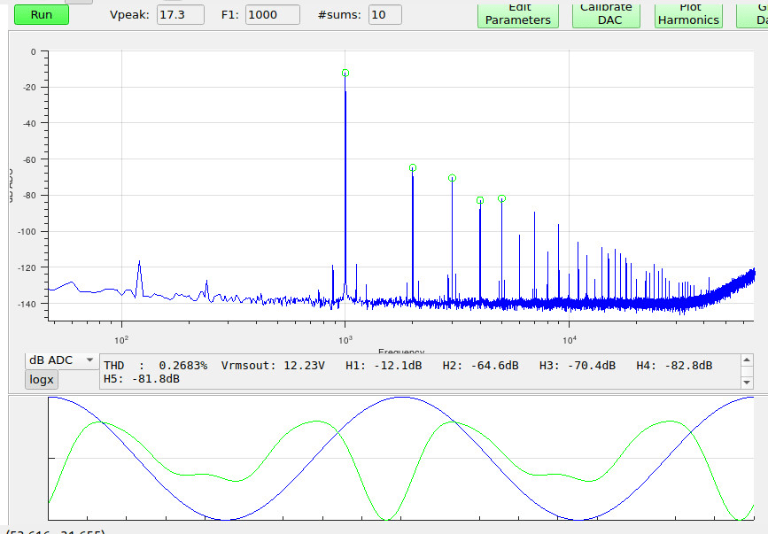

Shown below are the left and right channel distortion spectra at 1kHz, 1W, 8R load.
How should I read your FFT plot ?
Fundamental is at -25dB.
So when normalised to the 1kHz fundamental, H2 is at -75dBr, and H3 at -85dBr.
Is that correct ?

My FFT plot was normalized to absolute ADC levels. The fundamental at -25dB corresponds to 2.82Vrms output followed by a 10:1 attenuator.How should I read your FFT plot ?

The large H2 is not particularly noticeable.

how F5m can have mostly H2 (@lower power level) when it is a scaled version of F5 that has mostly H3?
Different MOSFETs used in the original F5.

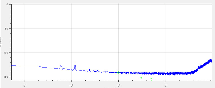

I performed some more noise measurements to compare the switching PS noise to that of the linear PS.
The first image is from output for the left channel with the linear supply. The noise at 60Hz, 120Hz and 240Hz is visible. The "noise" at the above 35kHz is from the noise shaping of the ADC.
The second image is from output for the right channel with the Mean Well SMPS. The -124dB 60Hz peak is instrumentation noise. The narrow -124dB 4kHz peak is probably from the SMPS.

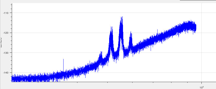

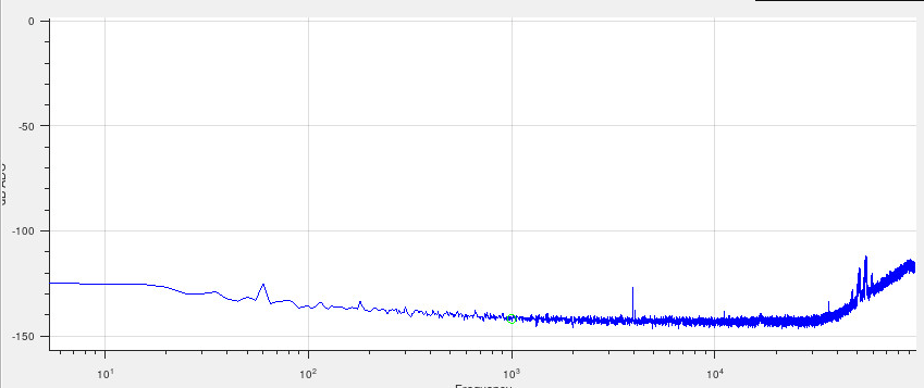

Things get interesting between 50kHz and 60kHz, which is shown in more detail in the third image. There is a main peak at around 55kHhz with sidebands at approximately 55kHz +/- 4kHz.

Any time that SMPS are used there are two sources of noise that may be of concern.
The first is leakage of the AC line frequency and its double; so 60/120 Hz or 50/100 Hz. This can be audible if it is not filtered sufficiently.
The second is the internal oscillator, typically from 50 kHz to 70kHz, depending on the SMPS model. This is generated by the SMPS itself, and is usually not audible by itself unless there is a ‘beat’ frequency with another strong signal that is close in frequency. When a second SMPS is used to create a bipolar power supply, the two units will almost certainly have unequal internal oscillators, and the difference between the two will make a beat frequency. The beat frequency could be anything from 1Hz to 100Hz (very roughly). So this needs to be filtered to keep it from being audible. Other sources of signals that may beat against the internal oscillator are also possible.
PKI: There are two 24V SMPS modules. So there could be a beat frequency.
I do not understand the source for the 4kHz (approx) spike that shows in the 2nd image. It is very stable in frequency, unlike the 55kHz neighborhood.
Why should one worry about noise at these low levels?

That's what I'd hope for. Trading off 120Hz for inaudible ultrasonic noise. Not sure about the 4kHz. It could be an alias. If the supplies and loads are identical, I would agree with Tungsten that any beat should be in the LF, but even with a fixed PWM architecture (and even worse with PFM, pulse-skipping, etc.), maybe unit-to-unit variation with slight load differences could produce beats higher into the audible band.
That noise floor looks pretty great, though! Congrats.
