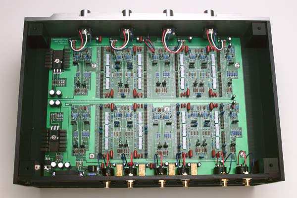

Uli,
I think the best is yet to come, variable everthing I mean.
Ain't ever there been a diy crossover like that now has there.
Except the commercial version of NP.
"It certainly is true that the brighter of our readership can
reverse engineer an XVR1 from the owner's manual, which is
online at www.passlabs.com"
Well now, isn't that a neat and tidy job. That's a real work of Art. What do you think Fred, technically speaking of course?
I think it's beautiful and would be a real conversation piece with any audio buddy who comes over for a listen, assuming you are lucky enough to own an XVR1.
Mr Pass, was that one of the ones you had in your head for a while and did the layout straight from memory? (no disrespect intended).

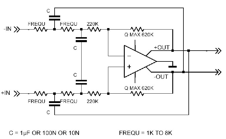

case study
I did a "case study" on X ing a Sallen Key filter.
Frequency resistors should be 1k, 1k25, 1k6, 2k, 2k5, 3k16, 4k,
5k and 6k28 or so
Caps 1µF for 20 - 160 Hz, 100nF for 200 - 1k6 Hz and 10n
for 2k - 16k Hz
The gain device can be used either as input-, output- or
filter buffer as it works with about 27mA bias and is entirely
class A
Uli

Thanks Uli. Have you built this?
Is the Q determined by the ratio of the Q resistor? and the 220K input resistors the same way as for a conventional single ended Sallen-Key filter? (tring to combine what you have posted with Grey's info to compensate for a rising response tweeter.)

no its not built yet.
BTW there is a mistake in the gainstage:
those 560R resistors should be 680.
the Q resistor stems from the formula:220k x (3 - 1/Q)
I chose 220k as high as practical possible to not
interfere with the filter components since its the input
resistance.
I try to do a universal pcb where you can build a 24dB
2 way stereo xover with 4 identical pcb´s.
Uli
PS: the filter parts are to be calculated according
to the formulas for Sallen Key with equal components

Uli,
your Q formula works out to be a little different than Grey's
Solving for Q I get Q=1/(3-(Rq/Rinput)).
Note - Grey has different nomenclature, what he calls Rfeedback you call Rq)
in the case where both resistors are equal, Grey's formula gives a Q of 1, yours .5. Is this because the input resistors are effectively in series? could you point me to a reference so I could try to understand how the formula is developed in the balanced case?

difference
Not yet having read Grey´s article I think he refers to
non inverting amplification.
In fact is the gain of the gainstage 3 - 1/Q which leads
to 2 - 1/Q for the resistor from out to -in in non inverting
amlifiers when the other one is 1.
The case with inverting amps is a little bit different.
As the gain is 3 -1/Q the resistor is 3-1/Q!

I don't have a sim either, but it seems like using crossovers in balanced circuits compounds both sides for steeper slopes. So, using 6db on each side, provides total of 12 db in a circuit. At least that's what I observed last time (a HP filter at the input of Aleph X)
Your active stage looks very appealing.
