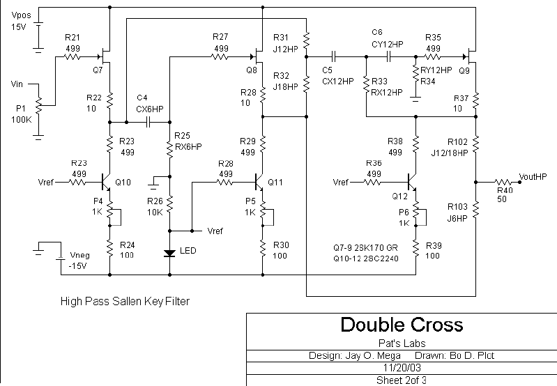

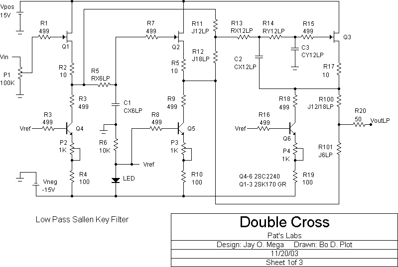

Pass Diy High Low Pass Please
I recall this popping up somewhere as yet untried.

You are kidding right? I provided some links for people that might like to see how to calculate the cut off frequency and determine the Q of a circuit. Read the Borbely article and the Pass labs manual and you will be pretty well armed to go build a filter with some good op amps (or even discreet op amps) or even with followers like the design JAM dug up by Mr. Mega ( I will have to ask him were he found that....) that could be done with tubes, BJTs, op amps, or mosfets.

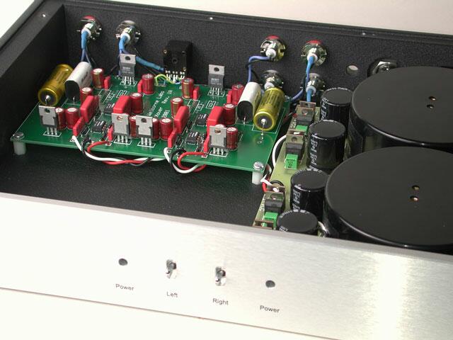

mosfets?........
jam said:
J-fet's could be replaced with mosfets if you are so inclined and there are ways to improve the current sources...........:nod:
Damn I was thinking the current sources could be replaced by mosfets........ I built one with all Zetex mosfets but I can't find a picture. Heres one of the Welborn Labs crossover.

Every EE with experience can put together a crossover. (Looks nice Jam :) ) We could even go and buy one. But what if people are interested in Grey’s design? Can’t you just give him the time he needs to post it? I think Nelson promised long before Grey to post a crossover. You never pushed him.
