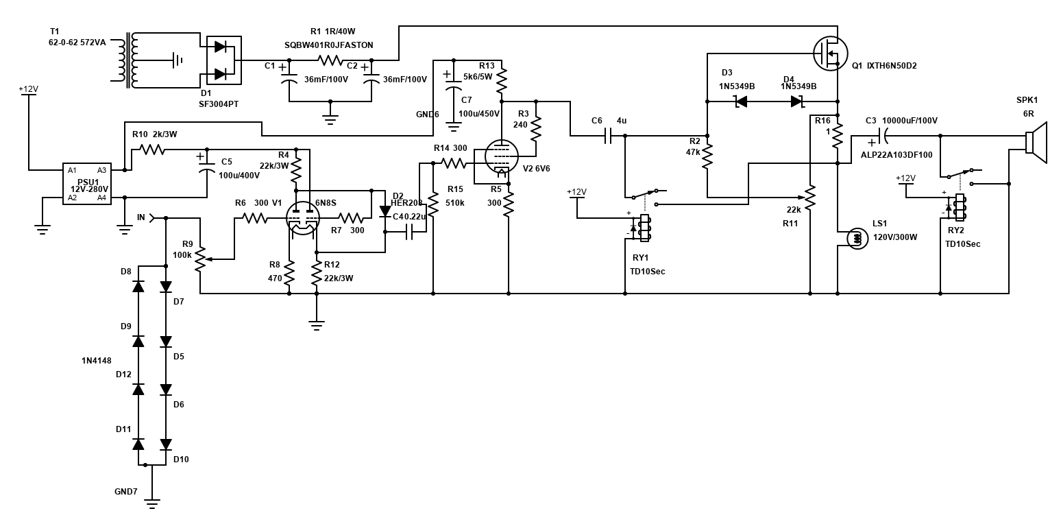

EDIT: I've now tried 500W bulbs instead of the 300W and it seems to have increased the output (light AND sound)!

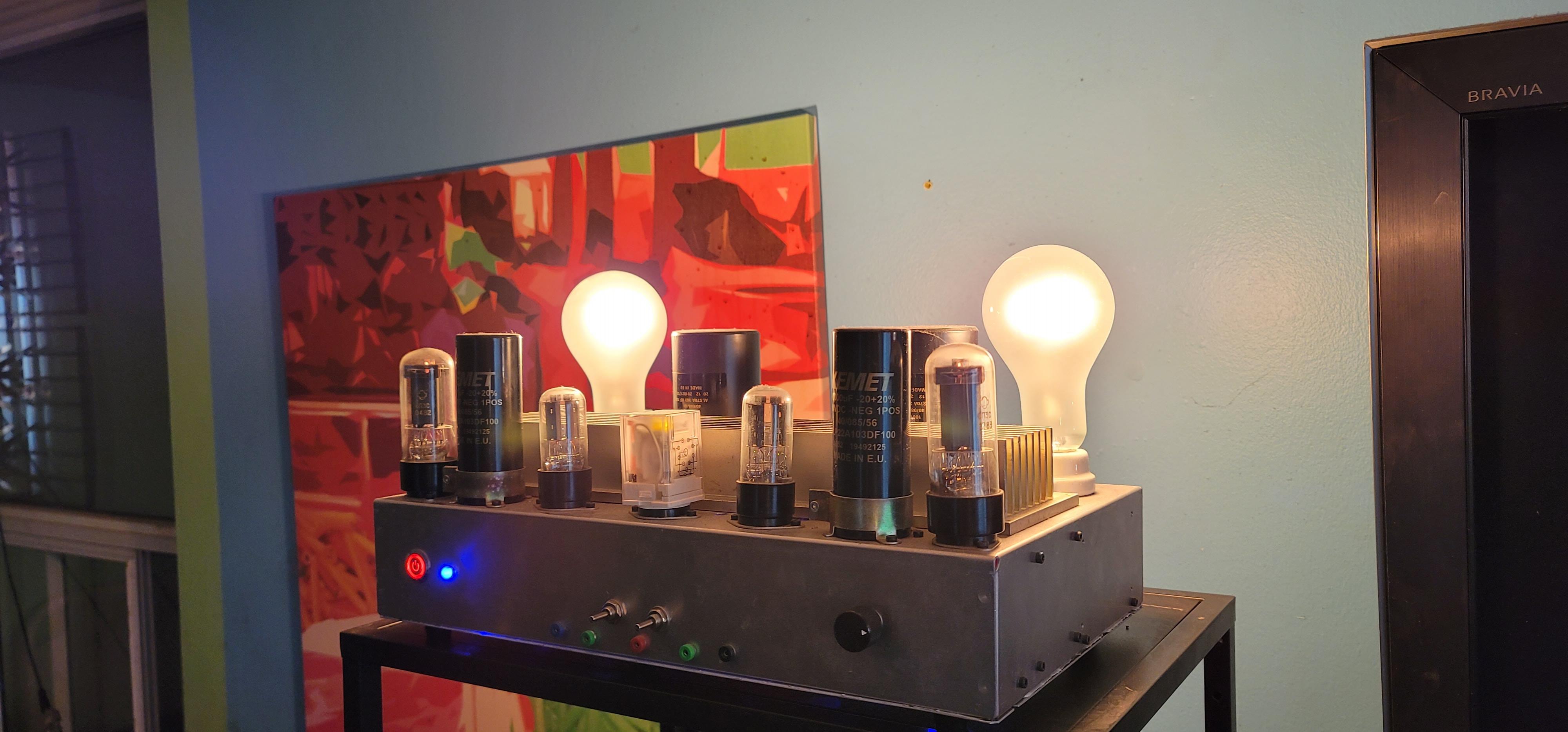

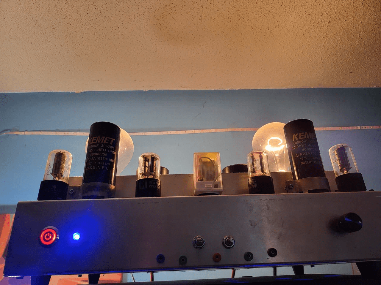

Another update in case anyone is interested... with 300W bulbs and the MOSFETs biased for 27V across them, the heatsink is 65c...
With the 500W bulbs in place but the same 27V across the MOSFETs, the heatsink is 80c! When it blows up, I'll know why LOL

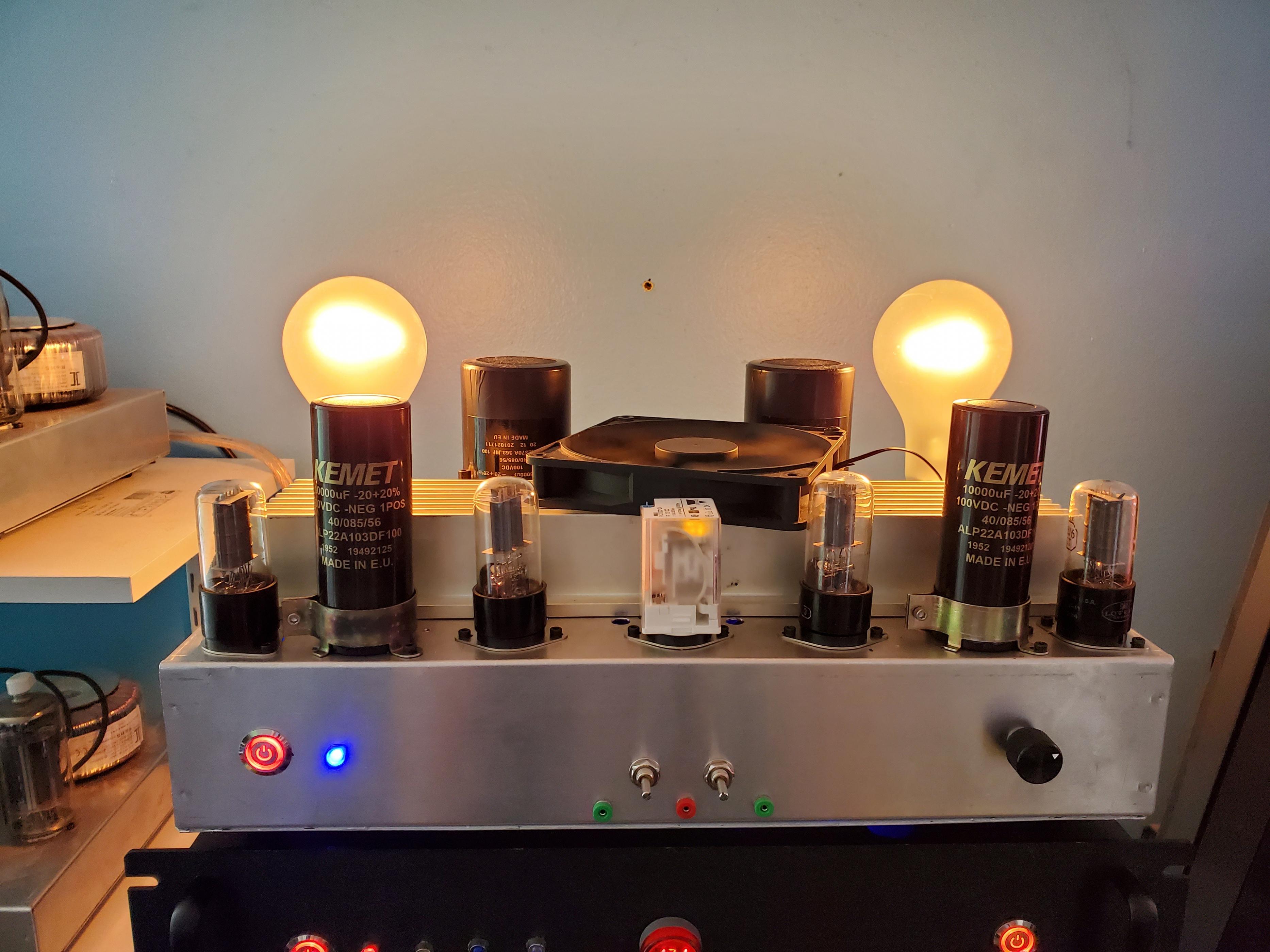

One more followup I Guess...
I've added a fan. Using the 500W bulbs now.
I know it's come a LONG way from the simple de-lite that Mr Pass came up with, but his goal was to get people to DIY. I've been doing that for years with tubes, but never solid state. It's always basically been witchcraft to me how they work, and they aren't nearly as robust as a tube save for throwing it on the floor, but Nelson's original amp made me finally tinker with transistors.
It's really amazing how much better it sounds as a source follower though! My next amp idea will probably be a push pull source follower using output transformers! Let's see how these things work and if I can make 50W using 150V B+ for the output MOSFETs (which will be these same IXTH6N50D2 I think without blowing too many parts up. My only hinderance is how expensive "thermal management" is compared to tubes! I could build an entire tube amp for the cost of a big chassis with big heatsinks! When this covid thing is dying down, I'll check my surplus spots again.
Oh ya, it takes 400W from the wall, too!"

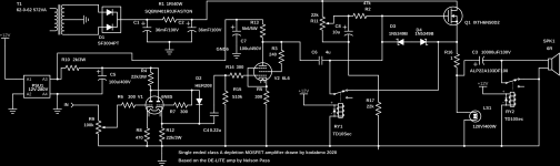

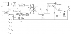

Ok, as Nelson suggested, I've modified the bias arrangement.
It seems more stable now since the bias isn't tied across the output.
Thoughts?
