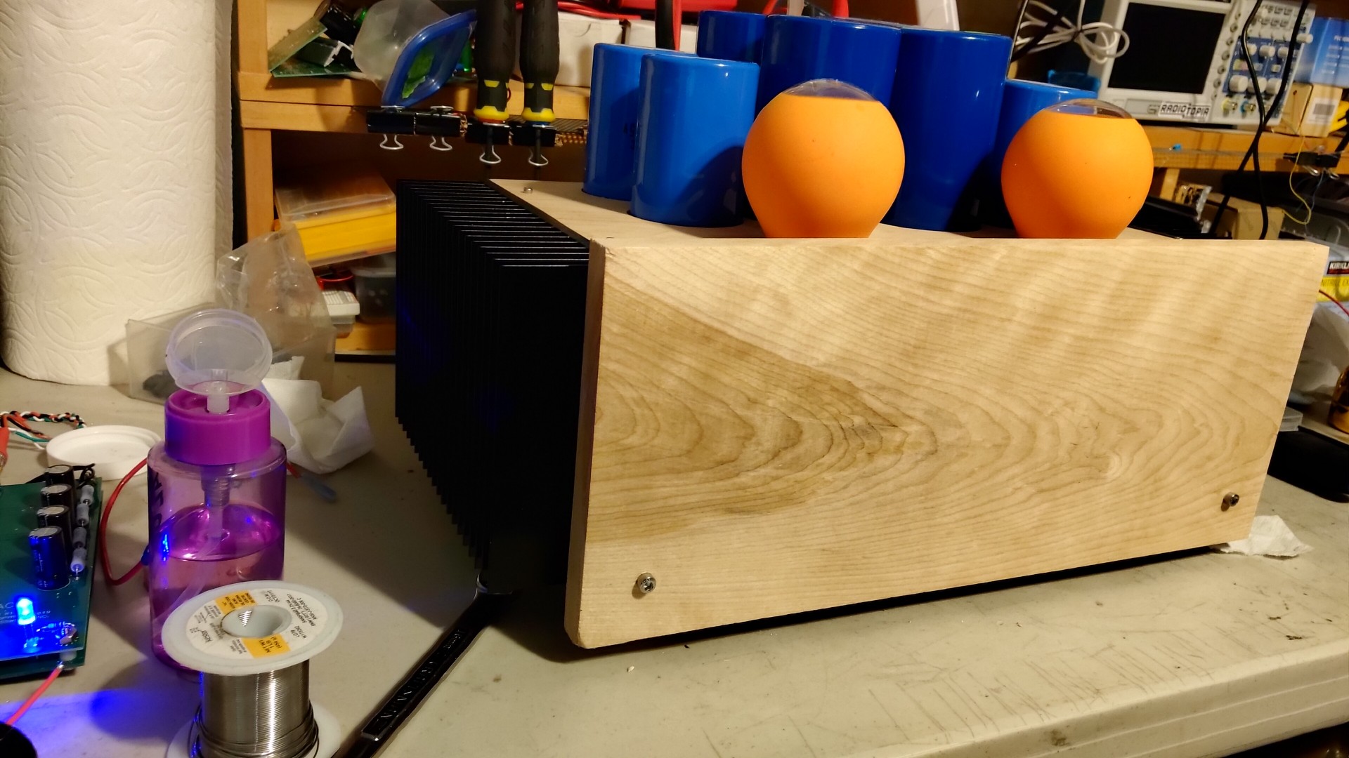

Here's a picture of the amp with the bulbs rigged to sit there while I wait for the sockets and the power button to fill that hole...

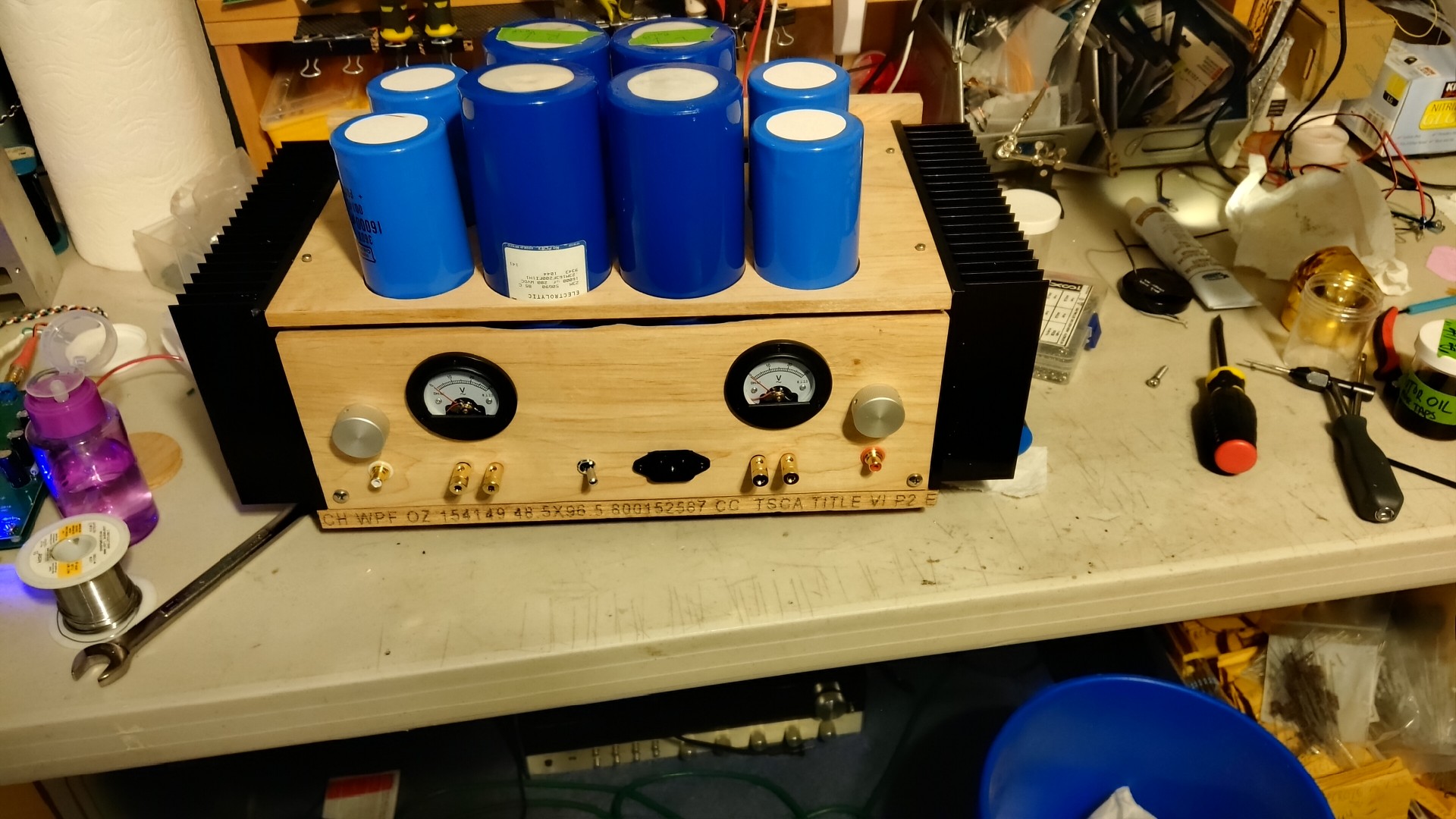

I love my De-Lite so much I decided to fashion a proper chassis for it so that it may reside in the living room with the wifey, teenage girls, and the dogs. Many hours were spent as my carpentry is rusty at best. When I turned it on beautiful music sprang forth but there it was...Humm! A buzz I just can't ignore. And this buzz was not present in my first super sloppy build. I now get why so many go on about the importance of topography. Trying to cram these giant capacitors, a giant transformer, and mosfets that will amplify signal noise into this small of a space is just a disaster. There's no room for clean wiring the AC and DC are way too close together and it was such a struggle to tighten each screw. PITA!
So back to the drawing board with more space.
As a side note I also learned its best to read the description when buying parts. AC & DC panel voltmeters are not the same.

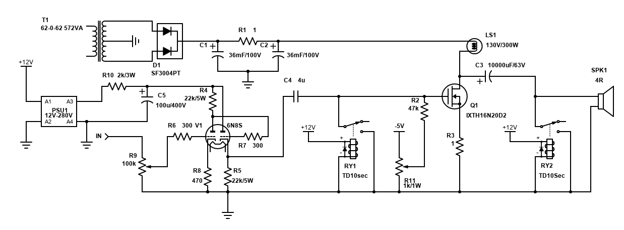

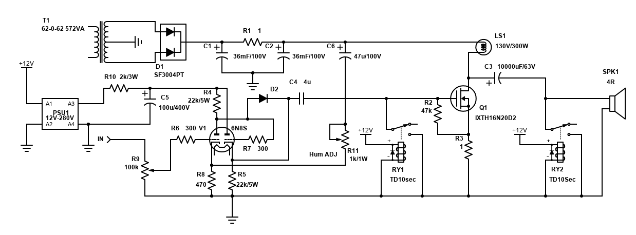

I am expecting hum since it's SE and unregulated, but I've added what I think will be a Hum adjustment. What do you think? I feel like it's a blend of Aikido and Janus. 1k might be off for the pot but I won't know until it's alive.
I also added a safety diode for the tube.

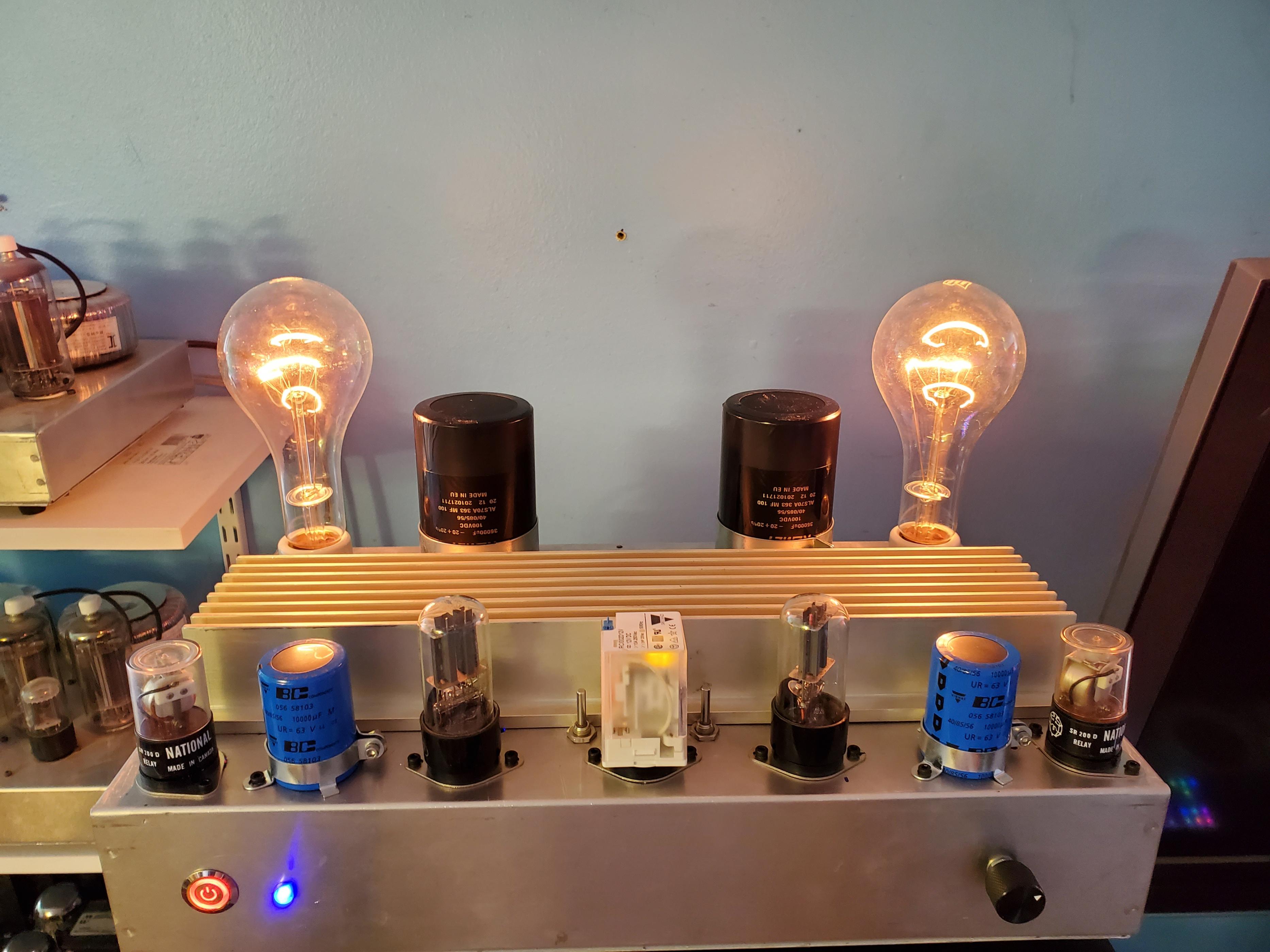

Ok. After realizing I was using different MOSFETs, I rigged up a bias control. I also ordered 500W light bulbs.
But I'm listening to feedback free single ended MOSFETs and I'm in disbelief that these are this linear without help!
Not sure how hot I want the heat sink to get but it's already in the 65c area...
There's a 6 in 4 out speaker switch etc there
