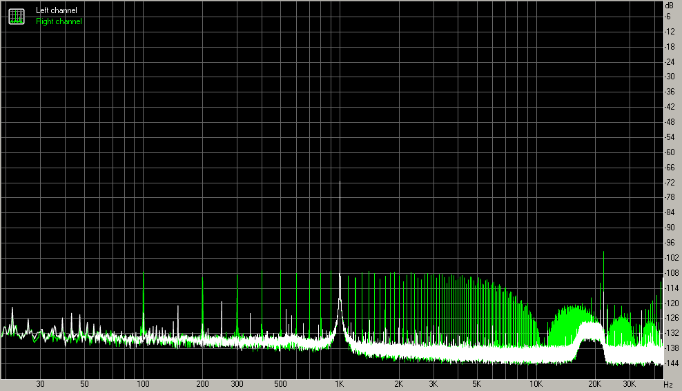

Prompted by the discussion of fake PCM63's I've made an attempt to analyse the output of the D1V3 by recording the output into a digital recorder and then checking the files on computer. Obviously this introduces a whole lot of variables including the ADC chip in the recorder and impedance matching etc so it's not really accurate.
What I did find was that the noise floor in the right channel was significantly higher than the left. This was cured by wrapping the ac supply lines to the digital section in adhesive copper tape and covering with heat shrink. I'm still seeing a spike at 50hz and spikes at 100hz and multiples there of extending out to 22khz. I'll change out the kimber kable wiring to the output jacks for shielded mic cable and see if this helps. The other possibility is that this rectifier related noise could be originating from eBay-ed OSCONs I installed in the transport PSU recently.
Another minor issue had been that attempting to set "point B" on right negative to zero volts was non-linear and extremely twitchy. After checking the current and voltages at various points in the JFET I/V against figures supplied by Spencer the problem was narrowed down to a faulty 5K trimpot. Replacing the trimpot resulted in same zeroing behavior as for the 3 other I/V sections.

I've rewired the DAC supplies so they feed from the regulated 18V I/V supplies and I think this makes an improvement in terms of detail.
I'm still getting psu noise on the right channel. The only thing I can think might be causing this is that there is a 10R or 12R resistor in the PSU CRC for the right analog supply. The original was toasted when I installed the Dead-on-arrival PCM63P-Y, and I replaced with the nearest value I had on hand. This would mean perhaps 2-3mv extra ripple according to Duncan's PSU simulator. Perhaps this is enough to make the difference??
I'd been having issues with the test tone cd I'd made. I was getting noise spikes 20dB down from the -70dB test tone. I remade the test track with MBIT+ dithering and this really cleaned up the DAC output. Obviously the spikes were related to quantization noise.
PSU noise is currently about -106dB down in the right channel. Left is significantly better and I'm hoping to get the noise in the right down to similar levels. Obviously the PSU noise isn't audible at this level but I'd much prefer to have both channels clean down to the noise floor.
note: the "bump" in the noise floor near 20khz is the part of MBIT+ dither. I'm recording the DAC output into a Tascam HDP2 running at 24bit/88khz sampling rate then analyzing the file using RMAA 6.0.4.
Scratch the rambling about the CRC resistor above. After thinking about it this is on the negative supply and would effect both channels equally.
Looking a the pdf of the board layout, I noticed that the digital supply rectifiers are really quite close (under 10mm) to supply decoupling caps for one of the right channel DACs. This seems to be something that needs to be investigated more closely as some kind of shielding could be required.
I've also noticed that the -12V supply is now unused since rewiring DAC regs to 18V supplies. Looking at the board layout it seems like minor surgery is required to reconfigure as a +12V supply. This is ideally located to be used as a dedicated clock supply.

I've tried applying copper tape to C177 (see attachment to previous post) and the top of the adjacent DAC and this seems to have substantially reduced the rectifier noise on the right channel. I'm not sure if this is a problem with the diodes Spencer supplies but if you are using TO220 schottky's I'd highly recommend applying some kind of shielding. It's probably worth doing anyway given the proximity of the DAC to the rectifiers.
ha!!
tracked down the rectifier noise to a cordless phone near to where I was placing the recorder I was using to capture the D1V3 output. Power off the phone base station - noise pretty much disappears from the recording. 🙄
Shielding on the cap and dac chip were probably unnecessary.
