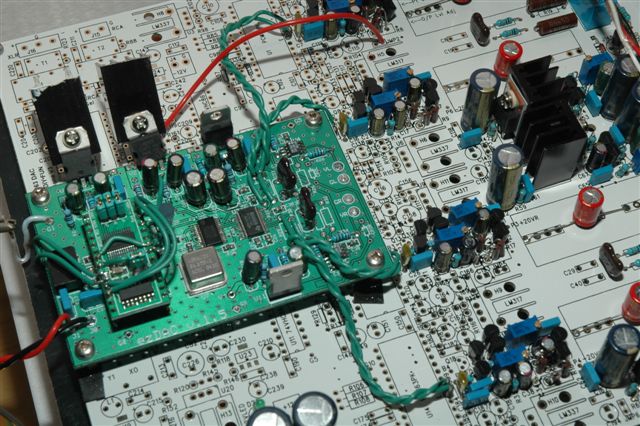

Hello Paul,
This device REG104GA-5 or REG104FA-5 looks very good. But again different pinout, and worst still a 5-pin device. 🙁 🙁 🙁

Hi Spencer,
I've been meaning to ask what you felt the advantages of the JFET I/V was over MOSFET. I noticed you have built both versions so thought you might have some ideas.
I've read something recently that suggests in the D1 I/V converter the input resistance/transconductance of the transistors is the most important factor and that the original MOSFETs may actually be better in this situation than using J/FETs.

Paul,
It is base on listen preference and I like the Jfet IV more. I get more life in the music if I use Jfet. The transconductance of K170 is 20mS and thus the input impedance is about 1/20ms = 50 ohm. If you parallel two K170, you get a bit lower input impedance but I prefer the sound of single K170. Of course you can use other Jfet or parallel more. Moreover you can bias the K170 at different current and select your sonic preference.

Mo' Zener Fun
I've also redone the DAC 317/337 zener mod with 3V 0.4W zeners and 1N4148. The 1W zeners I used originally were massively over rated and the paired 0.4W zeners fit far better, taking barely any more room than the resistors they replace. Supplies are now sitting close to 4.9V so there is a little more safety margin than the previous worst case 5.45V.
I clearly wasn't paying attention, as I didn't realise the 12V supply is smoothed but not regulated. I was wondering what was wrong when I stuck a probe on the +12 and saw the ripple.
I'm tempted to rewire so the DAC regs are powered from the 18V analog supply.
Even with the current setup the zener modded DAC regulators have improved detail. The addition of on the zeners to the analog have made another small improvement to detail. I'm sure adding a 10uF bypass from adj to gnd on the 3*7's will clean the supplies up a bit more so that is the obvious next step.

Housing,
Look closer at that spec for output noise: it is 10uV/V*Vout so actually 50uV for 5V output. RR is 65dB.
7805 still looks better on paper. 40uV output noise and 80dB (typ.)/62dB (min) RR... 😀

Take note on the following points:
1. Lower noise is always better. I use two steps series regulators for both digital and analogy supply. But the digital part generates too much noises from each chip. The noise source is from the chip, not mainly from the transformer.
2. Changing to different regulator (series, shunt, part number, different manufacturer etc) chip will also change the sonic. Note that the output impedance, CMRR, noise spectrum, speed etc of different regulators will be always different (LT, LM, 78/79 series). Experiment and choose the one that suit your sonic taste. I think Pass always use a simple series non feedback regualtor will be his preference of the type of sonic from this kind of regulator.
3. In my D1V3 board, I did not put the decouple cap at the 317/337 ground resistors due to lack of space, you can always solder one at the bottom of the pcb as you like.
Enjoy tweaking!
