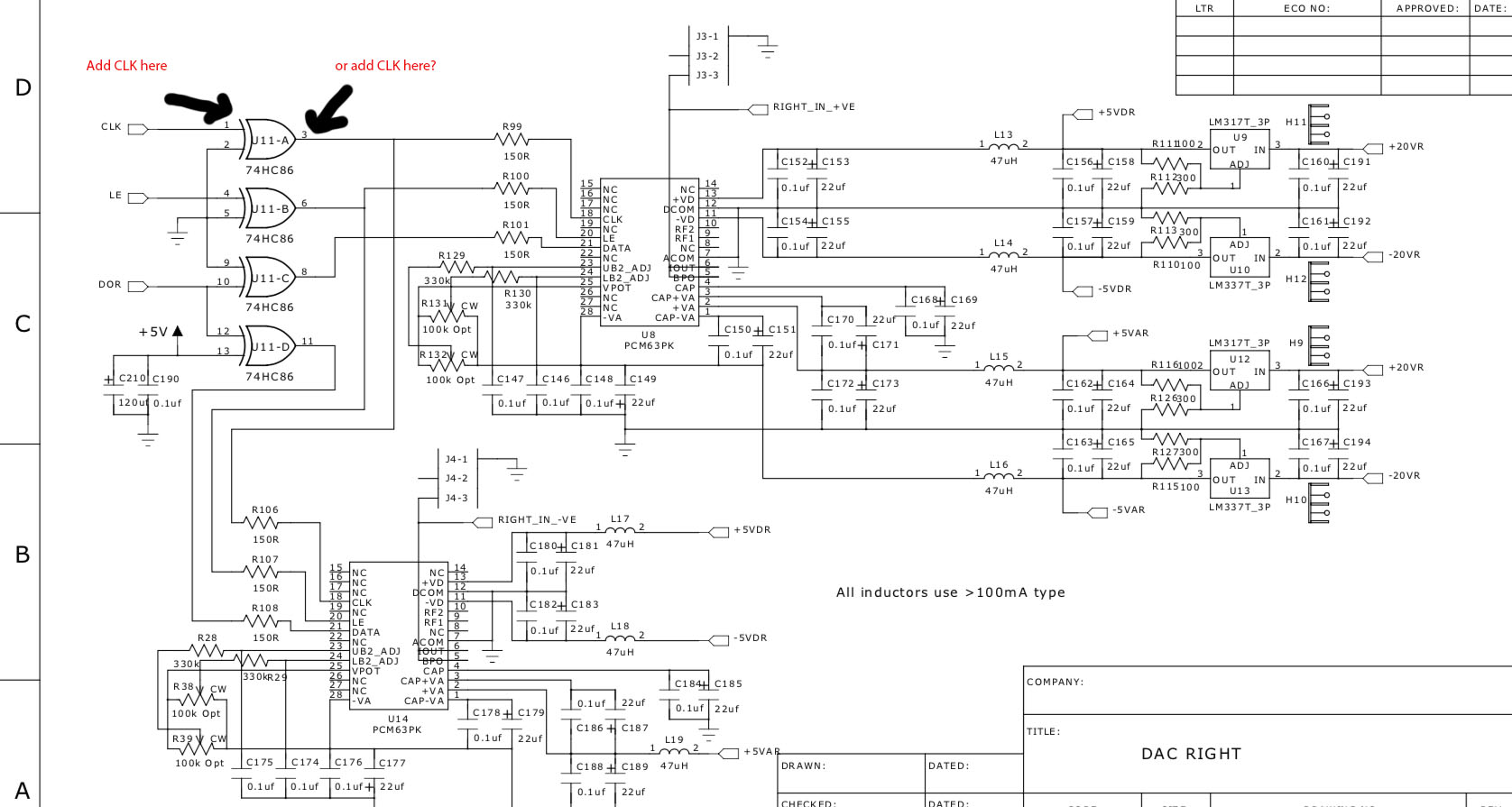

So going back to Ben Mahs post above, the idea is to use the i2soverusb board which is configurable to output CLK, LE and Data L/R to the PCM63. As he mentioned, the i2soverusb output can be sent to U4 and U11. But when I do this, I get some background noise only. I have been connecting these lines on the inputs to U4/11 - should I be connecting them to the outputs instead? I've added the schematic here with arrows to show what I mean.....
Apologies in advance for what is probably an elementary question.

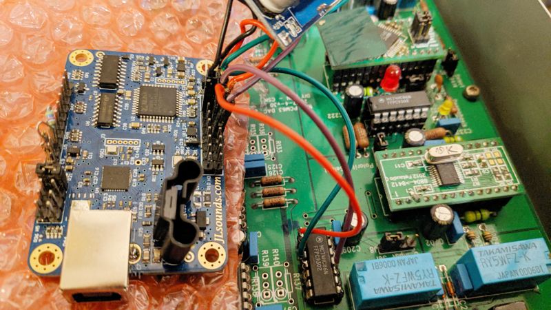

Photo attached of connections to U4, U11 is the exact same. GND point goes to ground point in the receiver section out of shot.
In the later revision (my first mistake) the inputs on U4 and U11 are different, but on this version they are the same on both.
Looking at the schematics in 63v3_3.pdf, U11 is right channel. Left channel is not shown but I assume the equivalent is U4 from what you have written.
According to the schematics, for right channel, D0R (H3.9) goes to pin 10 of U11, and D0L (H3.13) should go to pin 10 of U4.
LE (H3.15) should go to pin 2 of U11 and U4.
CLK (H3.11) should go to pin 5 of U11 and U4.
According to JLSounds instructions, for PCM63, J4 and B5 should be closed. Edit: Not sure now about B5 re: on-board or external oscillators. If everything is connected correctly and still doesn't work, try B5 closed.
Also remove SM5847 as rfbrw suggested.
According to the schematics your DAC is balanced so there are two PCM63 per channel, and U11 feeds the right channel, and U4 feeds the left channel.
