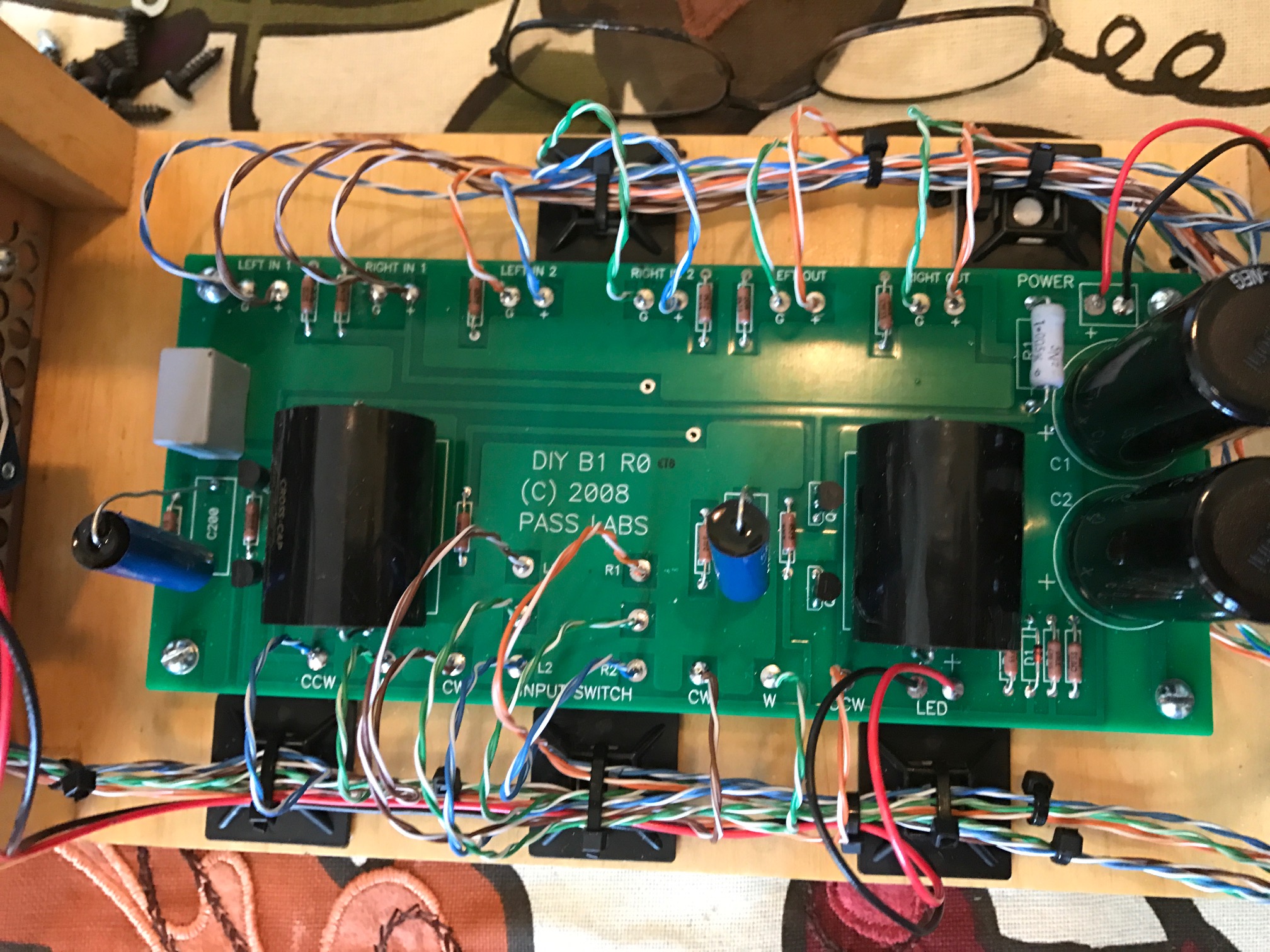

Hi all newbie to this site and diy audio. I have just completed a Pass B1, it powers up and plays, but that is where I get my problem. The left channel plays louder than the right and the left speaker is moving more than it should. Any ideas where I should look?

Probably best if you take a copy of the schematic and mark it up with all
the DC voltages at component leads.

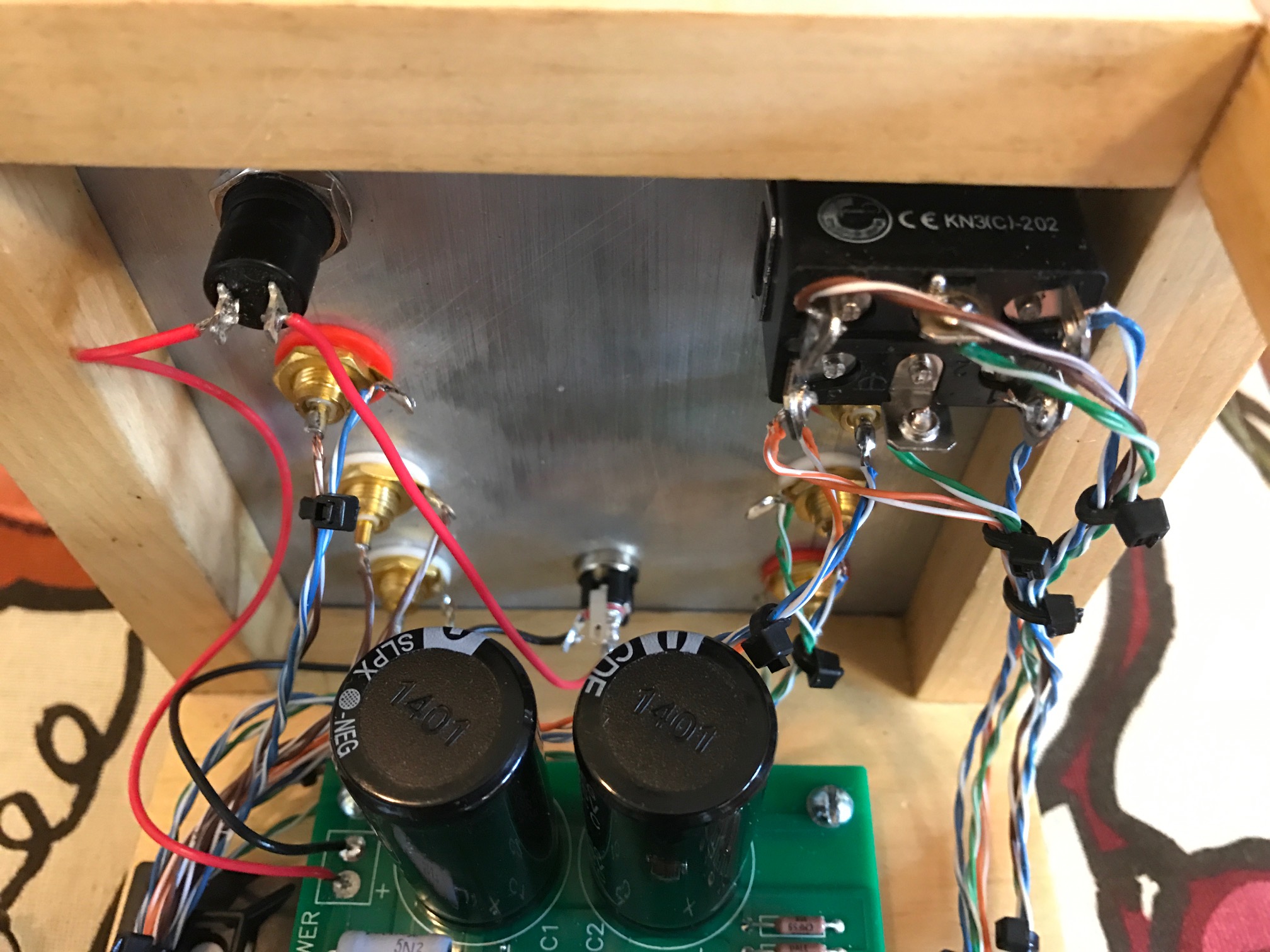

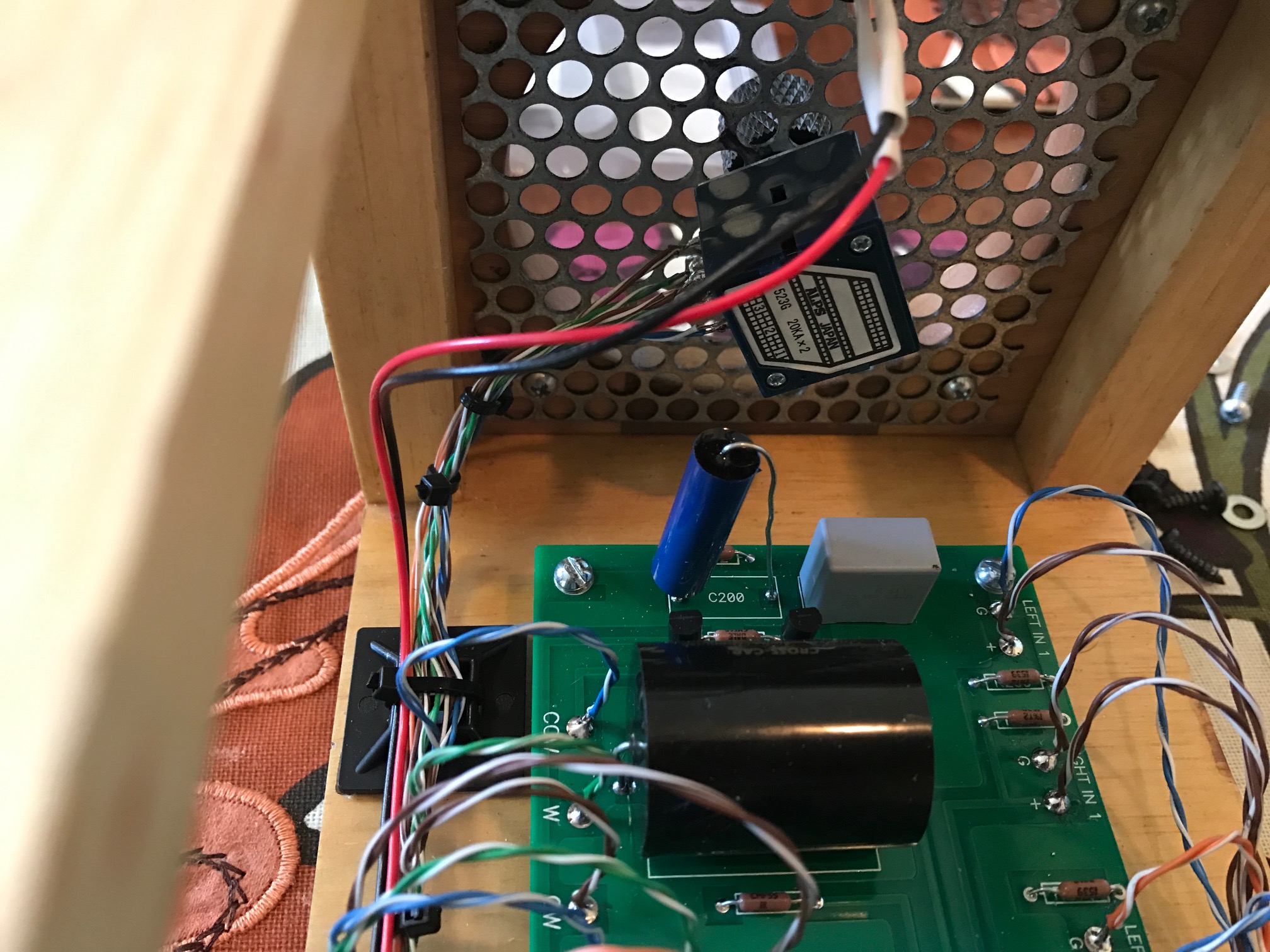

I see lots of twisted wires.
But for each the two wires are soldered onto one pad.
A twisted pair is one wire of the pair to carry the signal to the next stage and the other wire of the pair to bring the signal back to the Source. We call them Signal Hot and Signal Cold or Flow and Return.
Every circuit REQUIRES the current to RETURN to the Source. There are no exceptions to this rule.
Use your twisted pair as Flow and Return for each signal connection.
eg.
at an input RCA/Phono socket you have the Hot pin at the middle and the Cold tag at the side.
You solder one wire of the twisted pair to the Hot Pin and solder the other wire of the pair to the Cold tag.
Run this twisted pair to the next stage. The Hot wire goes to Signal Input pad and the Cold wire goes to the adjacent Signal Return pad (often mislabelled as ground, or GND). This is one signal connection using a twisted pair.

All the values were taken before the short occurred. Maybe I should explain. Built B1, B1 functioned for about 1 minute, speakers made a loud noise, like plugging in a guitar to a live amp, shut off amp, turned on amp, same noise, replaced 24vdc wall wart with 19vdc wall wart from amp camp amp, made music again, but with the speaker problem, did component check, finished, but puff of smoke rechecking q200 value.

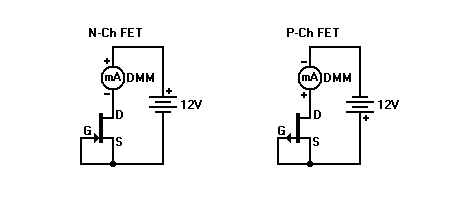

I'm pretty visual kind of guy , so schematic with voltage values (as many you can) , all ref. to gnd - will help much more than sheet you posted
however - drill is simple :
triple check all wiring , especially polarities ;
pull out all semiconductors ( yeah , plenty ..... ) and test them with simple matching jig
