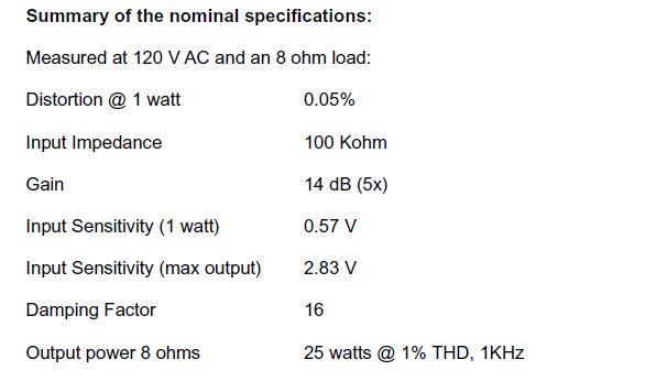

Is the output from your CDP 2 v rms or 2 v p-p or 2 v 'peak' ? It's not at all clear to me what sort of 'volts' are in the specs. Nelson Pass said (above) that he uses rms volts unless otherwise specified.
I think that CDP's output level is supposed to be the same as the 'standard' from tape decks and tuners?
Is there a standard output level from DACs?
What's the output level from an iPod supposed to be?
What about your CDP ? Aren't digital sources supposed to max out at 2V rms?

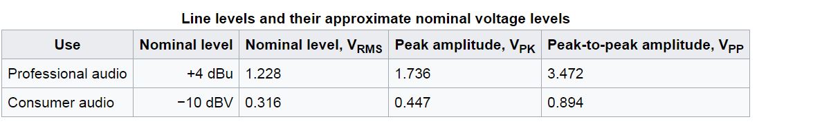

OK- I did a bit more reading.
One source:
https://en.wikipedia.org/wiki/Line_level#Nominal_levels
The standard reference voltage for line levels is 1 V RMS, set at 0 dB V.
Consumer audio products have a nominal line level of - 10dBV or 0.316 V RMS equivalent to 0.894 Vp-p
Compare that to the 2.83 V RMS input required to drive the F6 to maximum output. (from the FirstWatt specs)
I use rms volts unless otherwise stated.
Isn't that a difference of 19dB to get the nominal CDP level up to the input required to drive the F6 to maximum output?

so , verdict , regarding thread title , clearly is
Something is wrong with my ideas and builds
An explanation followed......

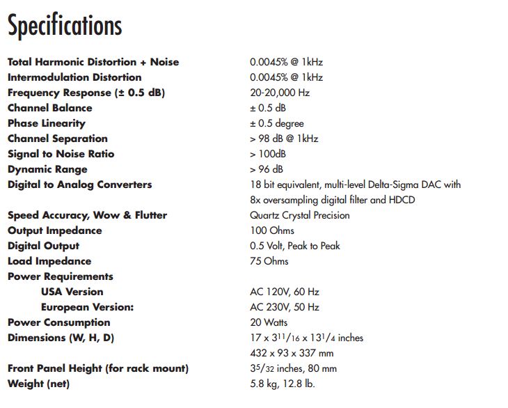

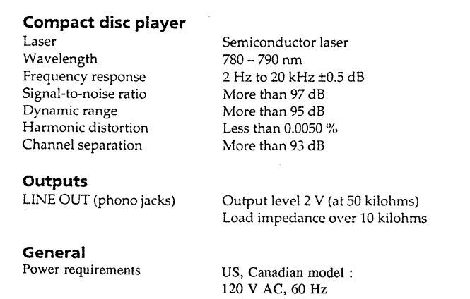

just take a look at few commercial CD players , and see what's usual output voltage figure
sure...please explain the meaning of these..pics attached.
Thanks.
speaking of that - tube amps with under-volt input sensitivity and Gainclones aren't in any way in group of regular power amps
Glad you cleared that up....😀
Thanks.
it's clearly written at second pic - 2V
and serious manufacturers are always stating voltage figures in Vrms
so , if something is fishy when 2V is stated, they simply lied , trying to stay in common industry bracket
however , to cut a story short , avoiding further mixing of apples and oranges - every proper/regular power amp of this world will do better if you have preceding gain stage, with gain of 6-9db

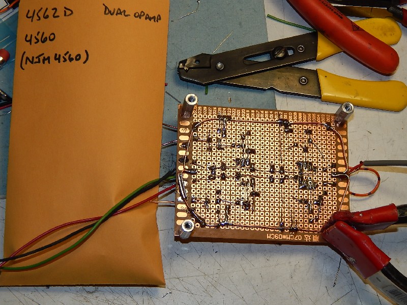

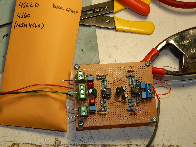

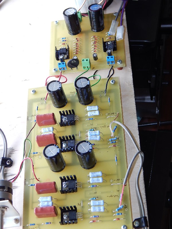

I put together a Rod Elliott IC-based preamp (his Project#88) in a few hours with parts off the shelf here, using perfboard and the info on his website.
High Quality Audio Preamp
9dB gain (once I put in the volume and balance controls). It's around 12dB right now without attenuation between the 2 stages.
I had a bunch of used LM4562 ICs from tearing apart a broken mixer board some years ago..but they are quite cheap anyway.
The perfboard fits right in with the rustic style of my F6 (plain fiberglass board, wired P2P). 😀
I'd recommend buying Rod's PCB for the project- he deserves the support for publishing so much good info on his website. (I ordered Rod's board last night once I had my perfboard version working..)
Next: wire up the other channel of the F6.🙂
And, figure out the best PS for the preamp- it's running on the bench supply now. Either some 7815/7915 regulators off the F6 supply, or a separate PS that I can perhaps find in my 'junk pile' from old CD/DVD/receivers.
