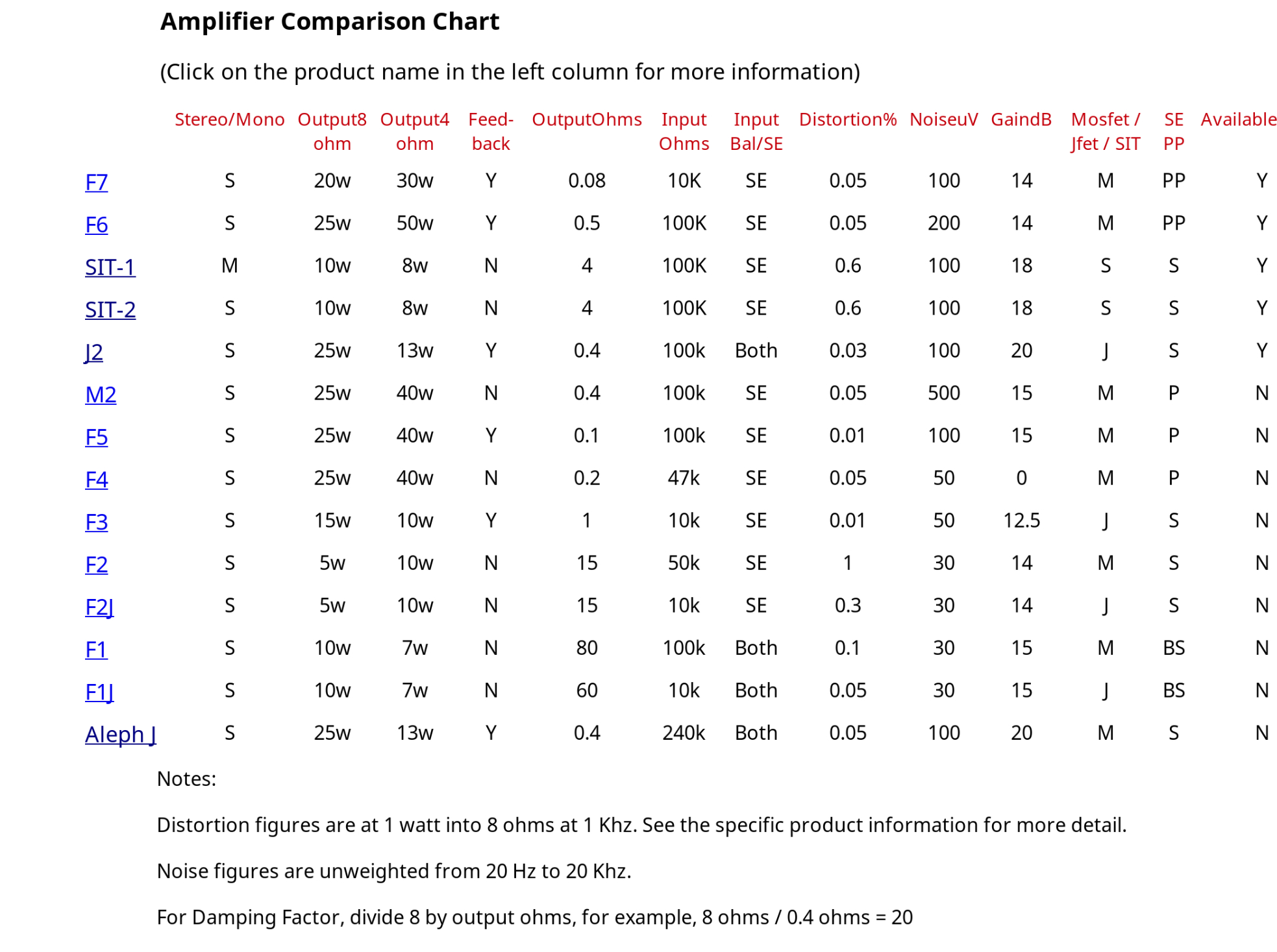

It would be very useful if somebody would produce a 'summary table' with the basic gain info for the Pass circuits. The power amps don't compare with other diy or commercial power amps in gain, and some of the very popular Pass 'line stages' (B1,BOSOZ) don't have enough gain to do the job either.
You don't read this page ?

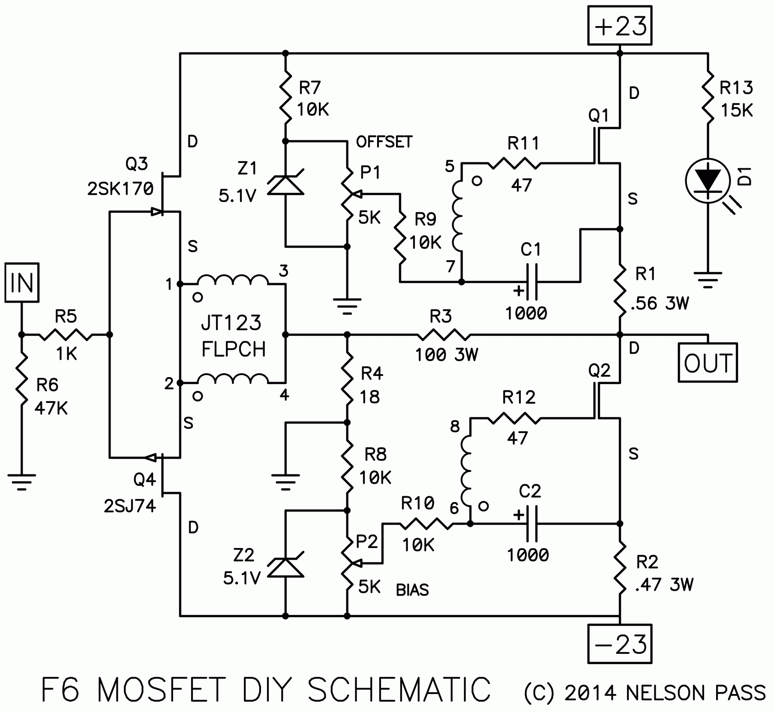

You haven't made a mistake.
Just double the gain of the amp.
Change the 100 Ohm feedback resistor to 200 Ohms and see if that is to your liking.
Try that first.
THANK YOU!
That's definitely an easy experiment to try right now.
Just to be clear - the feedback resistor is the R3 100 ohm between the output and the primary of the transformer?
And, it sounds like I won't need to double the gain, just add something like 5-8 dB (??) so perhaps an intermediate value of R3 will do the job?
I have some 3W low resistance pots which I can use to experiment with this...😀
I probably read it but didn't fully understand the implications of the data there...
Perhaps adding another column would have helped a neophyte:
"Requires a preamp with 5-10dB gain for use with CD player or line source-Y/N"

You will need to look hard to find dB gain figures for some common (Yamaha, Rotel, etc) commercial power amps, so it is difficult to compare, for a beginner.
A simple statement: "Needs a preamp with 5dB gain for ordinary use with a CD player" would not be difficult to add to the specs and discussions.

Yes.
Go for your life, play around then replace pot with the nearest fixed resistor, or you can leave the pot in place for adjustable gain.
A 100 Ohm fixed resistor in series with a 100 or 200 Ohm pot would be a suitable place to start to experiment.
Yes.
I'll report back here if I get any measurements of interest.

I have an HP339 Distortion Analyzer which I generally use just as an oscillator, but I got some THD numbers with it. I wouldn't put much confidence in the absolute numbers (the HP339 hasn't been calibrated in years) but the changes in %THD were as I expected, and possibly of interest. "It's all relative" as the saying goes...😀
The p-p voltages were measured using a scope.
Input signal was 10kHz sine wave, 2 V p-p.
The idea was to change the value of R3- the 100 ohm 'feedback resistor' to observe the changes in gain and THD.
As built, with Rfb= 100ohms, output into an 8 ohm dummy load was 12V p-p
15.5dB gain THD= 0.03%
Rfb=200 ohms Output was 17 V p-p
18.5 dB gain THD=0.06%
Rfb=300 ohms Output was 24 V p-p
21.5 dB gain THD=0.14%
I'll need some sort of 'volume control' (aka input attenuator) in front of the F6 anyway - I was using a 10k pot for some quick tests with music this evening.
Since I easily can build a simple preamp with very low THD numbers (with volume and balance control), for me it makes sense to go in that direction.
That said, if the 0.14% THD number is correct, that's not bad, so boosting the gain by increasing R3 may be a useful possibility to keep in mind.
Thanks to 2Pico for that idea!
