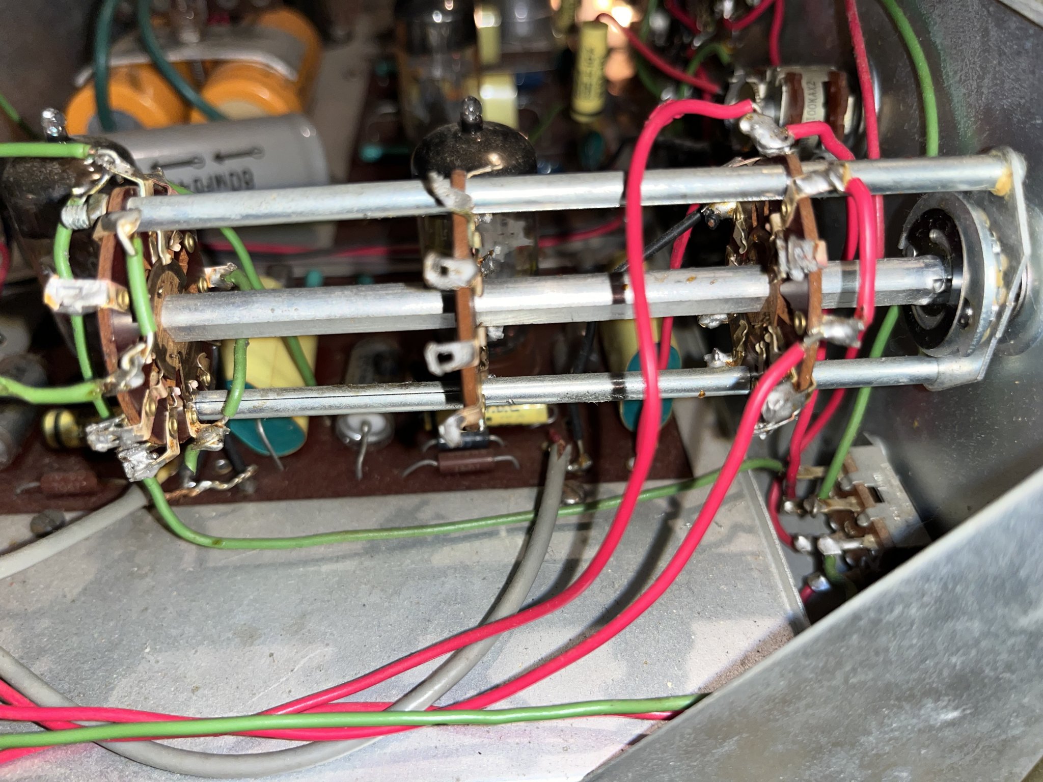

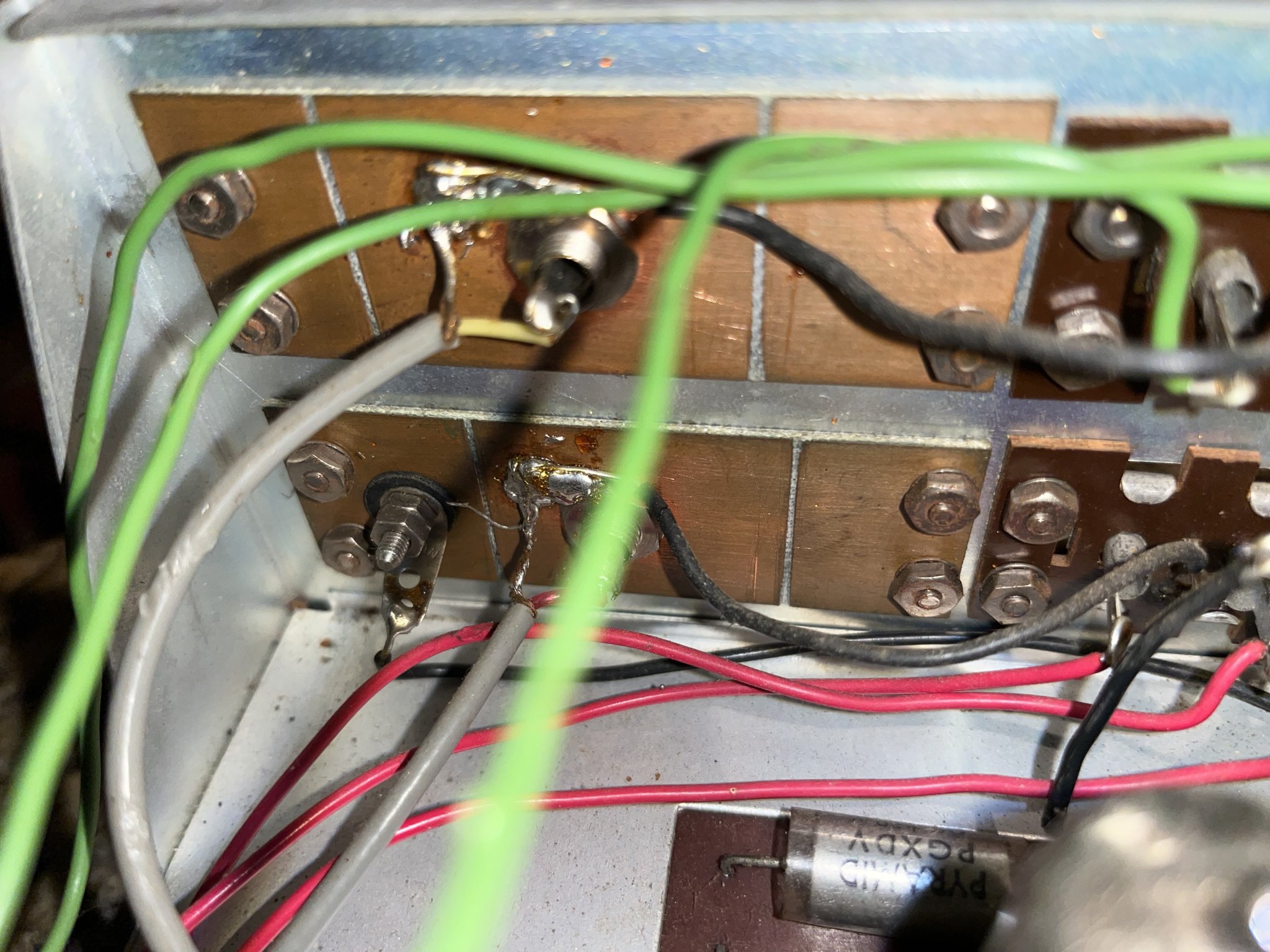

PAS3x Van Alstine Modded question:

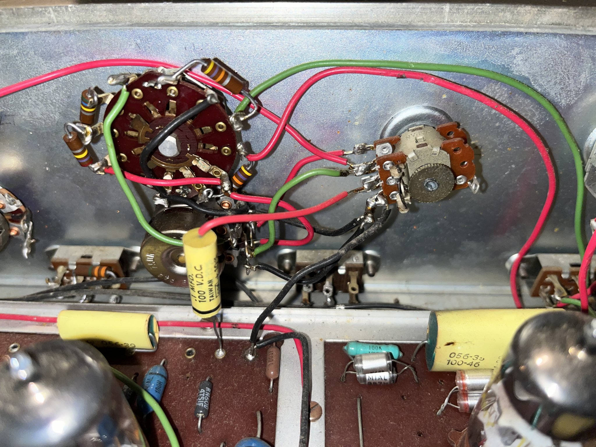

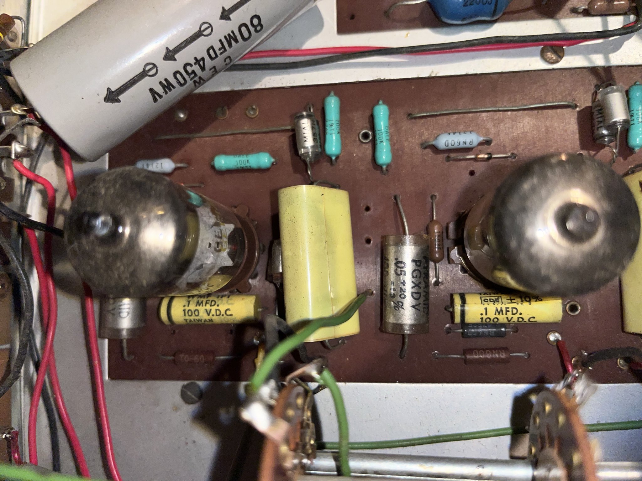

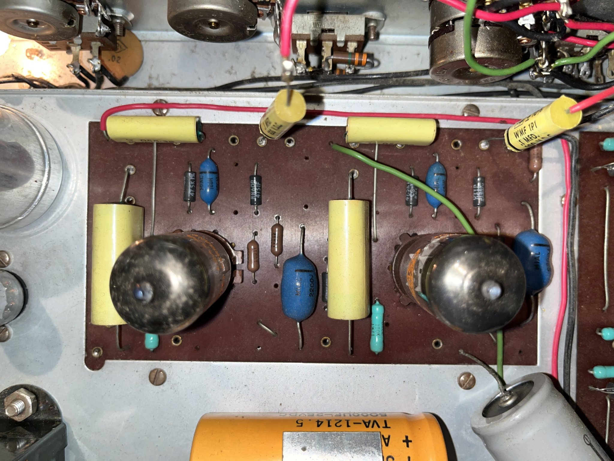

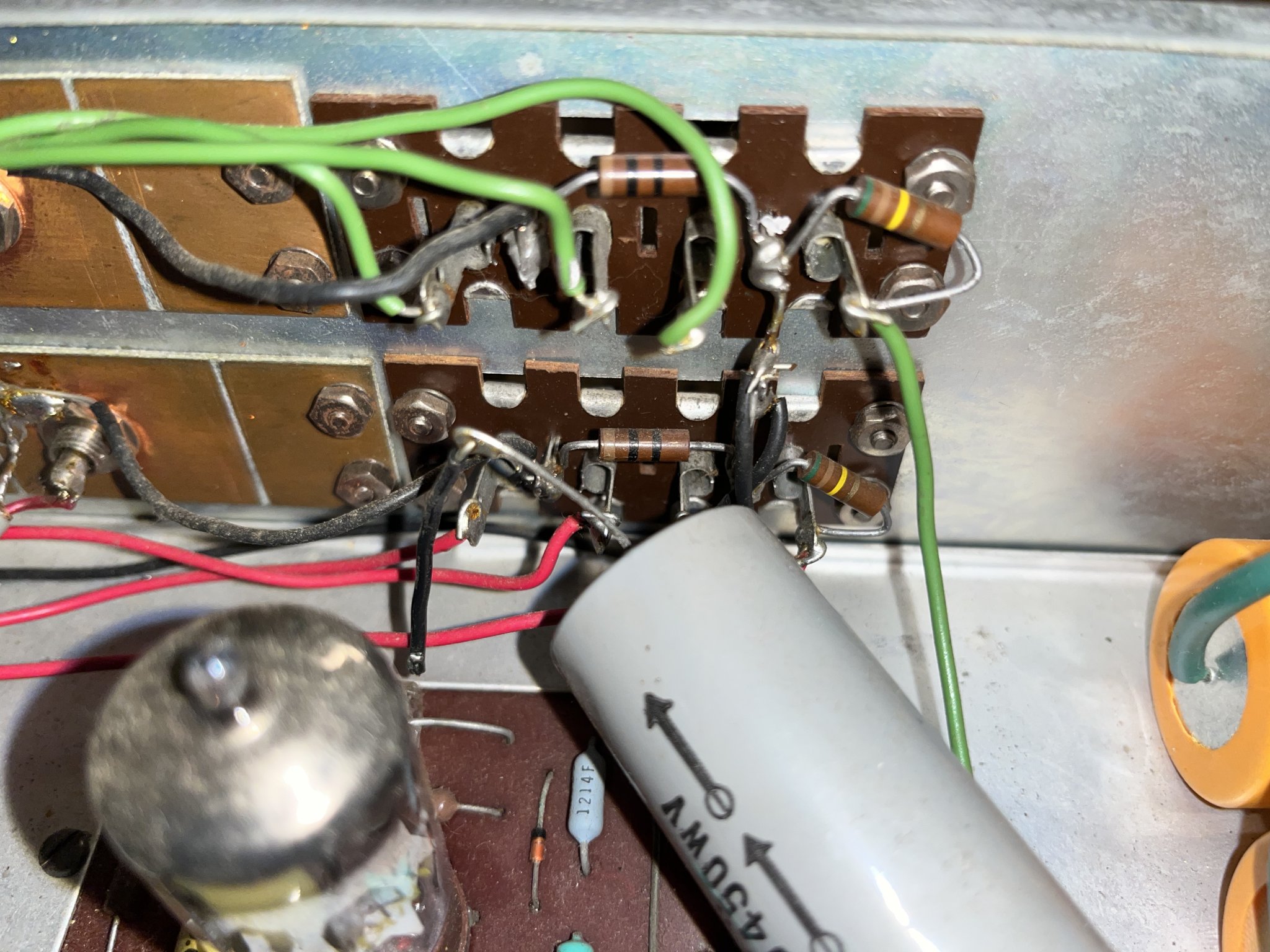

Hey guys. I have a dyna PAS3x that is OEM. I just acquired another one that has the Alstine mods done to it. I am not too familiar with the Alstine unit. I have read a lot about them, but this is the 1st time i’ve been inside one. My question is this: one large capacitor has come unsoldered at one end. By looking at the pics included, can anyone tell me where to resolder the loose connection. I have looked at every pic on the net, but cannot find an image that is the same as the layout of my unit. All of the tubes light up except the two 02AX7A’s shown in pic #1. It seems that the loose connection will power these two tubes, but i do not see where it might have been connected. I will provide more pics, videos or live facetime with anyone who might help. Thanks a million. Jeff

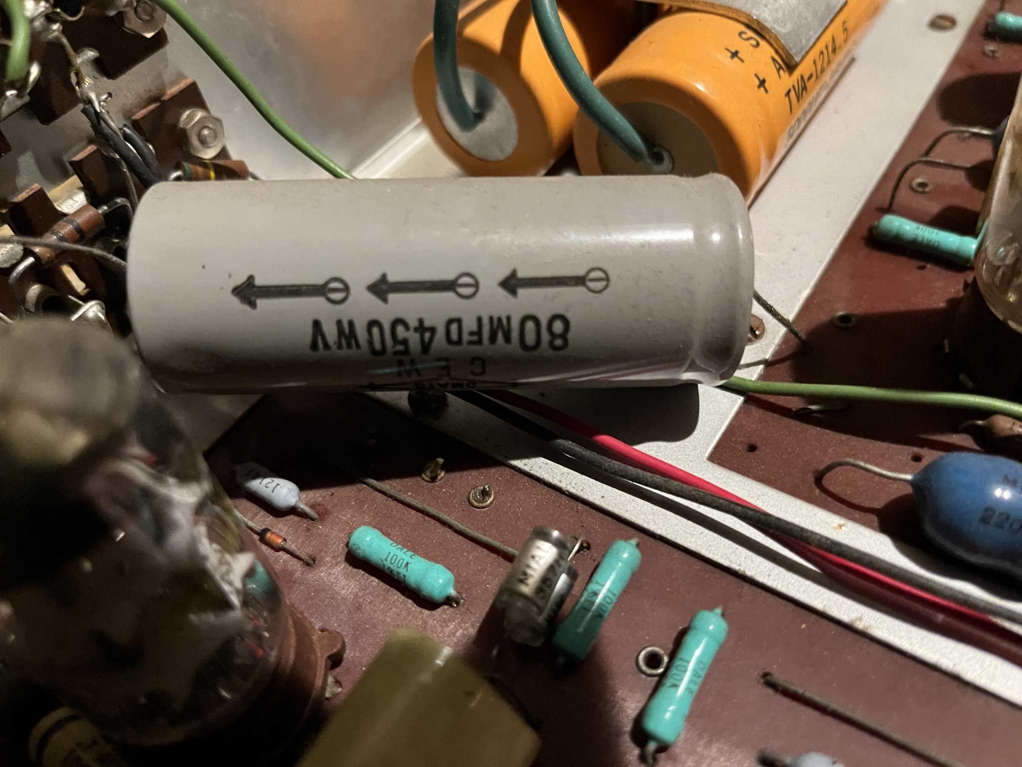

Just guessing: the cap is a 80uF 450V, so it should belong to the power supply; the loose wire is from the negative side of the cap, so it should go to ground. That doesn't explain why half of the tubes don't light up, so you may have another prob elsewhere.

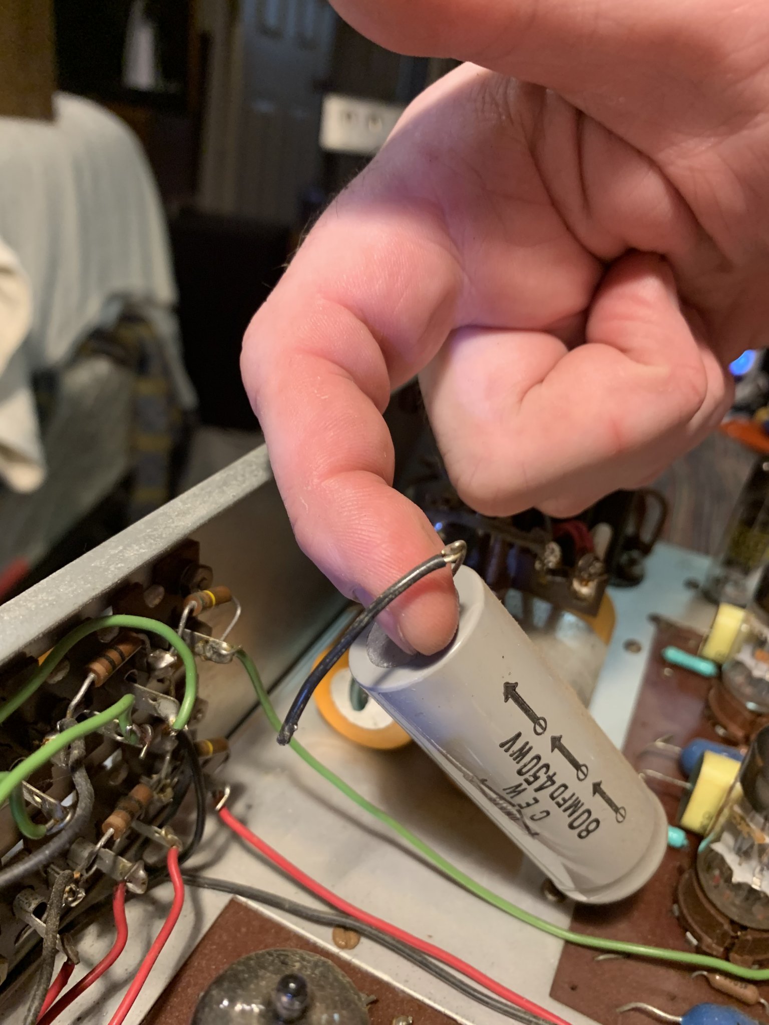

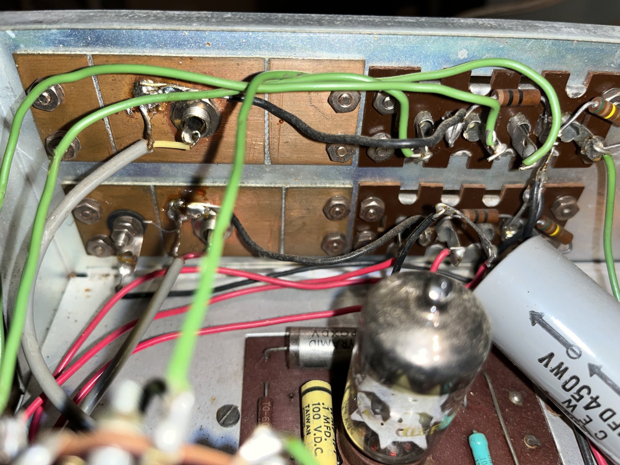

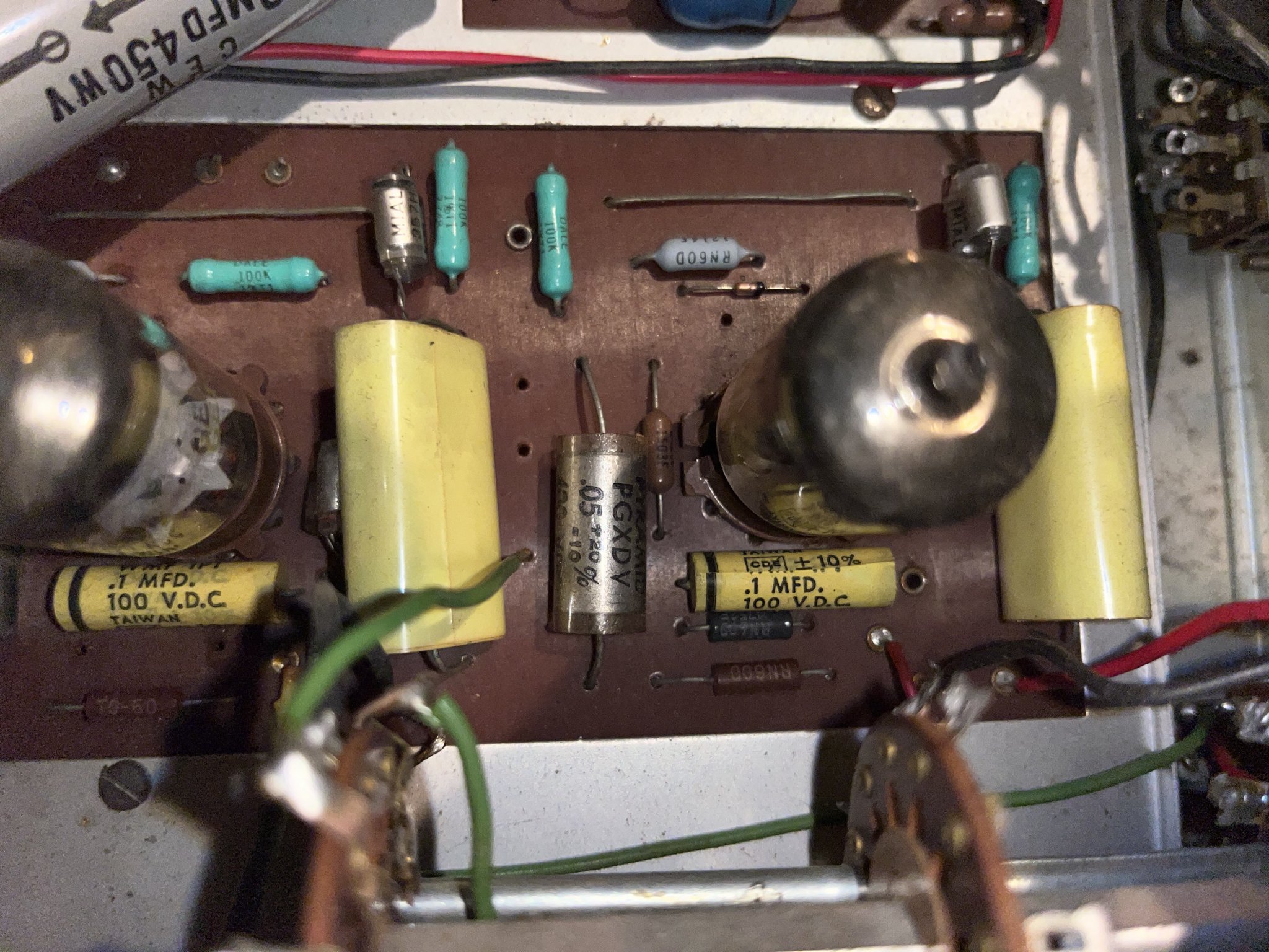

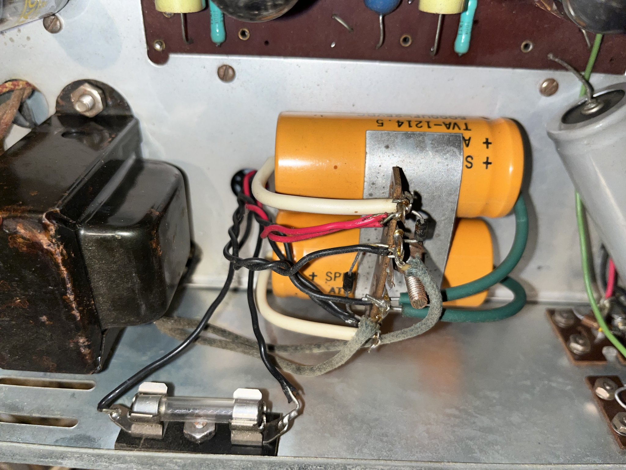

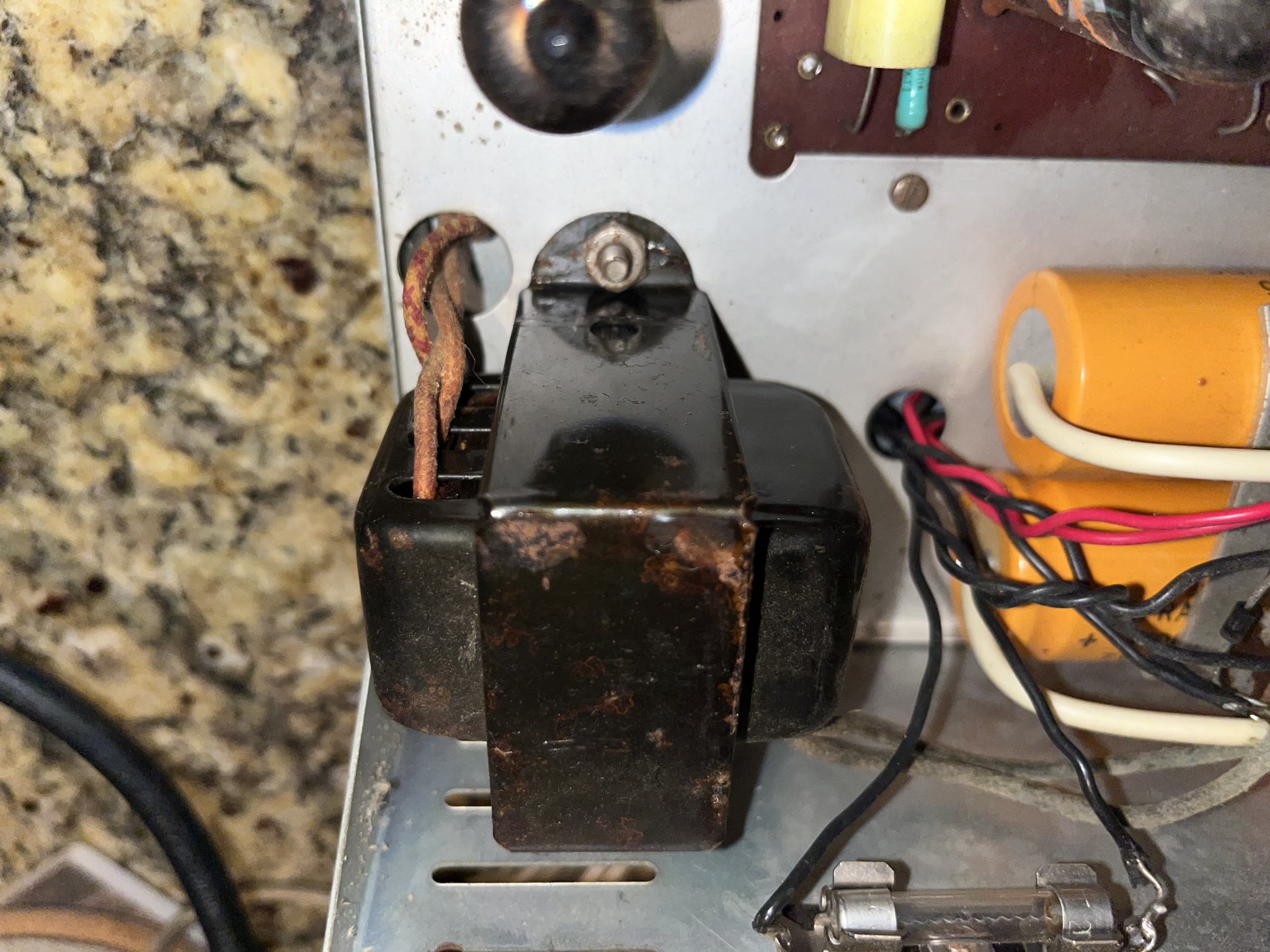

zung, you are correct. that is exactly what to cap is. i can solder well, but not sure what spot to connect the loose ended wire running off of the cap. Here are more pics. if you can spot where is connect it to, please mark on the pic where x marks the spot. thanks

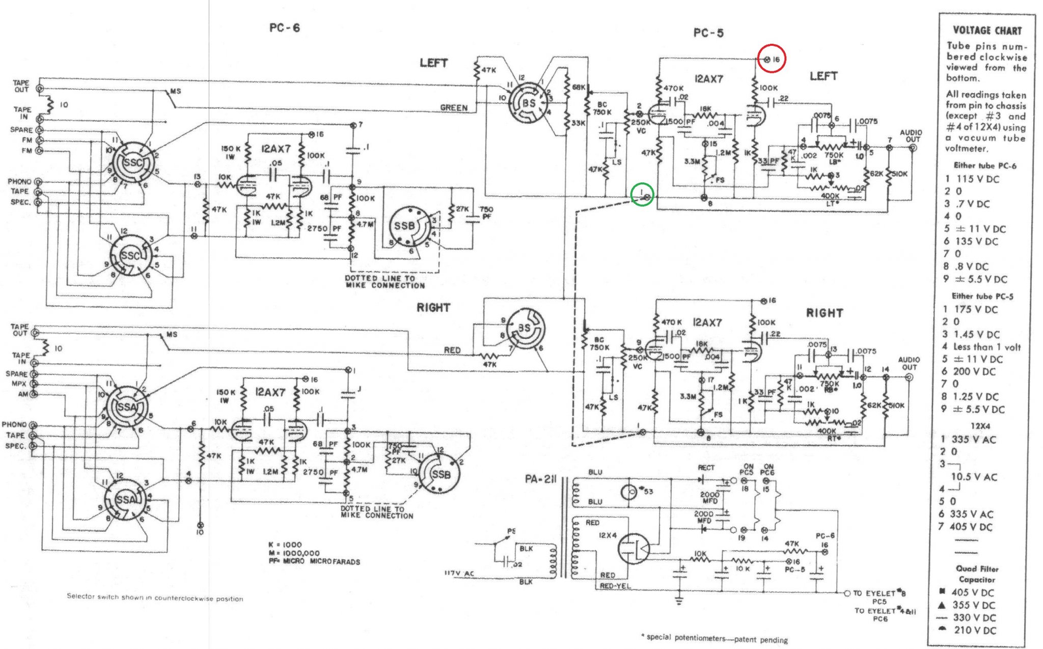

Lemme get this right: initially, the negative (-) side of the cap got unsoldered; you soldered it back, and somehow the positive (+) side got unsoldered, and you don't know where it goes. Right?
The morale of the story is:
  • Always take pics before and after
  • If the (+) got loose by itself, you may question the quality of the solder joints, and you may want to reflow every joints, if you think you can do better. This may also cure the heater problem.
Now for the fix: because I don't know how the previous owner has butchered this whole mess, we need to go by the book: in the attached schematic, I circle the eyelet #16: this is where the (+) lead should go. Be careful, there are wires underneath, so plan your action. Alternatively, if the cap fits under the chassis, it's a lot easier: (+) goes to #16, and (-) goes to eyelet #1, circled in green; but again, plan your action and go slow.
