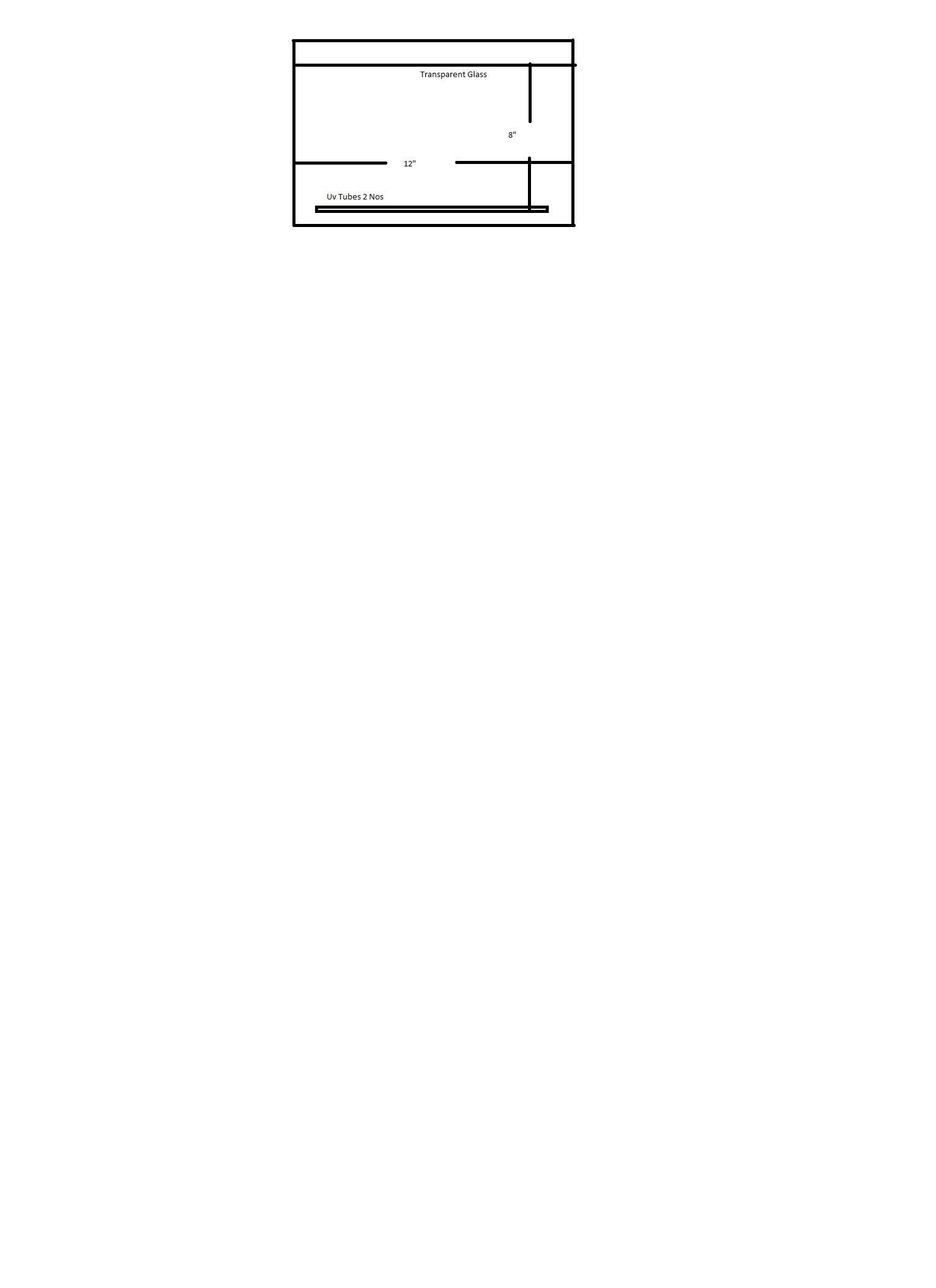

Make your Own PCB with Photo Resist Process.
I am sharing the procedure which is used professionally and which I am using successfully for My Pcbs.
Required Tools-
1. Bare Pcb.
2. Photoresist Film.
3. Laminator or Hot water process which I will Describe.
4. Laser prints of your Pcb Mirrored on butter paper. Exposed area of Film will stay and rest will be washed out.
5. Uv Box.
5. Washing Soda for Developing.
6. Hydrochloric Acid
7. Hydrogen Peroxide.
8. Acetone or Thinner.
Procedure-
1. Clean your Pcb with very fine Water paper or Scotch brite clean it in running water till its Shines .Do not touch cleaned part with fingers as it may become greasy.
2. Applying Photo Resist Cut Photo Resist film about 1 inch Bigger than your Pcb on all sides.
Photo resist film is made of 3 parts.Top and bottom layer of Thin Plastic / Mylar layer. Mid layer Photo resist Chemical.
Scrap top layer with sharp blade to loosen an edge of top layer. Remove top layer and align film with pcb and let it pass through lamination Machine.
Hot Water Process- Requirement
Clothes Iron and Hot water in Spray Bottle.
Heat your Pcb with Home iron on cotton mode. Keep a layer of paper between iron and pcb . Do not touch iron to Pcb directly as it may deposit dirt.
As soon as your Pcb is hot Sprinkle the Pcb as well as Photo Resist Film with Spray of Hot Water. then start Aligning your Film from one side while Continuously rubbing film from one end to another as if you are removing water as well as bubbles with your thumb or Rubber squeeze . I have this in Pdf with Illustrations , if you need I Will mail it.
3. Uv Box -
Make a Wooden box of size about 12"width x 12" Height x 10" Depth. Attach a transparent Glass of Box Internal Dimensions. Attach two Uv tubes at Bottom, Distance between tube and Glass Partition 8".
Attach laser print on your Pcb coated with Photo Resist Film.
Printed side should face the pcb. keep Print side down on Uv Box Glass. Put some weight on the pcb so it sticks properly and evenly to Pcb.
Expose for 4 Minutes. Now you will have a image of your print on Pcb. Let it cool down for 10 Minutes. After that remove top Thin Plastic Layer.
4. Developing-
Prepare a solution of 1 table Spoon of washing soda and 1 Liter of Luke warm water, Mix it thoroughly. Dip your pcb in the solution , your print on Pcb Will Darken,after 1 min lightly scrub your pcb Lightly with soft brush keeping pcb in the solution . After about 2 to 3 min Unexposed part of film will be wahed away leaving bare pcb exposed and , Exposed area will remain on Pcb. Clean your Pcb with Running water.
5. Etching-
Prepare a solution of 2 parts Hydrogen Peroxide and one part Hydrochloric Acid in a Shalow Plastic Tray. Hydrogen Peroxide will oxidize Exposed PCB and Acid will Eat it. Sway your Tray as not to Spill any of the solution. in 1 min all exposed copper will be removed leaving Area under photo Resist film which are your Pcb tracks. Check for Shorts if none Clean Under Running water.
Now your PCB is ready , Drill it, You can Leave the film on tracks if you want as it will protect pcb from Oxidization and act as Flux.
Enjoy.
