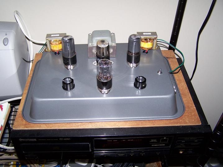

Hi M gregg,
I have used Hammond and Edcor.
Edcor is as good if not better than hammond IMHO.
One small problem with Edcor is they make each transformer on
order and it takes 4 weeks to get your order. Shipping is
good, they dont set the price - the carrier does...
If all you need is 2 SE low-hi outputs check with
Antique Electronic Supply
they have them going for $13.00 usd each. look under miscellanous
transformers.
I just got two of these and they sound pretty darn good to me for low-hi.
I used these with 6V6 SE....
Here's a picture of my low-fi 6V6 SE cake pan amp.
