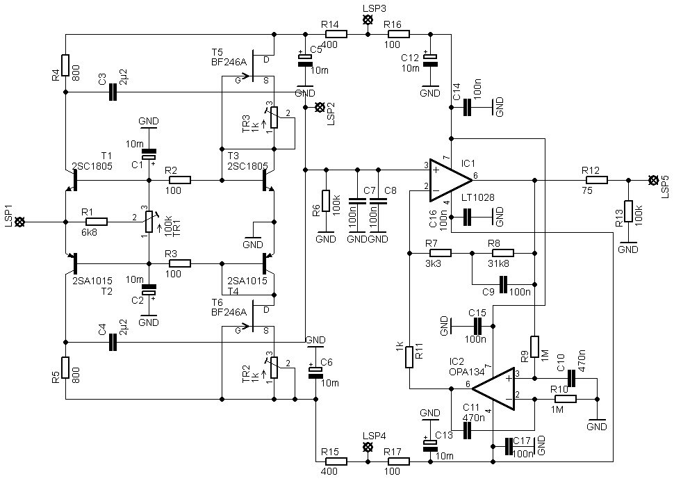

One last try. Replace the input stage of this one with Godfreys Fet- foldetd cascodes he designed after Johns sugestion. The schematic has a small error. There is a 220 Ohm feedback resistor missing from minus input of the Opamp to ground. Other Opamps can be used to taiste and budget.
Joachim, your schematic violates several guidelines. First, it is a summing input. Do you think this is ORIGINAL? I did my first summing input, with the Levinson JC-1AC, 36 years ago. Why don't I use it today? If you don't know, I will tell you: MOST moving coil cartridges don't LIKE a summing input. It OVER-DAMPS them. How do I know? Because I did an A-B test with the SAME preamp to show this, back in 1976. How would an input like this be good for a general phono preamp? Also, it would not ALLOW for moving magnet cartridges to be used, either.
Second, it is CAPACITOR COUPLED. NO COUPLING CAPACITORS! They are unnecessary and redundant in this type of design.

Sure, it only works well with very low impedance cartridges. I was showing it only because of the second stage that uses an Opamp with servo. That is not very original too.

MOST moving coil cartridges don't LIKE a summing input. It OVER-DAMPS them. How do I know? Because I did an A-B test with the SAME preamp to show this, back in 1976. .

You HAVE TO TRY IT! I first believed that summing type input was the best way. It is in my patented JC-1 design, that started being produced in 1973. Makes sense, and it seemed to work with modest summing, but with true common base input, it failed with most cartridges. Now, PLEASE PROVE ME WRONG. You will then save Constellation Audio at least $1000 OEM in parts for each unit, IF you can show me that a summing input works just great. BUT if you cannot PROVE IT, then please suspend your OPINIONS, because they have no substance.

John, I think a summing amplifer topology for a MM or MC input stinks. But, not for the reasons you state. This topology is completely sub-optimal in terms of noise performance. That's the real reason.
