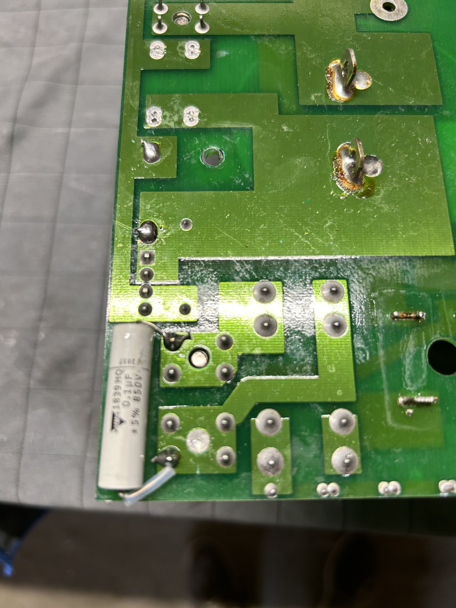

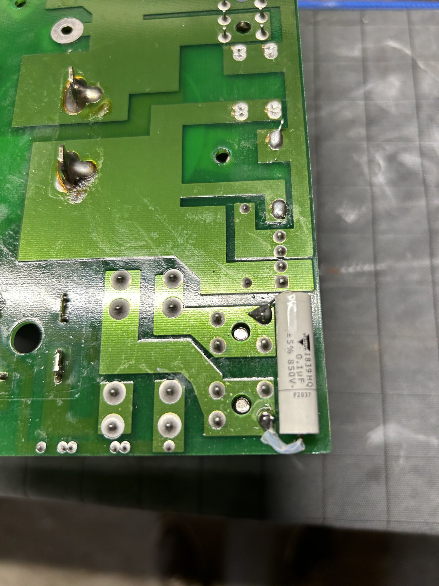

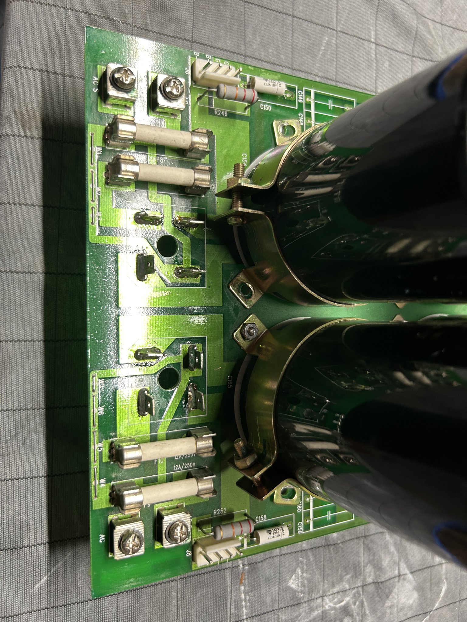

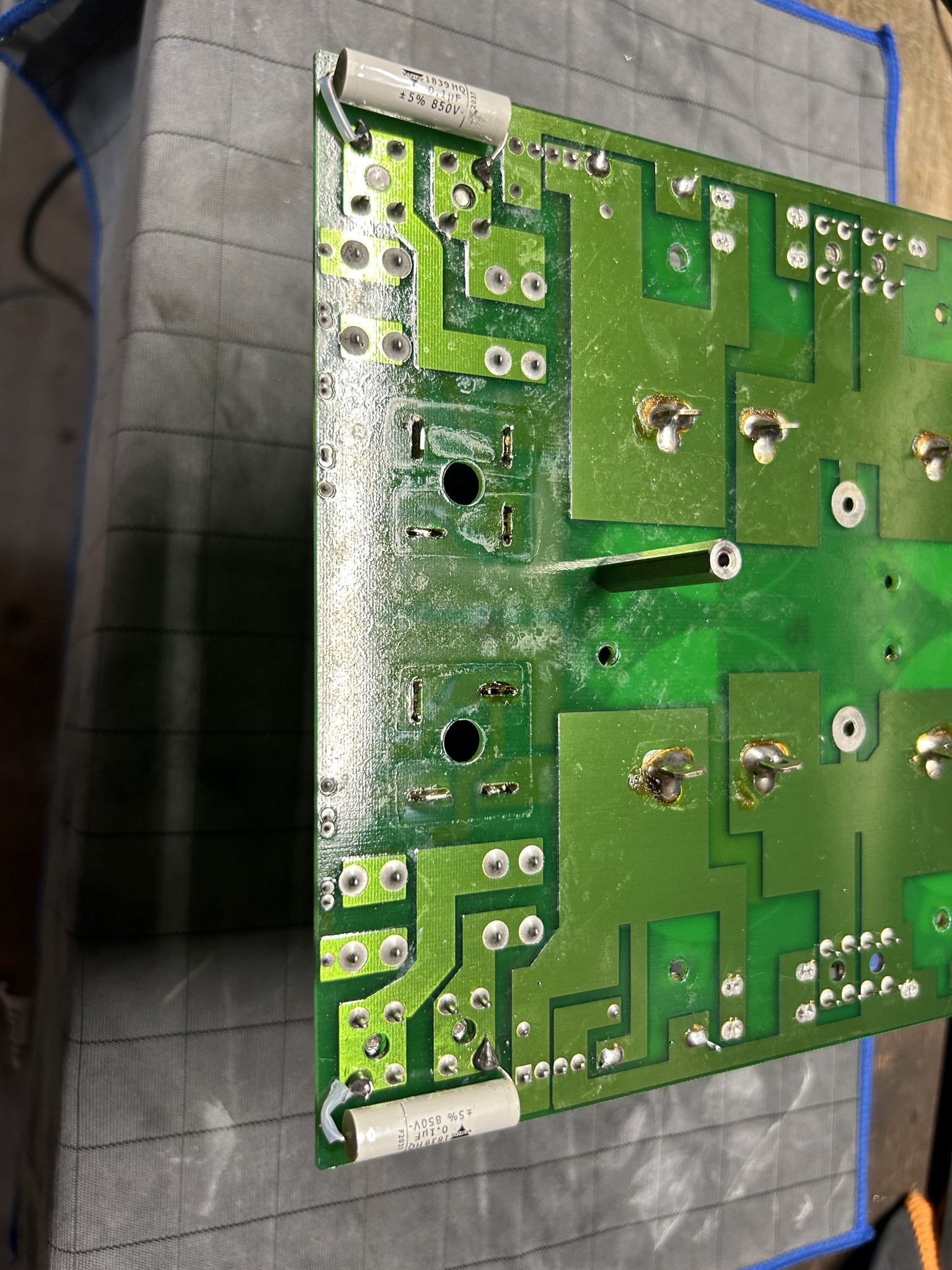

Here is a pic of the two Roederstein soldered under the board across T1 and T2 secondaries.

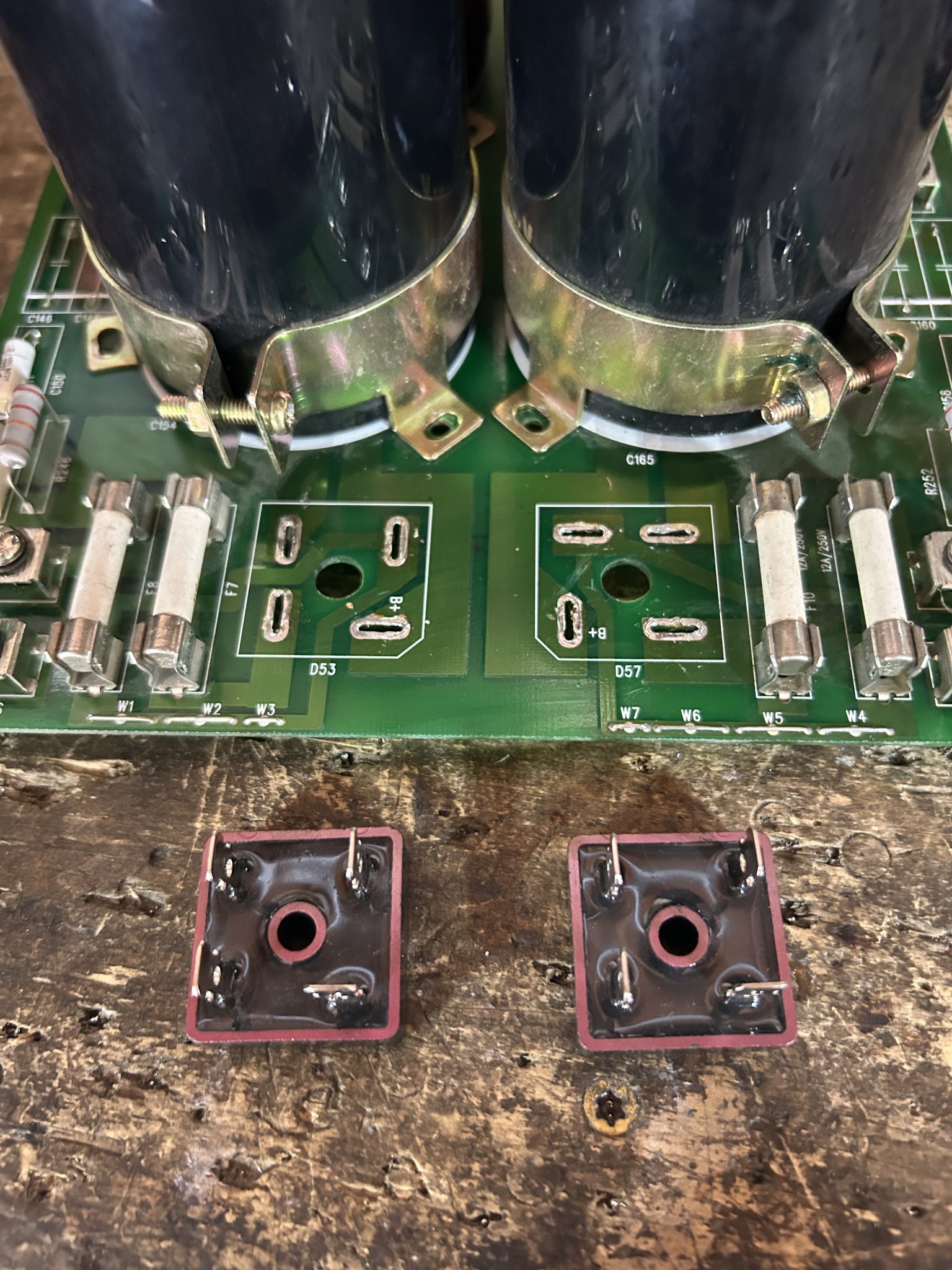

I also pulled out the screw mount diode bridges and installed spade connectors so I can go to the rectifiers and back to the boards.

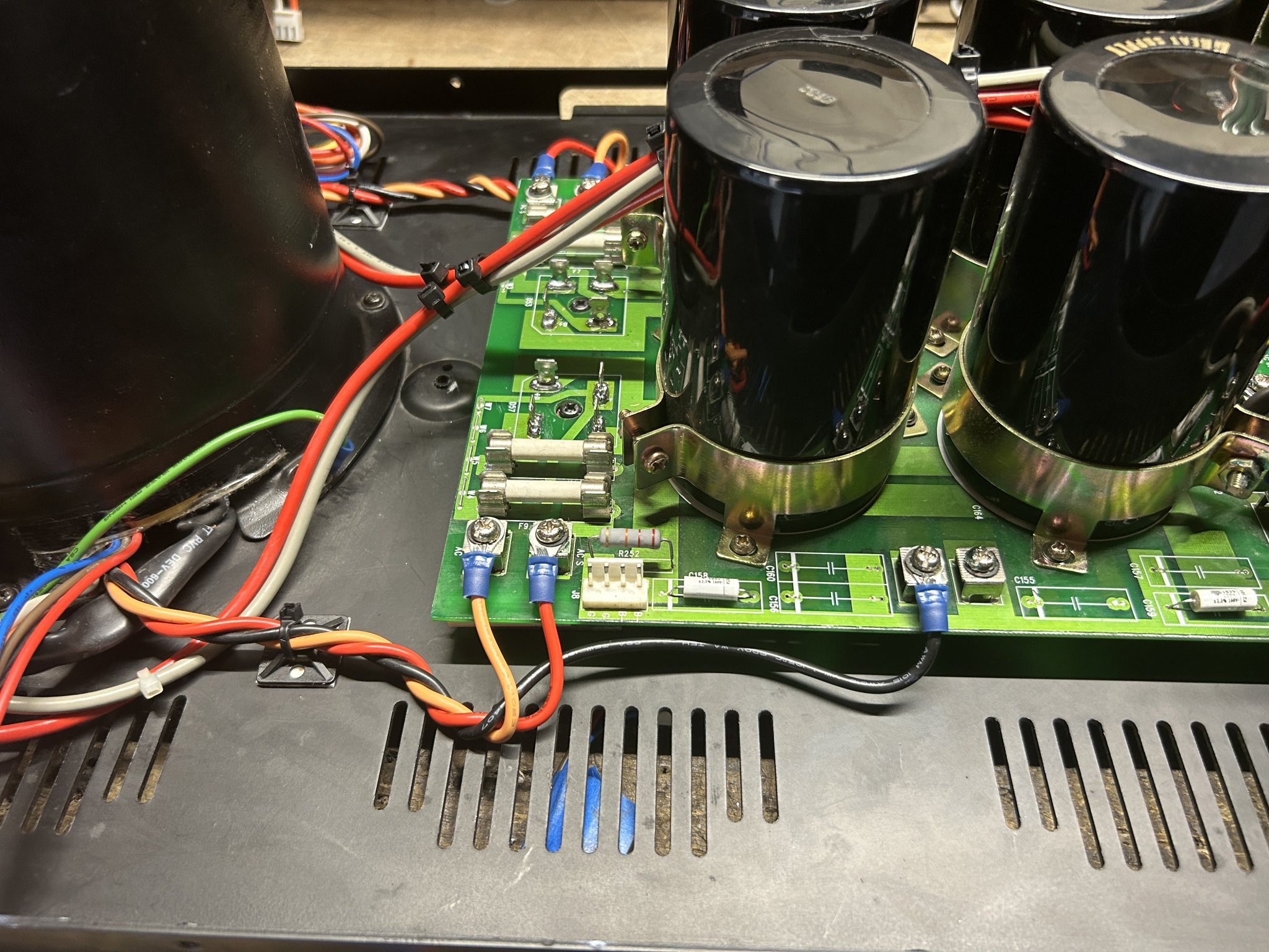

1. When checking the polarity of the AC, can it be done without the amp boards installed and only the PSU hooked up? I have two more parts I am waiting to arrive so won’t have the amp boards done until probably this weekend.

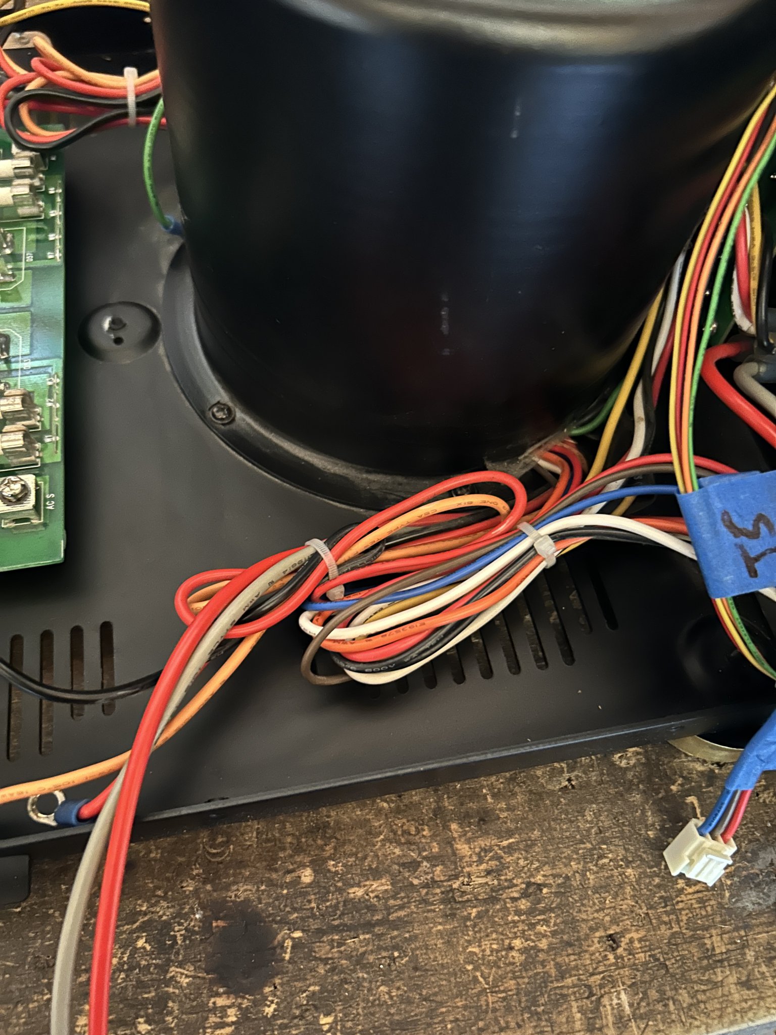

2. I noticed the Primary and secondary transformer wires were not cut to the exact length and instead the excess wire zip tied together. Is there a reason it was done this way? I’ve always thought AC wires should be cut as short as possible and twisted…

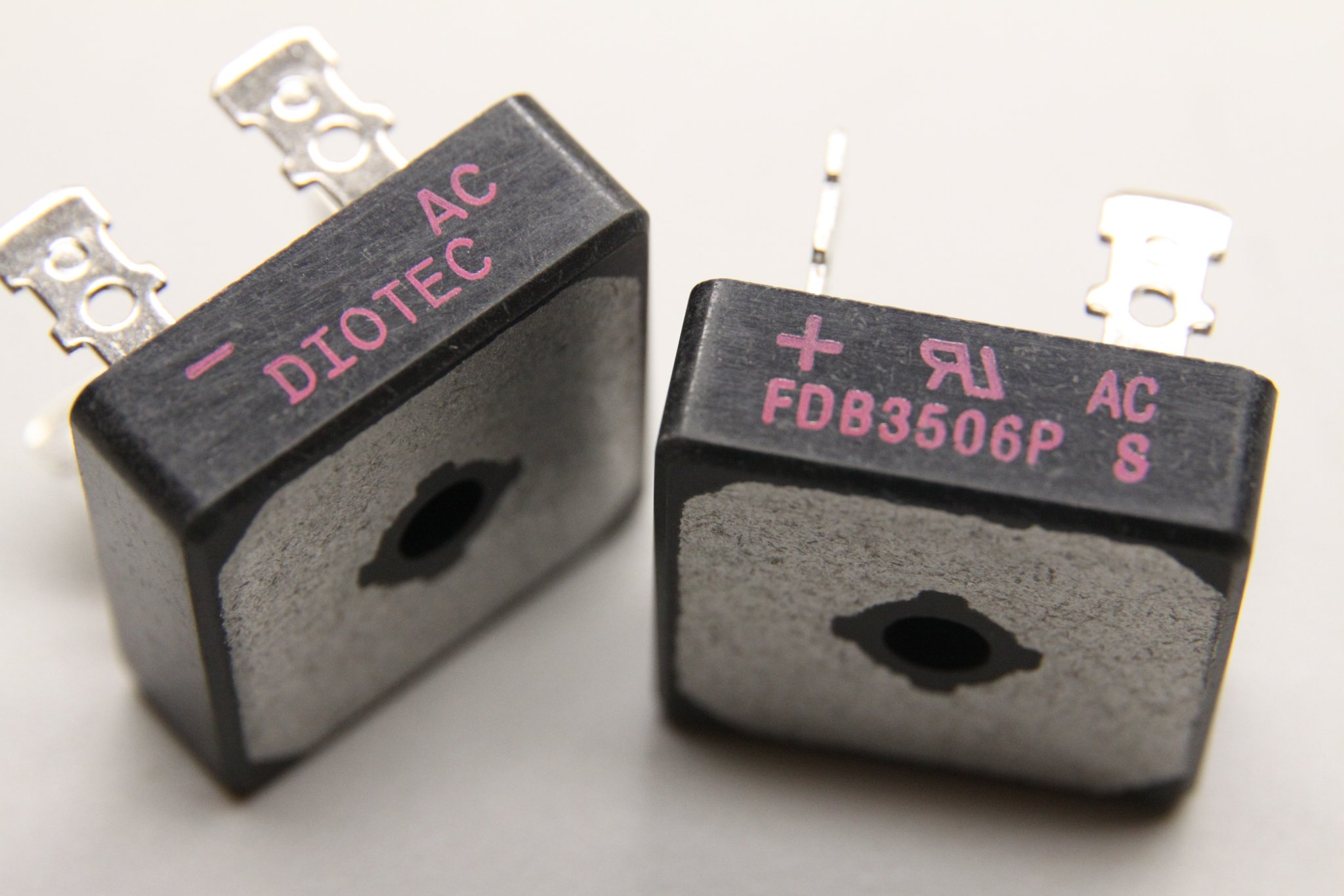

Of course right after I ordered the IXYS diode bridges, I get an email from Diotec with details on purchasing their FDB3506P/T that fits the PSU board.
They had a deal in place for purchasing more, so I went ahead and purchased 12 pieces from them. I will post some kits for anyone interested in modifying their HCA-3500.
Maybe to make repair easier or just out of lazyness. I would cut them to a comfortable length.
Yes. All the email communication was about the soft recovery model. We even spoke over the phone and Joe was a very nice guy.

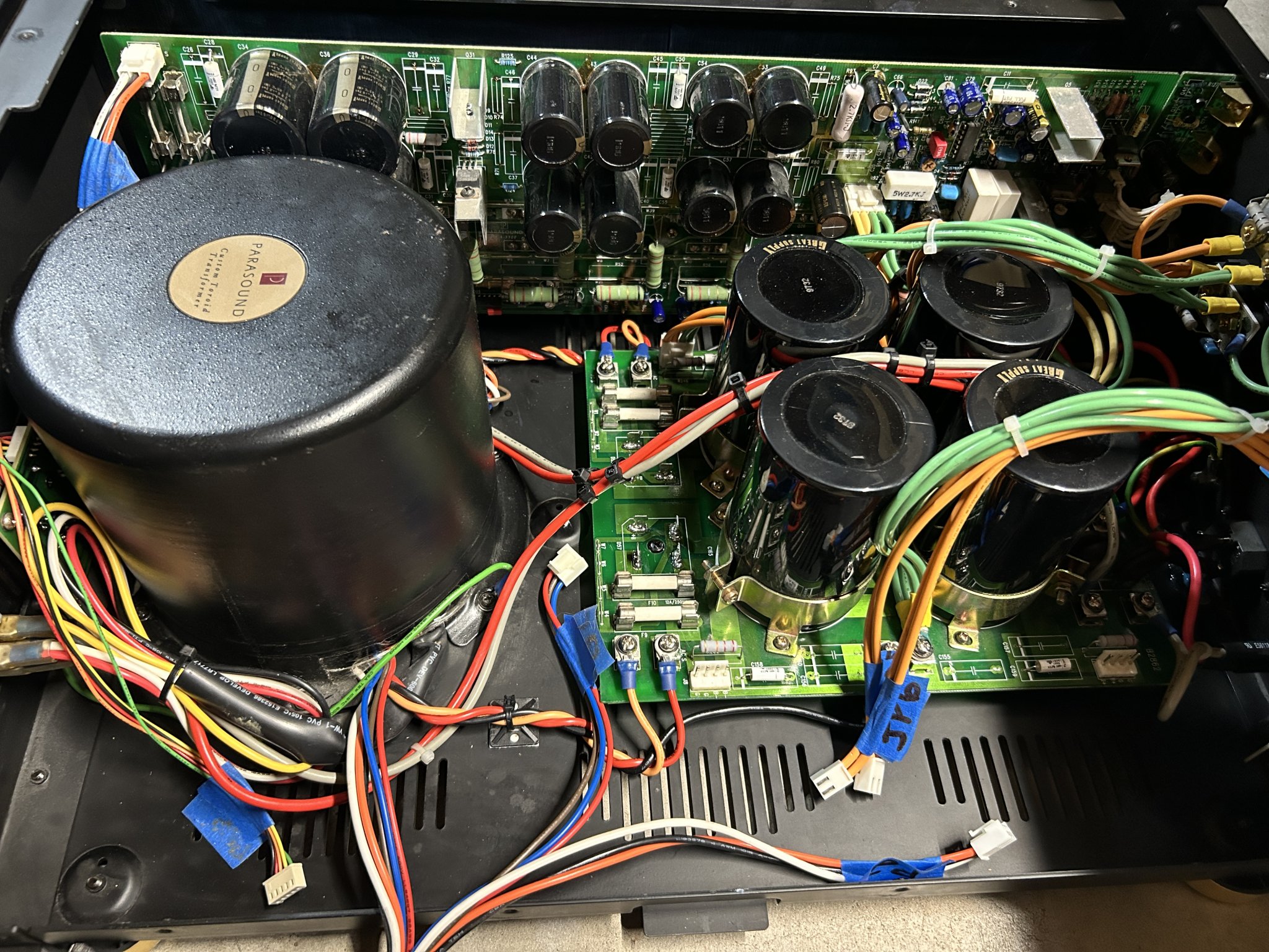

Diotec bridges arrived Saturday and they are, indeed, the soft recovery. I got them installed, shortened my secondary wires, and hooked the psu back up. Confirmed it was all good on voltages for both B+ and B- on both sides.
The PR9372 2.2k resistors aren’t set to arrive until Tuesday but I popped in a couple Dale RN55 resistors I had on hand and fired up the first channel on the variac. No problems or smoke so ran the unit and set the bias. I ended up leaving the dynamic bias resistors in but may remove them later by just snipping the two out.
I was able to finish the other amp board but need to clean it all up and buy some more thermal paste before installing it back.
Been a pretty easy recap with all of @bigskyaudio’s notes. I’m going to have some spare Holco resistors, PR9372 resistors, Diotec bridges and some Vishay Roederstein capacitors I’m going to sell as kits for anyone wanting to complete these mods.
The last thing I’m going to do is the AC polarity once I confirm everything works.

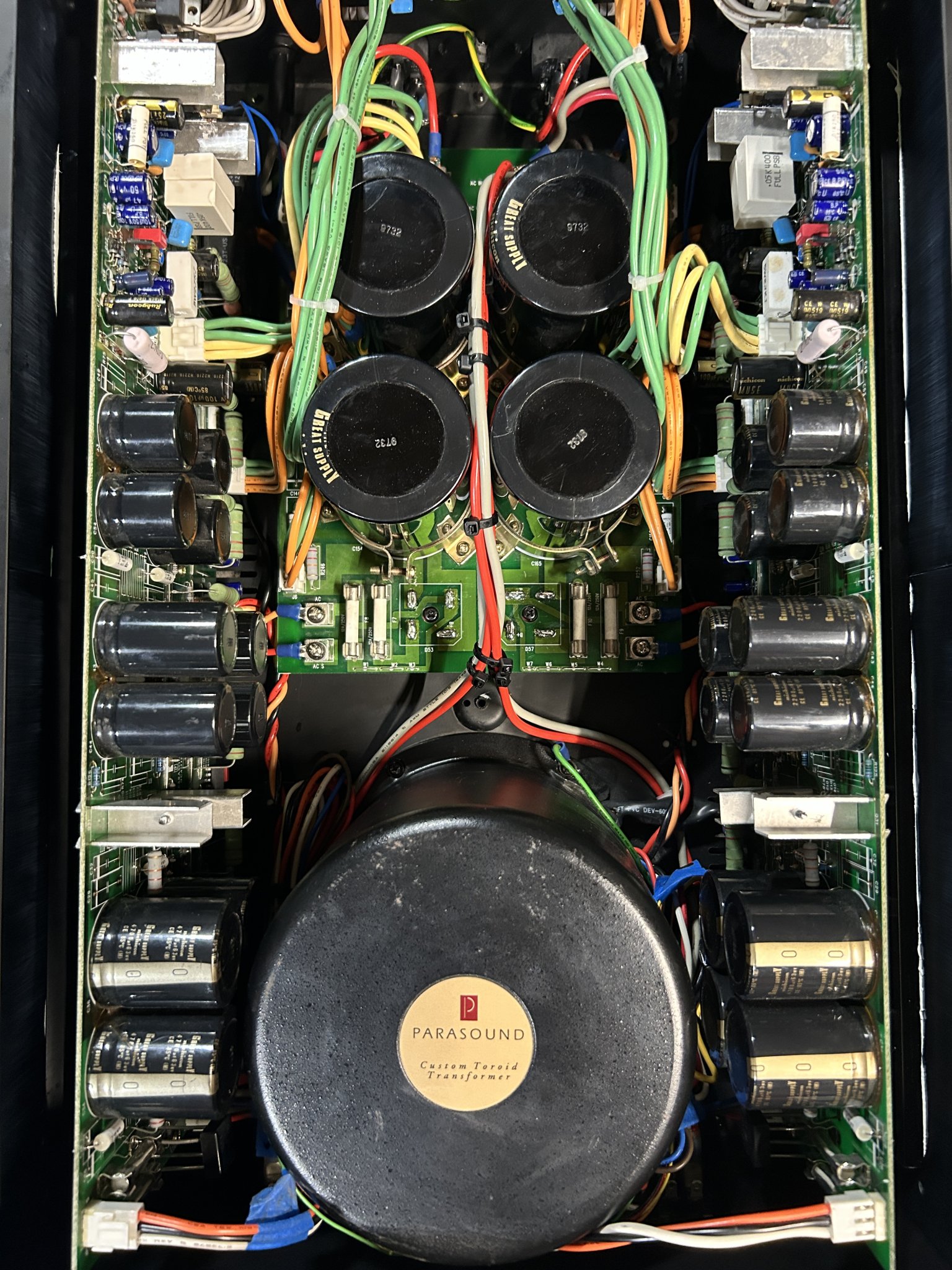

I installed the completed right channel last night and it fired up with zero hiccups. The bias was off quite a bit from before but I adjusted it again and it was stable on my work bench. Those pots are touchy so I may have bumped it while working on it.
The last thing for me to do was check polarity so I found a 2 prong power cable that allowed me to turn it either way. Took me a bit to realize how to do it correctly, but I put the black probe on the safety ground lug coming off both the IEC earth inlets. I then connected the red probe to bare metal where an empty screw hole was. I couldn't get a reading on my first DMM so I switched to another and was able to get readings of 0.028VAC in reverse on the left channel, so that channel was good on polarity when hooked up correctly.
The right channel, however, showed 0.031VAC when plugged in at the normal polarity. I haven't made a switch yet but from what I understand I just need to swap the gray (coming off fuse) and red (coming off N on IEC) wires labelled IN.
After that I should be done with the amp except for some more biasing and listening but I plan to do that in my main audio room. The only thing I did not complete on @bigskyaudio's list is to remove the dynamic bias feature. Could anyone explain a benefit to removing it? I know if it is removed the amp will always be running at the full 20mv bias and warm at all times. If I leave it in it allows for the amp to "idle" at lower temperatures and wattage.
Amp is all done and now in my listening room. I’m going to check bias one more time in that room and not my hot garage. Heaving that thing up the stairs was tough! I see why @bigskyaudio decided to not mod them anymore.
I hooked it up this morning and gave it a quick listen on my Magnepan LRS+ just to make sure it was playing and there was no noise. All checked out and music played.
