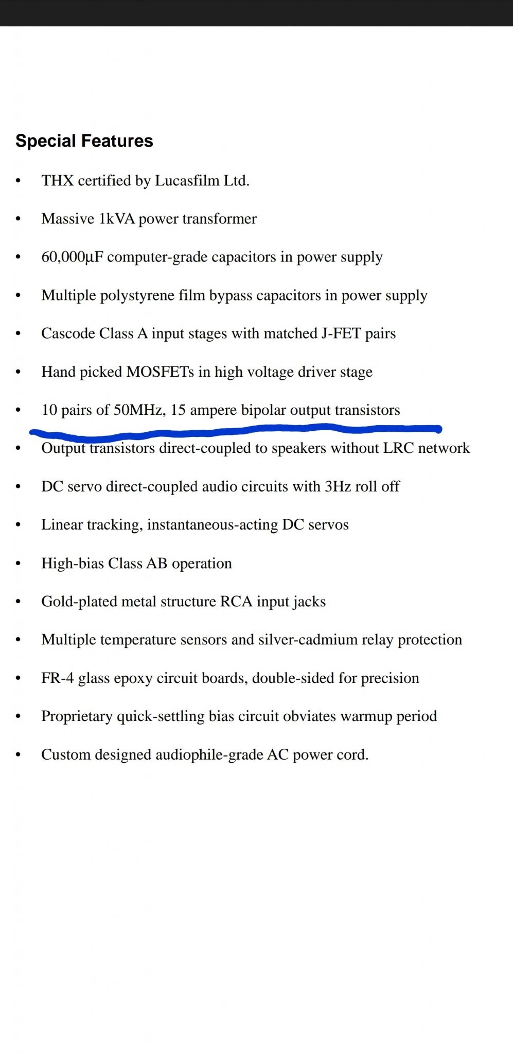

Yes it's fast, but it is slower than that SanKen ones,does it have negative influence on amplifier stability and sound quality?? Parasound represented this amp and HCA-1500II (vitch have this Toshiba transistors as output devices in official service manual) as "50Mhz 15A output device" amplifiers. Is that statement suported by this data abouth Toshiba 2SA1553 and 2SC4029??

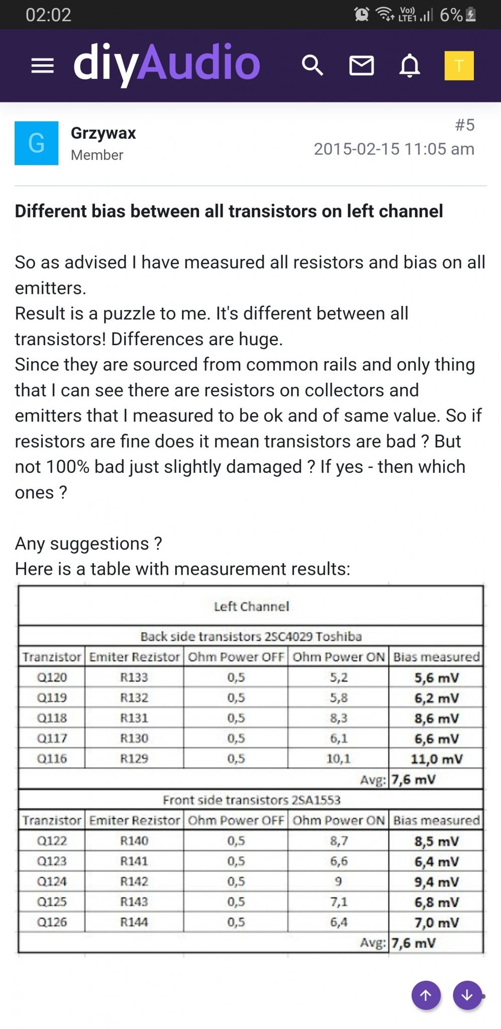

Yes, maybe it's ok,but i would like someone confirm to me there was original/regular production of this amp with this Toshiba transistors,or someone with same configuration. I com across one old thread where someone has problem with different current reading from one channel, all 10 transistors given different values. Other channel was good. He posted table of reading with this Toshiba transistors, but that topic is closed
https://www.diyaudio.com/community/threads/hca-1200-ii-bias-and-output-relays.227313/
