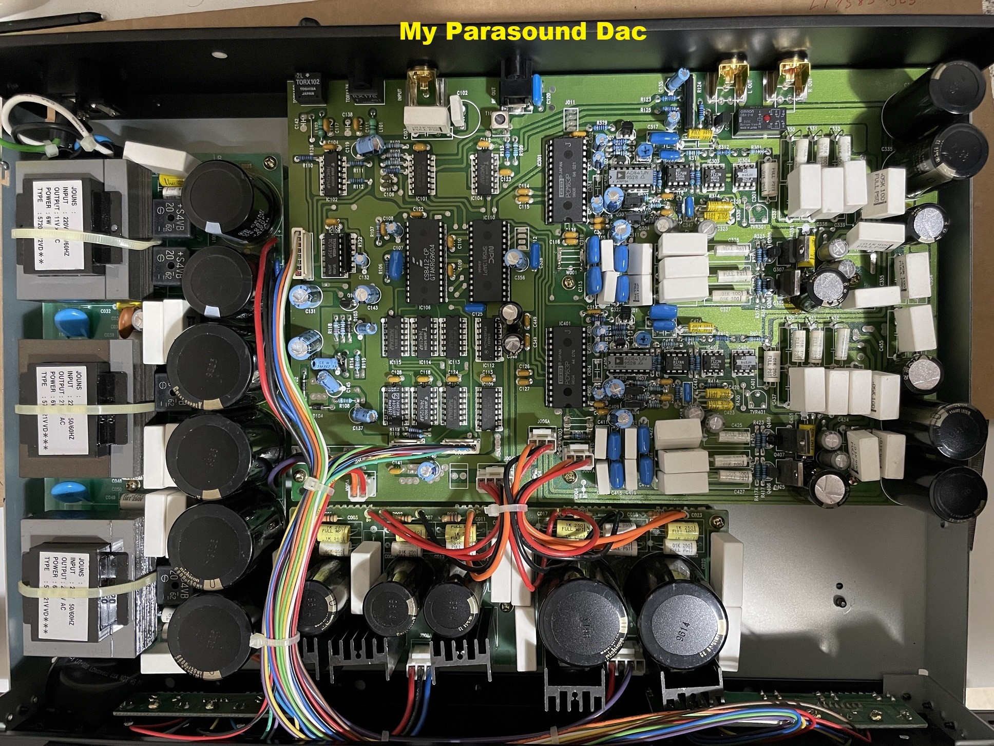

I opened it's cover and it seems like that Parasound "over built" it in comparison to other Dacs that I have/had.

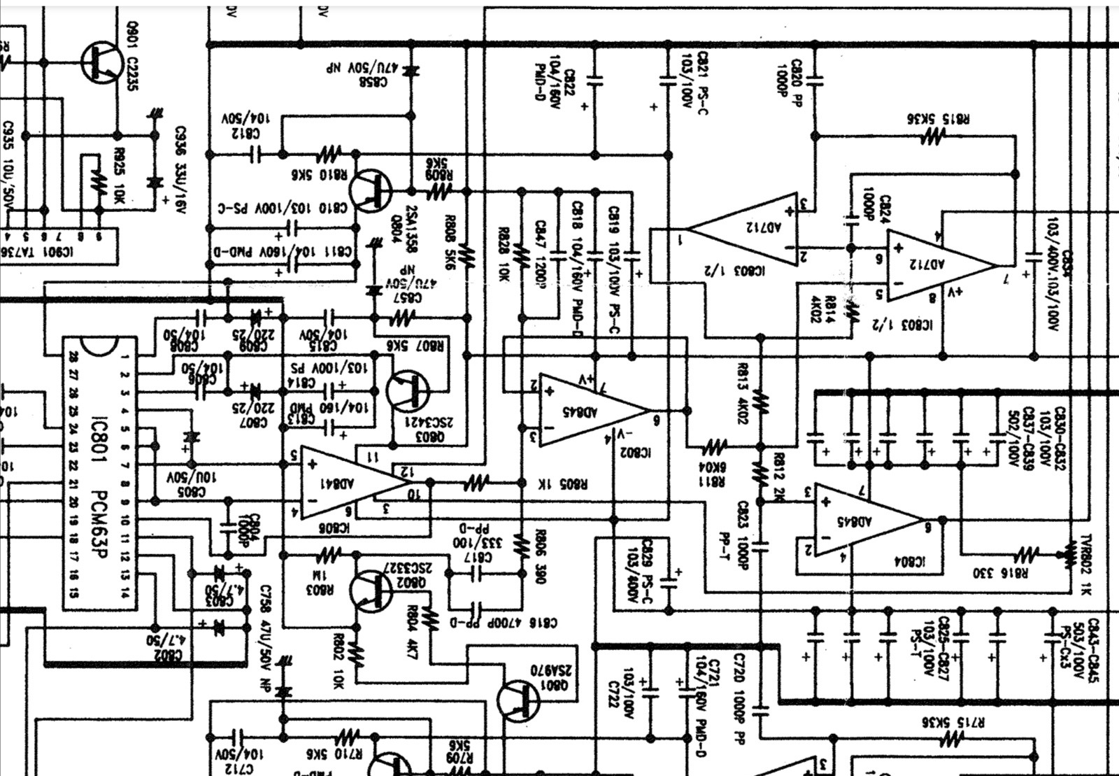

What really surprises me is the absence of C304 and C404. Particularly at high audio frequencies, it may lead to slew rate limiting in IC306 and IC406. If I wanted to modify the DAC, the first thing I would do would be to mount some decent quality 1 nF capacitors there, decent quality meaning preferably polystyrene, polypropylene or ceramic class 1 (such as NP0, C0G), most certainly not ceramic class 2 (such as X7R, X5R, Y5V, Z5U).
Regarding the function of the op-amps:
IC306 and IC406: current to voltage conversion, current to voltage conversion combined with a part of the reconstruction filtering when C304 and C404 are mounted.
The + and - signs in the symbol of IC302 are swapped.
IC302 and IC402: buffers after the switchable de-emphasis networks R305, R306, C316 + C317 and R405, R406, C416 + C417
IC303 and IC403: I think these must be frequency-dependent negative resistance circuits, part of the reconstruction filter.
R311, the circuit around IC303, R312 and C323 form a third-order low-pass filter that acts as the reconstruction filter (together with C304 and C404, if mounted). I don't know if you are familiar with LC ladder filters, but one of the many ways to transform an LC ladder filter into an equivalent active filter is to replace all inductors with resistors, all resistors with capacitors and all capacitors with circuits of which the impedance drops with the square of the frequency. Such circuits are called frequency-dependent negative resistance circuits.
IC304 and IC404: output buffers
The circuits around IC305, IC307, IC405 and IC407 look like voltage regulators, series regulators that have low noise levels over most of the audio band thanks to the filtering between their references and the rest.

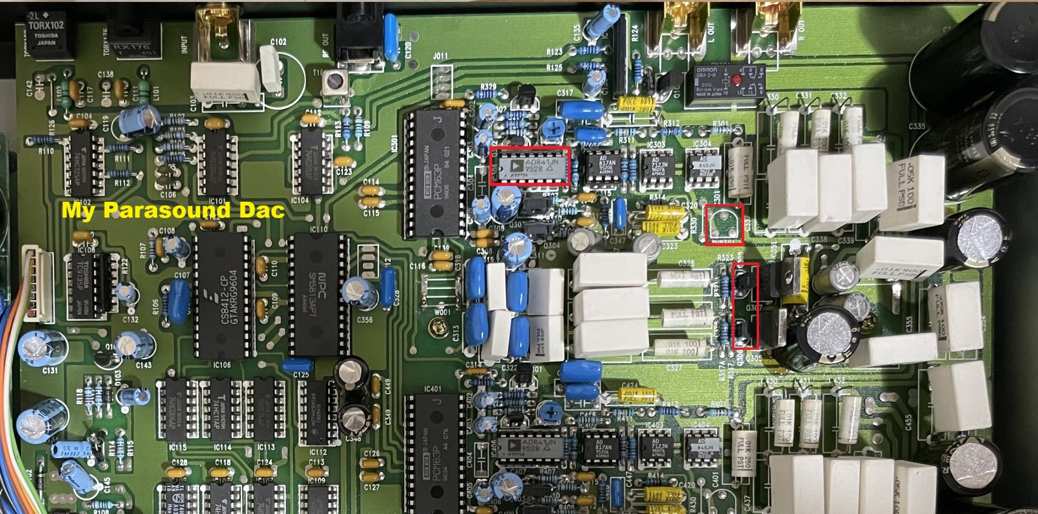

I also would like to mention that in my Dac1000 there is no AD744 but AD841JN and no 5534 opamps but AD845.

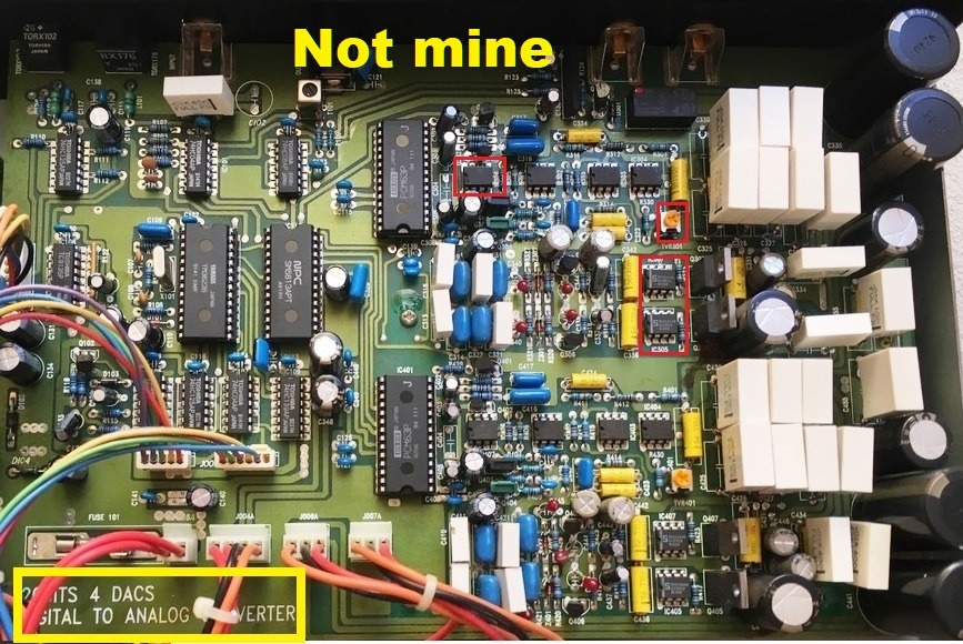

I've looked online and discovered that there is the version like in the schematics I previously attached and there is my Dac, attached photos.

Sorry to revive this thread but I've just found the correct service manual (it's a Dac-1500 manual but beside the balanced output and the quad pcm63 it's the same).
I'm still trying to figure out how to lower the Parasound's output voltage from 3.1V rms to 2V.

It is inside the PCM63. 1K5. Pins 9 and 10. 3K0 across those pins will do the job.Thanks, I'm looking for it but can't find it can you please direct me?
My version has less impact on the shape of the filter curve than rfbrw's version, but you could use 3 kohm and increase the capacitors C804 from 1 nF to 1.5 nF (with a decent dielectric, such as C0G, polystyrene or polypropylene) for rfbrw's version to correct the response. Besides, my version will have slightly less noise and rfbrw's may have slightly less distortion, but the differences are very small.
