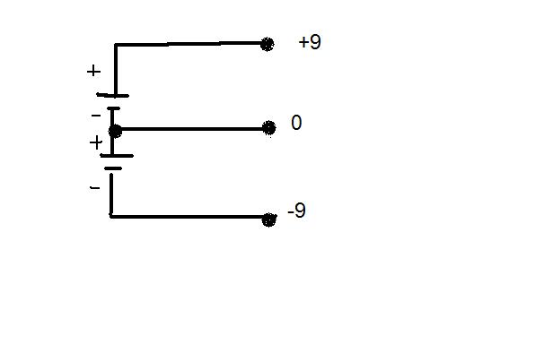

ok thanks for the tips, 2 batteries is a possibility, another noob question how do i pull a negative voltage from a second 9v cell? prefereably without the use of another IC as uni is closed for the weekend and i was hoping to get this running over the weekend
Think in the "inverse". Merely ground the positive (+) terminal of the 9v battery, and run the negative (-) terminal to your -9 volt rail. No need for any IC's...... this is very straightforward. When you do it, remember that all voltages are "referenced" to your ground..... Your + battery gives you +9 volts, while your - battery will give you -9 volts.
Easy one......
Or to draw it,

this is all great info thankyou very much, i have my dual battery supply sorted and am not bothered about power consumption at this stage as its only concept proving. im using a minirator and minilyzer to generate a pink noise test signal, i have gain control and cut/boost control but no filter shaping, i think im making a silly mistake when interperating the diagram, the "earths" on the diagram (white arrows) are where my confuson is, do i connect them to the ground (0v) from my batteries or connect it to the non hot line from my minirator?
