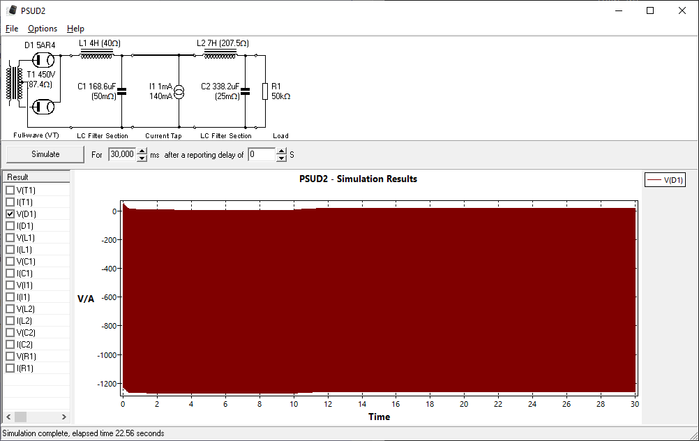

Thanks for the reminder, I do intend to have a voltage divider at output to float the heater, which I intend to double as a resistor bleeder. That said, the value I selected is 360k+120k ohms (2W, 750V limit each) which would drain the resistor over a longer period than the value what you recommended. I did not put this in the simulation because of software limitation.
In general, how much bleed current is a reasonable value?
The software only allows resistive load to be added at the very end, not at the beginning, not in the middle.
It allows constant current load in the middle and the end, not at the beginning
After the rectifier, it only allows C, LC, or RC stage.
I think I figured out where the problem lies.
When I remove the stepped current load, as in the load current is a constant 70mA x 2 right from 0 sec. The PIV does not get beyond 1300V.
So in my earlier simulation with the load current at 2x1mA at 0 sec, the first choke is below the critical H value. So the large capacitor after the choke becomes the input capacitor, and the circuit behaves like a C input. And that C value is way above the 60uF specified in the 5AR4 datasheet.
Now the question becomes, if this warning can be ignored considering 5AR4 will not be conducting before it warms up, neither are the tubes it powers. Earlier I started a thread on this and the answer seems to be that this should be fine in practice?

The software won't do what you are asking. This is the best I can do. Yes the wild rectifier voltage is gone. Even if I use 240k ohm value (my current configuration, 2 strings of 360k + 120k ohms), it has the same effect.
So I can do with or without the capacitor.
