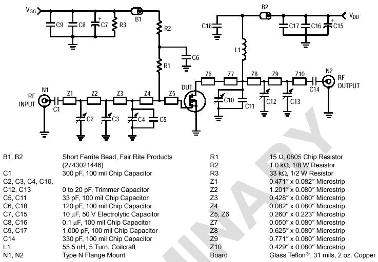

Oh, and here is a pic for eva (see MRF1517T1 datasheet):

Would you, at least, agree that the common practice shown in this randomly chosen picture, which describes the particular way in which most audio related people understand the concept of "stiffening supply rails at high frequencies by paralleling capacitors" is completely useless?
Of course, if you stack two 0603 SMD chip capacitors under an electrolytic and near the load, you are leaving little room for resonance, but this is not what audio people does.

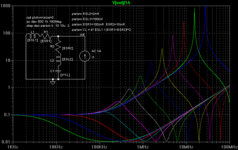

paralleled caps -- simulations
Somewhere in this(?) thread I found the formula for a inductance-cancelling capacitance which read C=L/R^2, R being the series resistance of the net. I could not confirm this formula but derived a slightly different one:
C=4*L/R^2
L is the sum of the wiring/trace inductance and the ESL of the first cap and anything ahead, just the inductive part of the impedance a network analyser would see if the paralleling cap were disconnected. R is the resistive part plus the ESR of the paralleling cap. That cap's inductance is not used in the equation, but shines up as the output inductance. If we tap R right in the middle we get a totally flat output impedance for that point (when ignoring the second ESL here for now, for clarity), if we tap it elsewhere we get some sort of shelving curve for the impedance, but without any peaks/dips. These start to show up as soon as we use a smaller C, bigger C lead to "dips" only. I plotted the derivative of the output impedance also, there the optimum C gives the smothest and flattes rate-of-change curve. This optimum C will get quite large when the ESLs are small, something to consider.
Referring to the attached pic, I set the lumped total ESR and ESL of the first cap plus wiring, source etc to 100mR and 100nH, while the second cap has a lowish 2nH ESL and 10mR of ESR. The second C was calculated as shown above with C=4*ESL/ESR^2, giving 33uF. These values are not necessarily practical and were chosen for illustrative purposes, I'm aware of that. To show the influence of any mismatch from that value, I stepped the C values from x10 to x10µ (lowering the value), in a 1--3.16--10 stepping. The bright red curve is for x1. If the C is bigger there is no problem here but when we decrease it we get strong impedance peaks and dips. The magnitude of the peaks rises with f^2, the Q also gets higher with f. Lowering inductances lowers the peaks, as a tendency.
The formula for C is quite sensitive to R as it is a quadratic term in the expression, also the ESRs are generally ill-defined, depend on temperature etc. So it's quite likely to have a strong mismatch sometimes. We can see we easily have impedance differences of three orders of magnitude. If we happen to have such a tens-of-ohms peak around the GBW of the amp we might be in trouble. Using no parallel cap is more inductive than paralleling but still the impedance is benign. Using the right cap for parelleling improves things, using the wrong one or at the wrong location makes it really bad. I simmed a more complex, real world example (3-pin LDO-reg, e-cap, parallel cap, wiring/trace inductance) and got very similar curves. I think that illustrates Eva's specific point very well.
