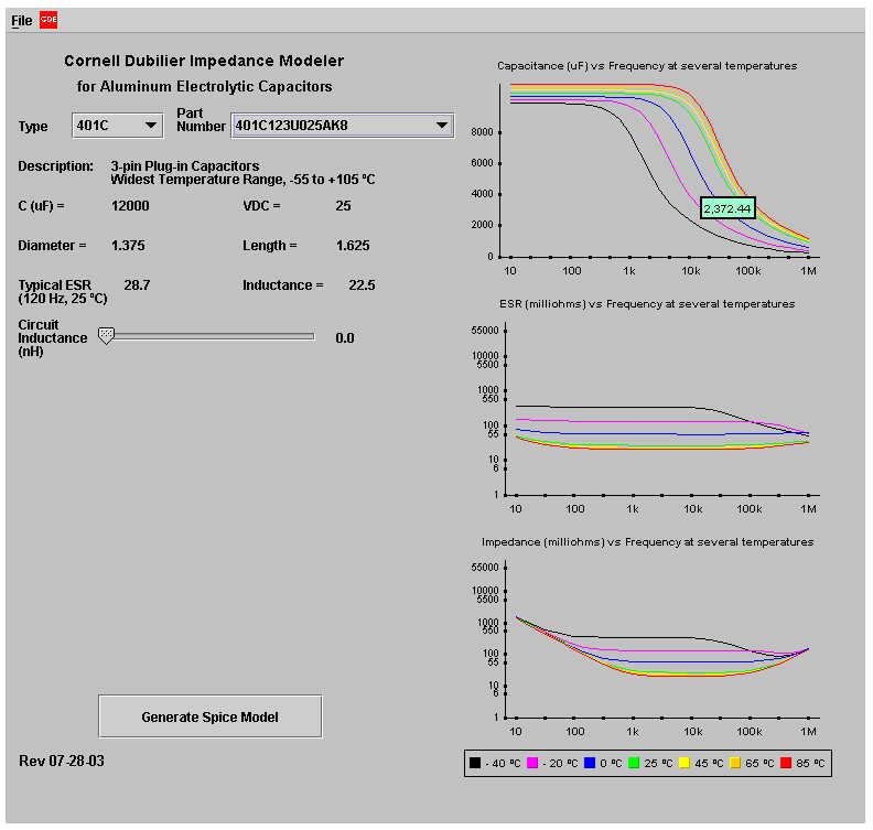

Attached is a screen-shot of the Cornell Dubilier Impedance Modeler applet. (I had to use Alt-PrtSc to get it to copy the screen to the clipboard, in Internet Explorer.)
I had rested my mouse point on the -40degC curve, at 10 kHz, in the top plot, which brought up the capacitance value under those conditions, seen in the little pop-up box on the plot.

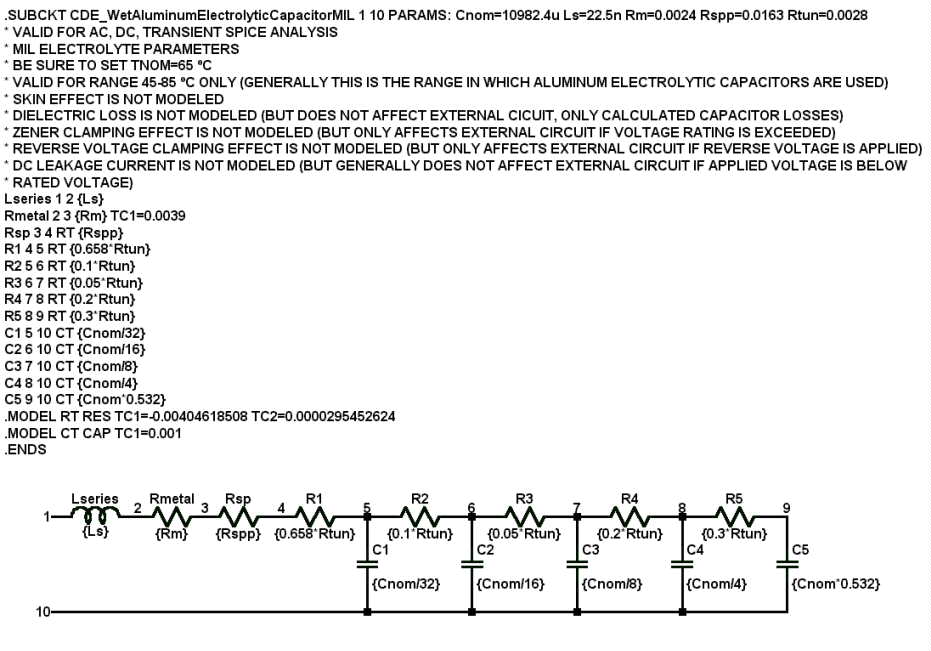

And here is the SPICE model that it generated, for the example capacitor I had selected (12000uF, 25v, 401C series):

gootee said:Attached is a screen-shot of the Cornell Dubilier Impedance Modeler applet. (I had to use Alt-PrtSc to get it to copy the screen to the clipboard, in Internet Explorer.)
Take care with setting the Ls to zero. It is indicating the impossible. In fact if you look to the low impedances of a several k uF then already 5-10nH will start to dominate the impedance somewhere between 10kHz and 100kHz. And as long as we are not able to transfer the geometrie of such large caps into the hyperspace you should consider at least 5-10nH, - even is your PCB is perfect.
Capacitance seems to vary enormously with cap temperature.
Can it really fall by about 50% when the caps are at room temperature cf, 80degC?
Would that explain some of the claims regarding SQ changes as the amplifier warms up?
[First, a little recapping:]
Cornell Dubilier now has this great Java capacitor-modeling applet on-line:
http://www.cde.com/applets/CDEspiceApplet/aframe.htm
This free, on-line Java applet plots capacitance, ESR, and impedance, versus frequency, at several temperatures, for many of Cornell Dubilier's wet electrolytic capacitors (more series are being added, apparently), AND, with a mouse-click, AUTOMATICALLY GENERATES A TEMPERATURE- AND FREQUENCY-DEPENDENT SPICE MODEL for any particular capacitor that's been included by CDE.
These automatically-generated temperature-and-frequency-dependent electrolytic capacitor models work well in AC, DC, and transient analysis modes, in LTspice.
(Aside: Note that whenever I click on the "Impedance Modeler" link at the above CDE link, I always get "Object Not Found", at the top. But everything still works, if you wait for the applet to appear.)
[Now, a little new stuff, about using the models in LT-Spice:]
It appears that they always use the same schematic, for the capacitor model, which I derived from their netlists and posted in an earlier message, in this thread.
With LTspice, at least, you can also create a new re-usable "F-capacitor" symbol (with + lead as node 1 and - lead as node 2, in the .asy symbol file), insert it into a schematic, and then right-click on it and copy and paste the SUBCKT name from the CDE-applet-generated subckt text file into the VALUE field,
e.g. "CDE_WetAluminumElectrolyticCapacitorLV",
and cut and paste the PARAMS portion into the VALUE2 field,
e.g. "PARAMS: Cnom=4301.4u Ls=14.0n Rm=0.0048 Rspp=0.0368 Rtun=0.0055".
If you save the CDE-generated subckt model text file, with the entire PARAMS portion removed from the .SUBCKT line, and then use a .include Spice Directive (.op button) to include it in your schematic, you can then use multiple instances of your new F-capacitor symbol, for different capacitor values and types, just by right-clicking on the cap's symbol and putting the correct subckt name in the VALUE field and the applet-generated PARAM: statement in the VALUE2 field.
To be more clear: You should only need to save ONE copy of the generated spice model text subckt file, as long as you remove the PARAMS: portion of the SUBCKT line (i.e. Remove "PARAMS:" and everything after it, in the .SUBCKT line in the CDE-generated spice model text file, and then save the file with whatever name you want to use in the .include directive in your schematics. Apparently you can also change the actual .SUBCKT name to something shorter or more convenient, as well.)
Cautionary Note/Warning: For now, it APPEARS that the same schematic is used for all of the generated models for all of the CDE capacitor series/types. And although the SUBCKT names are different for some of the generated models, it appears that the only significant differences between any of the generated model files are in the PARAM: statement. However, I have not checked EVERY one of their capacitor types' models. And, even if they are all the same, for now, that may change, in the future. So users should be vigilant about making sure that any generated models do match the single saved SUBCKT text file, if they want to use this re-usable symbol method. (If CDE does later change the model, e.g. different models for different capacitor types or series, you might need to save one subckt text file for each .SUBCKT name they use.)
Also, make sure to read the notes in the generated model file about setting the TNOM temperature parameter. (See below.)

Eva said:Electrolytics used alone are resistive and damped at RF.....
That's a bit confusingly phrased. Anything with physical length has an inductance, so cap + trace has some value of L to consider at some high frequency, even 'perfect' caps.
Mark, I'm sorry, but I have to agree with EVA. Please read the whole thread and also follow the links given. Your incorrect statements, like "Under certain conditions the rails may oscillate for a brief moment. The small caps dampen this tendency", give rise to the assumption that you will benefit a lot from that.
