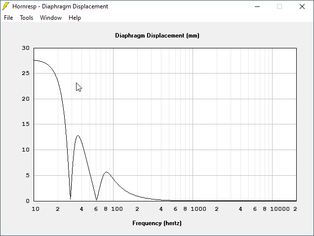

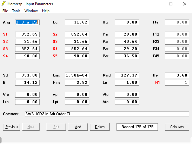

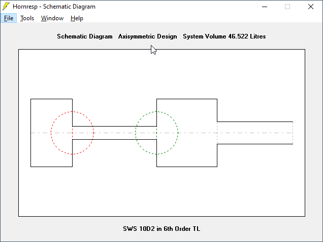

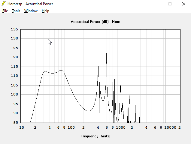

I decided to try that out, and lo and behold, he's right! What a trip: a tapped horn is basically a series tuned bandpass box.
Here's how I tested this:
I made a tapped horn in hornresp, but I staggered it so that:
4) the volume of S1-S2 is equivalent to the back chamber of the series tuned banpass from post 37
3) the volume of S3-S4 is equivalent to the front chamber of the series tuned banpass from post 37
2) the length and volume of S2-S3 is equivalent to the rear port
1) the length and volume of S4-S5 is equivalent to the front port
Once I did that, the response and the impedance curve of this "tapped horn" is basically the same as the series tuned bandpass box from post #37
