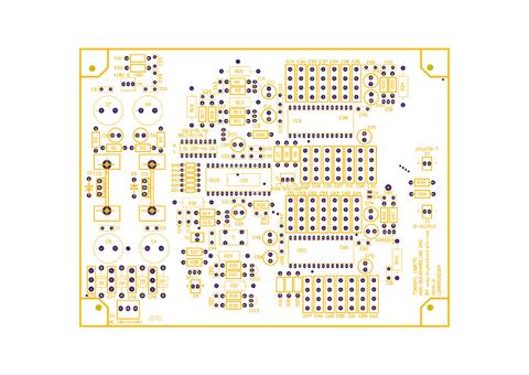

Kuei Yang Wang said:
Konnichiwa,
The DAC has a digital +5V Supply and +/- supply for the "analogue" section. Hence it has two "PSU common" (aka -V in case of positive supplies) pins, which should be used to form independent supply current loops. I really cannot explain it any better, sorry.
I have/had somewhere an expanded set of details, but the -15V and the +6V (in most Philips applications this is 6V not 5V) are the analogue section and there is a corresponding PSU pin, the other PSU Pin and Ground are logic.
To my information -15 is analog and +5 and -5 are digital supplies.
Could be wrong, only read this on the net at some locations.

Hi Kuei Yang Wang,
this is the topscreenof the PCB. CS8414/8412 with parallel TDA1541a only.
any comment to correct??
thanks
thomas
