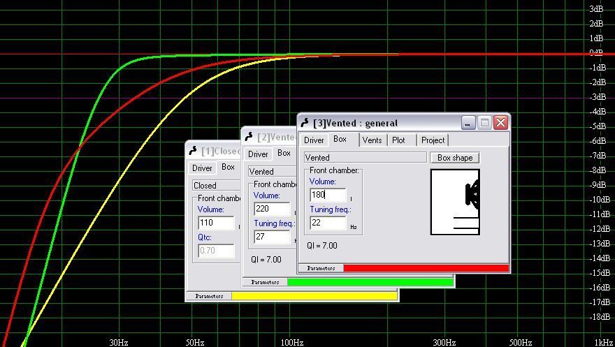

a quick question – the merits of sealed boxes for the woofers vs ported
Sreten pretty much summed it up, except for the difference in sound. I build exclusively sealed box speakers. I do this because when I started, I had read a lot of articles about how much better sealed boxes were than ported boxes. I've never spent time comparing sealed vs. ported in listening tests, so I can't really offer an opinion what sounds better. I might be making things harder than they have to be by building only sealed boxes.
I am currently forced to listen to a pair of store bought ported speakers, and I don't particularly care for the bass. It sounds "hummy" to me.
I would be willing to go as large (for the complete WWWWMTM speaker) as 300mm(W), 500mm(D), 1500mm(H)
If I assume 1.5 inch thick walls all the way around, that comes out to about 4.8 cubic feet. The L21's only needed 1 cu ft each of sealed box volume. I believe it is the same for the L22's. The 8" speakers that Moondog found (good job!) are perfect for sealed boxes and need even less volume. So that size box is just about right.

sreten said:
Vented versus sealed ?
a) Maximum output of a vented box near the port frequency
is equivalent to four sealed identical drivers.
b) Assuming the port is tuned low output in the higher bass
is similar to a sealed box.
c) A vented box is nearly always ~ twice the size of sealed box.
i.e. you could use two sealed drivers in the same box.
d) Drivers with ideal parameters for sealed are : High Vas,
low Fs, low Qts. What really matters is cone mass and the
magnet system. Box volume dominates over Vas, setting
Fbox and Qbox.
e) Drivers with ideal parameters for vented are different.
Vented boxes overload rapidly below the port frequency.
Due to the vent Vbox has no effect so sub port rejection
depends on Vas only, consequently very high Vas and
low Fs is not ideal. Box volume should still be the major
control of the alignment but you want Vas to be around
2 to 3 times larger than the box.
For sealed Vas can be many times larger.
f) For a well designed driver the major cause if distortion
in the bass is suspension non-linearity and they are all
non-linear. Poor ones are also assymetric. Vbox vs. Vas
linearises the behaviour, Vbox approaching Vas or in
some cases I've seen Vbox > Vas is not good practise.
g) Vented boxes are much more efficient (upto 6 to 10dB)
than sealed at low frequencies, this only really matters
with valve amplifiers.

jupiterjune said:
Response and impedence:
This speaker should be around 92 dB@2.83V/M. There is about 6db of baffle step compensation -- meant to be placed well in front of a rear wall.
JJ
attachment.php
Ok, I understand this graph now (I think 😕 ) I don’t have access to my Cookbook where I am ATM, but some musings anyway.
The midrange and tweeter will have +6dB sensitivity as they operate above the baffle step (speed of sound / enclosure width), so you need and extra +6dB from the woofers.
This would make good use of half the +12dB gained from the quad woofer array. Yes?
Suppose I use four of the TIW 200 XS sub woofer drivers for the WWWW in a 100L sealed box:
http://www.soundlabsgroup.com.au/p/V-1340-TIW200XS/TIW+200+XS+-+8+Ohm
These are rated at 84dB (1W/1m).
4 in parallel gives +12dB, so 96dB total sensitivity.
So, assuming a baffle step of 6dB, the midrange and tweeter sensitivities would have to be 90dB (1W/1m)
This seems acceptable. For instance the midrange linked to by Moondog55 in the post above.........
http://www.audiomarketplace.com.au/...d,0/option,com_virtuemart/Itemid,49/vmcchk,1/
….. is rated at 97dB half space (1W/1m). It also has a sufficient power rating. It is expensive, but not so bad if I can get away with just one midrange driver.
A couple of quick Qs:
If my enclosure has a width of 0.3m the baffle step will be at 343/.3 = 1140Hz.
This is significantly higher than the previously suggested bass crossover (~500Hz). Is this what I want?
The midrange driver sensitivity of 97dB is specified at "half space". The woofer sensitivity at 84dB is not. Are the two figures directly comparable? If so, is 7dB an excessive amount to pad down the midrange, making a lower sensitivity unit a better option?
Glen

All speaker senstivities are quoted into halfspace.
Baffle step for a 0.3m width will be all over by 1kHz.
(Seas data sheets are worth looking at. They show bass drivers
measured in real boxes, the baffle step is very evident, as is
the bass vs midband sensitivities)
An approximation for the BS midpoint is 1/3 of a wavelength, but
this does to a degree depend on trhe form factor of the baffle.
~ 90dB/2.83V is a perfectly sensible target, the numbers do stack up.
Now for the bad news ........
4 8" drivers in a vertical array crossed over high will not sound good at all.
You will have lobing issues and more importantly inconsistent
dispersion or power response into the room. The array at higher
frequencies will tend towards a line source where level falls
off inversely to distance, whilst at lower and higher frequencies
dispersion will tend towards a point source where level falls
off inversely to distance squared.

Attached some quick modelling of 4 Visatons.
Note the green vented rolls off faster than the sealed yellow.
The red vented rolls of slower than sealed and should match room gain.
