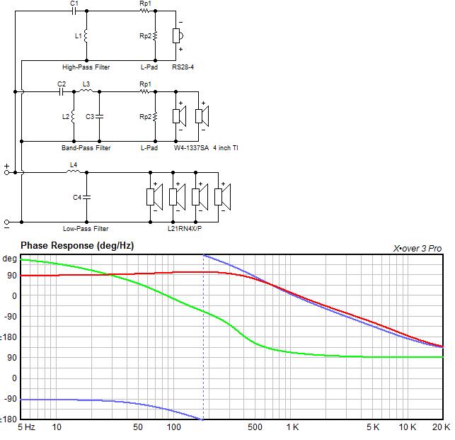

I think your idea of using one coil per driver is going to be fine. The only drawback I can see is if you need to fine-tune the value, then you need to do that FOUR times, which will be annoying. Perhaps settling for two larger 8ohm drivers really will be better, I just don't know how much you want to be pushing the amp, as it might end up sacrificing sound quality if you can't find passive components worthy of the end goal. Another idea here would be to mess with one large coil, then when you're set on the value after listening trials and measurement you can replace it with 4 coils - one for each driver, to minimise the DCR and distortion. You may have to allow for the fact that altered resistance will shift the crossover point and efficiency of the bass part.
The caps will be inexpensive as you say, it requires no debate, especially considering your budget.
The hardest part of this project might end up being the cabinet, which will want to be solid, but also inevitably large, and you need to have a good height for your mid(s) and tweeter. If chosen carefully there's no reason these can't match your woofers for sensitivity. Usually we need to pad the tweeter and mid down somewhat.
You certainly don't want to pad the bass drivers down, as damping factor is considered very important for excellent bass reproduction. And throwing power away more than you're going to have to do already is not on.

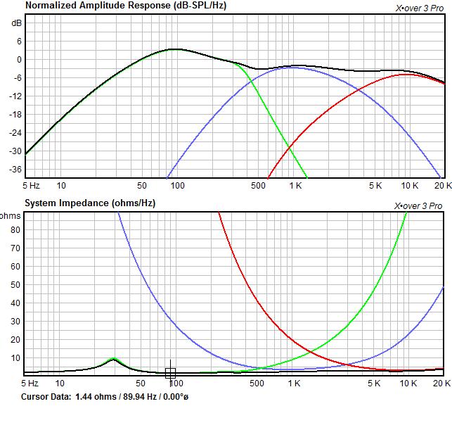

The possible need to fine fune multiple inductors really doesn't phase me (that's only a little labour in the whole scheme of things) and I agree that the cost (and physical size - what the?) of the capacitors isn't something that should be debated at all. It's a truly trivial expense in a project of this scale.
It has been declared here that such a project is unfeasible due to the demands that a low impedance / high current speaker design puts on the crossover components. I think that this is a complete red herring.
With seperate passive crossovers for each woofer, the demands are not any different at all from a much higher impedance, conventional design that only uses one woofer. The only real demand is that placed on the speaker leads!

However, a line array with 4 woofers still seems the way to go.
My amp has enough capacity to drive two such speakers connected in parallel per channel! There will be plenty of reserve with just one pair.
The issue of loudness has been brought up again. I think the HiFi merits of a competent line array reach well beyond the sole objective of obscene SPL, which is not a priority objective of mine (I have stated this already, but someone is blissfully ignoring it). I am not building a PA system. I am building a deliberately OTT HiFi system to cope with high dynamic range material.
Anyway, with a nominal impedance of a little under 2 ohms and over 400W RMS per channel to drive it, I don't think I'm going to have much of a issue WRT high SPL. 🙂

Ahh ok, and now I realise what you were getting at - a lower impedance speaker actually requires a smaller coil - great! I just assumed it was the other way around, as with caps.
That solves the inductor problem then. Something good could be used e.g. Mundorf "feron-core" 0.82mH has a DCR of 0.06R - a splendidly low figure. And not a problem on the budget if you only need two: maybe around $130AUD.
That is still a little steep!
Seriously, if I was after a really low DCR inductor, I would just wind my own.

Actually 0.06 ohms DCR is an extremely good figure for a crossover coil.
Remember that the DCR of speaker drivers is actually a parasitic parameter. It does not contribute in any way to sound output. Voice coil DCR is high because the coil must be small and lightweight and the current must travel around the field gap many many times in order to get a decent BL factor and some efficiency, thus imposing a limit on magnet wire thickness. Yes, voice coil RDC in speakers is absolutely parasitic, it works exactly like an external dummy resistor connected in series with a speaker having an ideal 0 ohm voice coil.

If 2 ohm nominal speakers are wanted, that is easy but suitable
driver choices will be restricted compared to 4ohm / 8 ohm.
Controlling senstivity is also easy, especially with isobaric bass loading.
What is very difficult is making a high quality design to the correct
requirements without getting it horribly wrong, even though to
the technically challenged there seems to be nothing wrong with it.
2 ohms nominal means ~ 400W program (not RMS) power handling.
It is quite a lot but relatively do-able, 200W program (i.e. typical
music with a small % of clipping on peaks) can be handled by e.g. :
http://www.rjbaudio.com/AlpheusMkII/alpheusmkii.html
Obviously the programs crest ratio, peaks to average, will determine
whether the 200W / channel blows a driver or not, FWIW the LS3/5A
was shown years ago to be able to handle 1kW transient peaks.
(obviously not in the bass)

just calculated the DCR and inductance of a big coil.
for 0.75mH and DCR~=0r065 requires 1.91kgs of 3.1mm diam copper wire wound onto a 66.8mm diam 31.8mm wide former resulting in a coil with an overall diameter of 124.1mm using 94.8Turns.
2kilos of enameled copper wire will cost about £20.

Or alternatively slap a proper core in the inductor.
It is simple, a 2 ohm speaker will need ~ twice as big inductors as 4 ohm.
So what ? the same is true for 4 ohm versus 8 ohm, no big deal.

4 x 8" 8 ohm woofers or 2x10" 4 ohm woofers - there not a lot in it.
I've always liked the basics of this design :
http://www.stereophile.com/floorloudspeakers/147/index.html
Force cancelling of the bass drivers is an appealling idea.
MTMing the front is easy enough. So is doubling up the bass drivers.
some numbers :
Say the TB titanium drivers and a ribbon for the MTM, as used here :
http://www.htguide.com/forum/showthread.php4?t=28728
The midrange will be nominally 85-87 dB/2.83V (4 ohm)
(See Zaphs specs for the TB at Zaphaudio .com)
This is because the MTM must include the baffle step : 4dB to 6dB.
http://www.madisound.com/catalog/PDF/neocd3.pdf
The treble will be padded back to the mid and high impedance,
consequently actual "power handling" will be very much higher.
This leaves the bass section which depending on the amount of
BSC needs to appear to be around 91dB/2.83V, that is into
half space whilst in fact it is full space and around 85dB.
Lets say the bass is 90dB/2.83V to allow mid/treble adjustment.
Enter the laws of physics regarding box size, bass extension
and efficiency, noting you need decent cone area and excursion

Here is quickie of how it might work......
C1 = 7.543 µF, Polypropylene, 0.00588 ohms
C2 = 55 µF, Polypropylene, 0.00209 ohms
C3 = 6.295 µF, Polypropylene, 0.00642 ohms
C4 = 400 µF, Polypropylene, 0.00137 ohms
L1 = 0.274 mH, Air Core(#16), 0.282 ohms
L2 = 2 mH, Air Core(#16), 0.477 ohms
L3 = 0.5 mH, Air Core(#16), 0.28 ohms
L4 = 1.5 mH, Air Core(#16), 0.434 ohms
BPGain = 3.186 dB
Tweeter
L-Pad:
Rp1 = 1 ohms
Rp2 = 12 ohms
Midrange
L-Pad:
Rp1 = 2 ohms
Rp2 = 100 ohms
JJ
