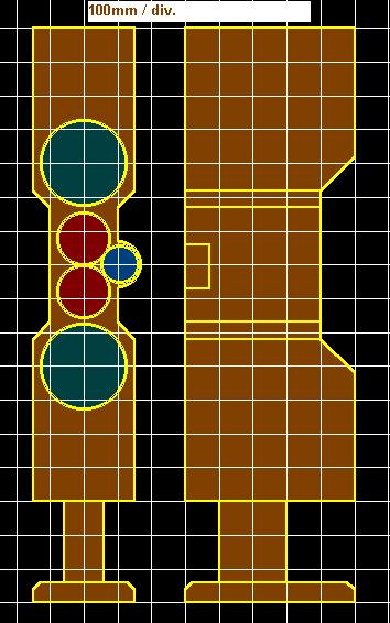

inertial said:Glen,
I suggest you a more conventional single mid . Maybe a model with
huge voice coil 2" or 3" better .
Imo you can also take inspiration by the old B&W 802 matrix, large
baffles rarely image good .
Just my 2 cent

AndrewT said:if all those other designers can get MTM to work then why can't we have similar?
All MTM's have lobing problems.
And I don't necessarily want to do what what everyone else is doing.
SimontY said:Glen,
Although I'm no expert here, my gut feeling is that by using two midrange drivers in this way you're reducing distortions that weren't necessarily in need of improvement, and introducing new distortions, higher cost and increased complexity.
Simon
I dunno. 1/4 the voice coil power and 1/2 the cone excursion with a series connected pair isn't something to pass on lighlty. Zaph on his mid-range driver test page makes comments WRT this advantage when MTMing in series.
The midrange driver is very important to the quality of the overall system and the LDC has a chart showing some pretty eye popping changes (for the worse) of driver paramaters with not much voice coil heating for an average driver.
Anyway, I just deleted one $400 woofer from the design, so I can absorb part of that with another mid-range driver 😀
Glen

Glen,
Nice towers, but I am with Simon , 1 midrange, the best you can buy.
Moreover, put the second wf in TMWW mode.
Voice coils aligned vertically (like B&W) is good.
Separates cabinets ( decoupling mechanical each of the others)
External Huge x-overs ( facilitating the modds) 😀
just my personal preference.
Paolo

B&C 6NDL38...it has a short ring and may be even better than the 6MD38 tested by Zaph....personaly I would prefer harmonium surround
To rehash all of this into a single sentence again, why not do 3.5 way with BSC in the midrange? TMMWW or TMMWWW... or simply 3 way TMW (too ordinary?)
The benefits of the first suggestion (3.5 way) would be:
* only one, small, upper mid driver, therefore matching dispersion of the tweeter nicely
* secondary mid to perform BSC and reduce excursion in the lower midrange / upper bass
* multiple woofers crossed over low so their size, quantity or position is less critical
I don't see why you deleted the third woofer to be honest, nobody said it would cause real harm. Spreading those out will have some benefits as well as the drawbacks that B&W cited, and that of cost and size.
To be different, use sound, well-known principles and make the construction and crossover a masterpiece. The speaker will be unique and should be quite stunning after all's said and done. You can consider novel techniques for decoupling the top and mid drivers (magnet clamp holding the driver?), and as Paolo just suggested even decoupling the cabinets for top/mid and bass or even separate bits for all three (as long as you can keep the tweeter and midrange unit close).

Hi Glen,
Lobing issues can be audible if you bob up and down to detect them, but whether they are an important issue when you are close to the tweeter axis is most debateable.
If the tweeter is between 'mids' having different characteristcs, say one upper mid the other lower mid or upper bass, I feel you will get more noticeable sound lobe than with D'Apollito.
Mid drivers in series are not subject to the same series connected errors as LF drivers. I would normally fit equal value damping resistors across the terminals of each series driver anyway.
Can I suggest you make a cardboard box mock up to try the alternatives your well stocked driver cupboard will permit before you make any decisions about cutting.
Cheers ...... Graham.
PS. Read up on Joe's Elsinore project, also here at diyAudio.
