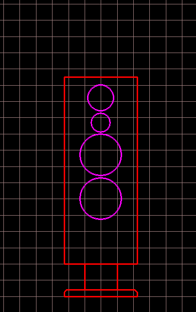

Three of Scan-speak’s 23W/4557T00, 9” high-end woofers in parallel per box will give me 92dB SPL (2.83V/1m) with an F3 of 31Hz with a Qtc of 0.7 in a sealed box of only 100L (before stuffing).
With no BSC? two drivers in parallel gives +6db, 3 gives +9.5 or so. I know BSC is rarely mentioned in commercial design information, but I think almost all have it, unless they are designed to sit right against the back wall.
I am sure as you look all the different drivers available out there, you are running smack into the unbreakable Laws of Physics. Low Fcb in a small box always gives low sensitivity......higher sensitivity requires a bigger box.....
I spent a long, long time looking at many, many, many drivers for use in sealed boxes trying to figure how to "have it all" (and still not go below 4 ohms -- one restriction you don't have to worry about). I finally decided I would have to build huge boxes if I wanted to achieve that goal.
I am still following this thread with great interest. I still plan on running the simulation mentioned previously, just had a busy week dismantling base camp and driving 1300 miles home.

G.Kleinschmidt said:The bass enclosure will be 0.45m wide, producing the baffle step at the bass-mid crossover of 250Hz.
I prefer to do the baffle step at the bass crossover because that keeps things simple and affords me ~6dB headroom in the SPL requirement for the mid-range driver and tweeter.

The Scan-Speak woofer has a 2.83V/1m sensitivity of 83dB, so ~92dB with three in parallel.
A agree that the only way you can have your cake and eat it too WRT to sealed bass enclosures is to go well below a nominal impedance of 4 ohms.
I'm in a position to do this, so it is why I'm pursuing this path ATM. And that 9” Scan-Speak woofer does a critically damped 31Hz f3 in a ~35 litre sealed box, which is pretty good for a 9” driver – and it has a linear cone excursion of +/-13mm with an Xmax of +/-20mm.

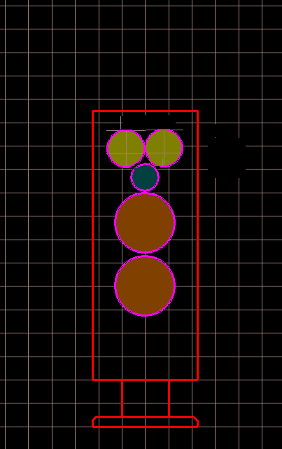

Thanks for this post. This hasn't been mentioned before and there is a lot to absorb here.
With three 9" bass drivers in a WWWMT arrangement there will always be an issue with one bass driver being rather close to the floor. I don’t know how much of an issue these floor bounce effects will be in practice, but I guess a safe bet would be to delete the bottom bass driver, which would only come with a marginal sensitivity loss of ~3dB.
WRT to baffle step correction, I’m not overly fussed if I come up with a design that is theoretically less than perfect. If the average midrange and treble response deviates by + or – 3 dB or so from the average bass response, I feel that this is something easily rectified with a little active equalization if desired. When speaker placement / bass reinforcement / etc issues are drawn into the equation the effects of baffle step seem small in comparison. Well, as far as I can tell at this stage anyway.

Glen, the woofer closest to the boundary should have the flatest response due to it having the least delay for the reflection. Think of the floor as a reflector and then you have 3 drivers also below the floor. You can actually simulate the 3 real drivers and the image drivers in CALSOD, I believe that this is covered in the manual. Still, often room modes have more influence than the one boundary so it is questionable if the in room environment is ever really 2pi. I find that large systems that can handle the full boost of BSC often sound best with a full 6 dB but it does depend on many factors.
Note that Revel uses 3 woofers in the design I linked above, you might want to have a look at the measurements in that article.
Hi.
Glen

Thanks Jack
I like the idea of 2 woofers on each side, but that is starting to really stretch the budget 🙂
I guess the most sensible option would be to delete one of the woofers.
Maybe even a WWTM layout instead of a WWMT?
With the tweeter, at a height of, say, 45", the lower of the two 9" woofers can be kept well off the floor and with a bass crossover at 250Hz the midrange-driver centre can still be kept at about 1/3 wavelength from the centre of the lower woofer.
Glen

Hi Graham.
I really like the idea of an MTM with the mid-range drivers connected in series. That gives you the same mid-range SPL, but only 1/4 the power dissipated in mid-range each voice coil and half the cone excursion. That can only be good for linearity and fidelity at high SPL’s.
However I don't like the lobing issues of the MTM. Also, adding the extra M between the WW and the T shifts the WW closer to the floor, and the top M is then even further away from the bottom woofer.
If I were to implement two series connected mid-range drivers while avoiding the MTM lobing problems, I suppose that both mid-range drivers would have to be mounted as close together as possible.
However, a mid-range driver generally needs to be as close to the tweeter as possible.....
.....so how about the outre........
MM
T
W
W
........arrangement as shown in my drawing attached?
I’d really appreciate some thoughtful comments on this. Feasible? Or more issues created than alleviated?
Glen
