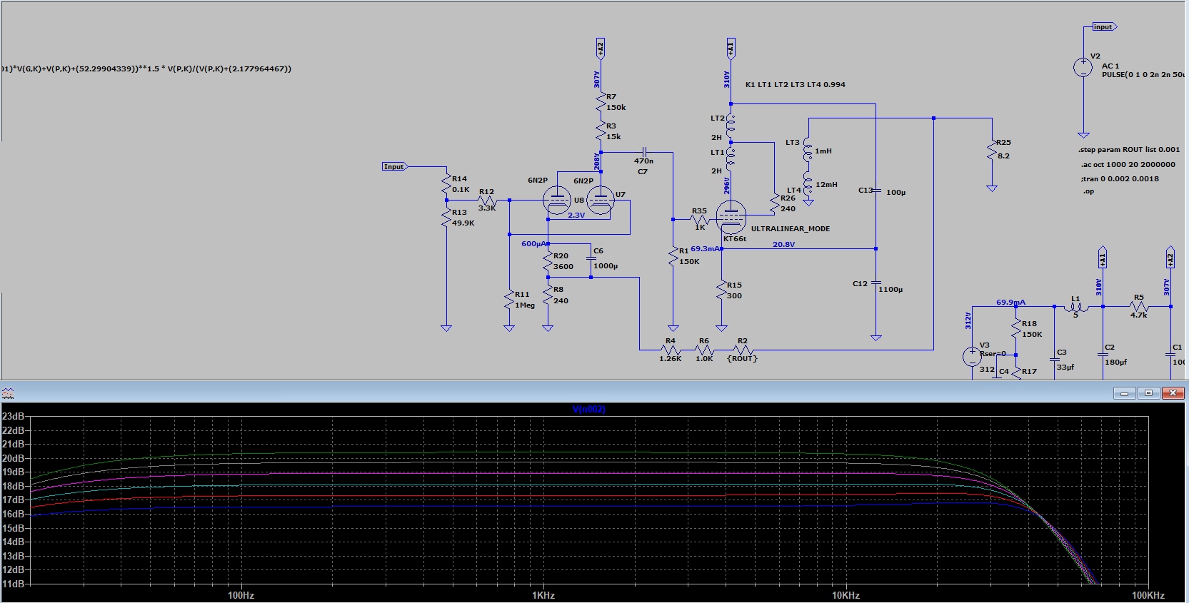

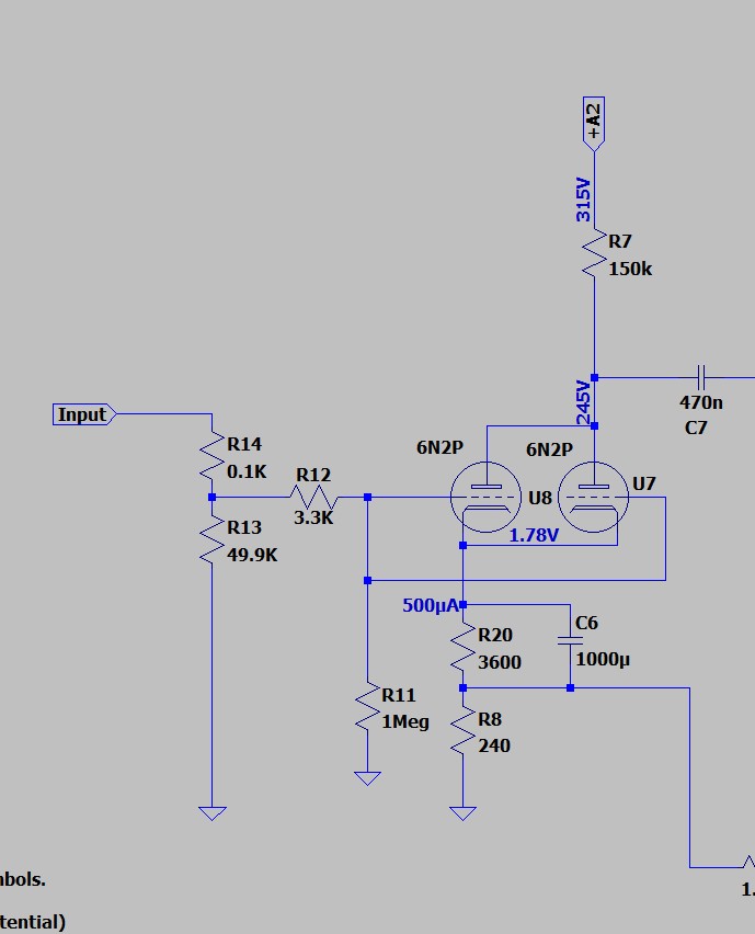

Hello, I'm tesing a common chatode resistor of around 3-4 kohm with 500uA current (250uA bias per tube) and I like the sound in my parallel configuration.
Measured distortion is not so bad, but I'm using heavy GNFB and the resistor is bypassed by a cap.
I have 315V++ with 150Kohm common plate resistor. Plate voltage is 245V.
I don't see schematics with such low bias (even with just one tube and 6-8K cathode resistor), and I'm looking for similar solutions and possible issues.
Is the negative grid voltage in part created by gridcurrent biasing? What is the value of the grid resistor?
I ask this because with a 4K cathode resistor passing 0.5 mA you would get Vk = 2 V (or Vg = - 2 V). Looking at the datasheet for the ECC83 (and the curves for the 6N2) one section would pass about 1 mA at Va = 245 V and Vg = - 2 V , so the two sections would pass about 2 mA instead of 0.5 mA.
Attached working simulation.

ygg-it,
You have connected the plates together.
You have connected the cathodes together.
You have connected the grids together.
If you have any oscillations, try a couple of individual grid stoppers in the grids.
And I hope the plate currents are roughly equal. Otherwise the distortion may be a little bit high.
Only way to tell are with precision small value resistors in the plates, or or small value resistors in the cathodes
(I prefer the current sense resistors to be in the plate circuit, the same value of resistance will not disturb the circuit performance).
Measure the voltage across the resistors with a sensitive DMM, to check the current balance. If the current balance is bad, try another tube.

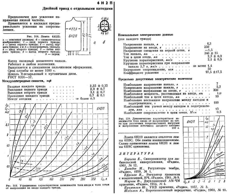

OK, than your tube under test seems to contradict its datasheets...
Addition: Here's a datasheet for the 6N2. Look at what current one section will pass at Vplate = 243 V and Vg = - 1.78 V.
Ok I have done measurements and may be plate voltage is little less than simulation, but the cathode current is really 0.5mA-0.6mA split in two, so each tube is really biased "cold" at 250-300uA, as simulation states.
So question stay the same: why I don't see schematics with such low bias current, i.e. with very large cathode resistors (some Kohms), since they sound pretty good and give me much higher input headroom?

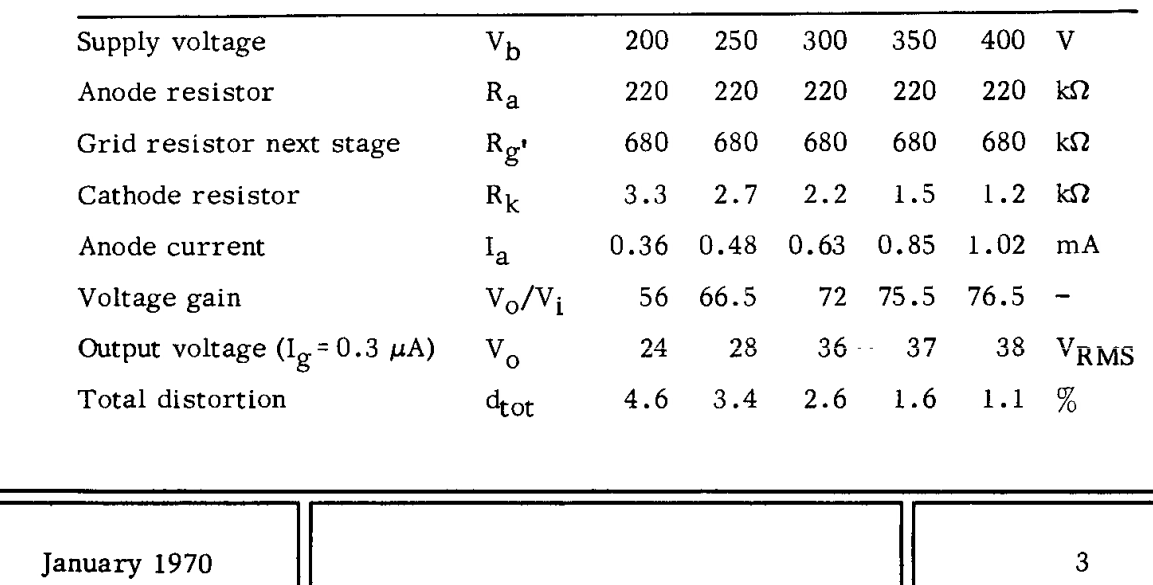

The answer may be quite simple. They tend to follow the recommendations in the data-sheets of - e.g. - ECC83 from philips.
For 1mA plate current, THDistortion is given as 1.1%
at 0.36mA, THD quadruples and reaches 4.6%
Thats for one triode.
If you like your setup, well, thats your personal choice. Most others opt for lower distortion, as it seems.

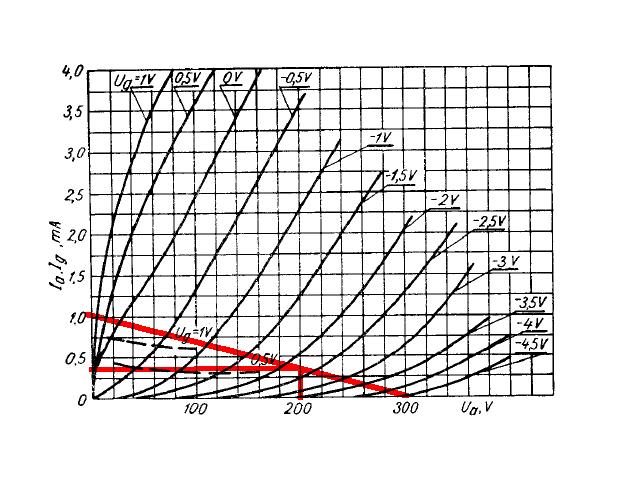

So now there's 0.6 mA passing through the common anode resistor of 150K. That gives a voltage drop of 90 V.
The voltage drop over the common cathode resistor now is 0.0006 x 3840 = 2.3 V.
Your B+ = 315 V, so the voltage between the cathodes and the plates = 315 - (90 + 2.3) = 222.7 V.
Looking at the curves in the datasheets, one section passes about 0.5 mA at Vplate = 222.7 V and Vg = - 2.3 V, so the two sections together would pass about 1 mA at this Va and Vg.
So I'm still having a hard time to understand how your simulations and/or measurements are possible.
Interensting table thanks! But I think that with heavy GNFB which I'm using, this is not valid anymore. Strange infact that rising the cathode resistor I'm getting less or almost equivalent overall THD (measured)!

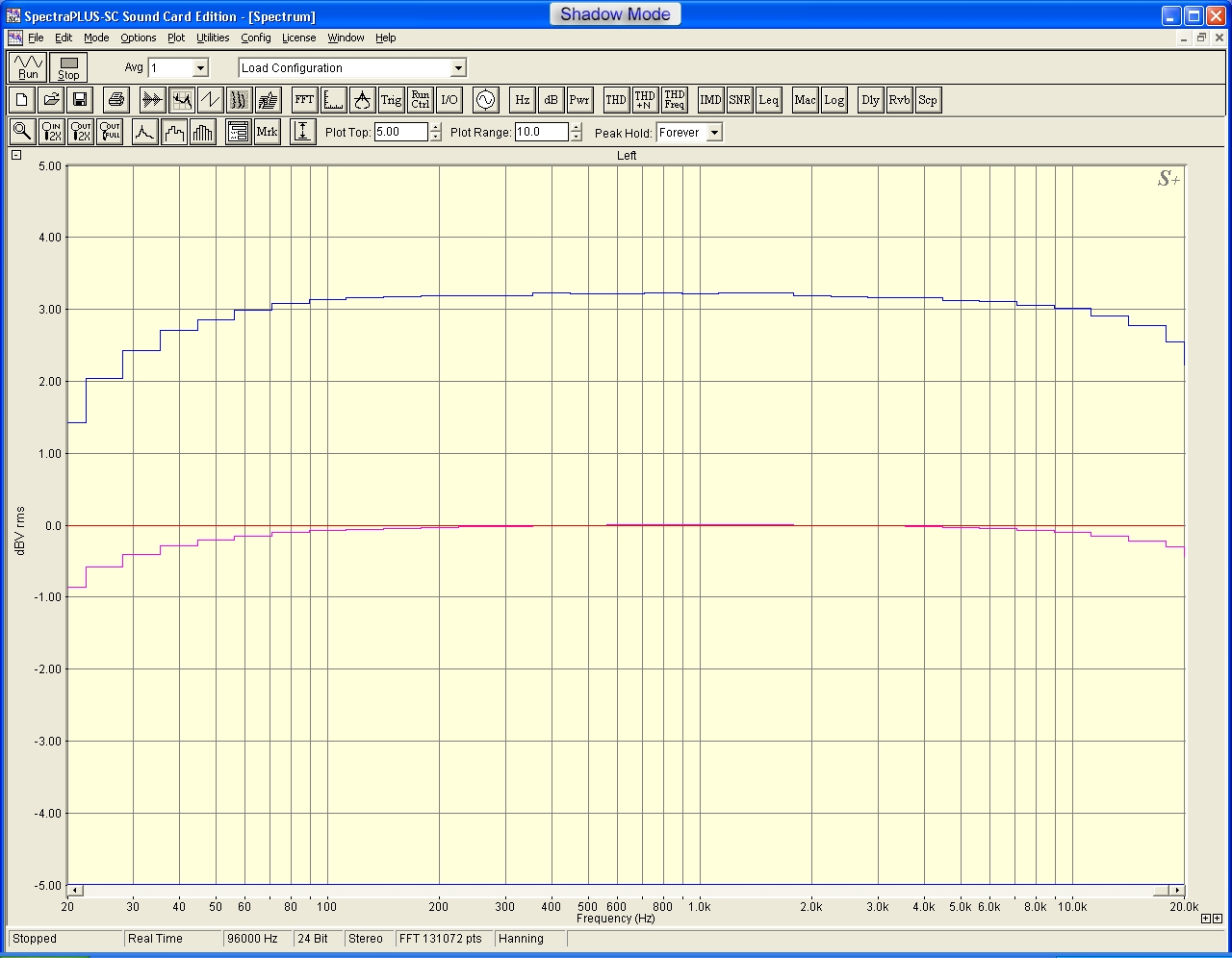

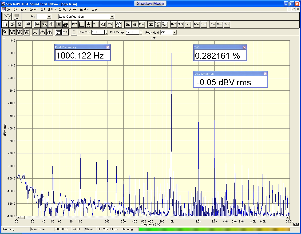

My apologies, :worship: you were right! I had an hidden DC voltage at the input signal which biased the triodes in absence of the DC-block cap.
Now the correct simulation mirrors my voltage measurements like a "swiss clock".

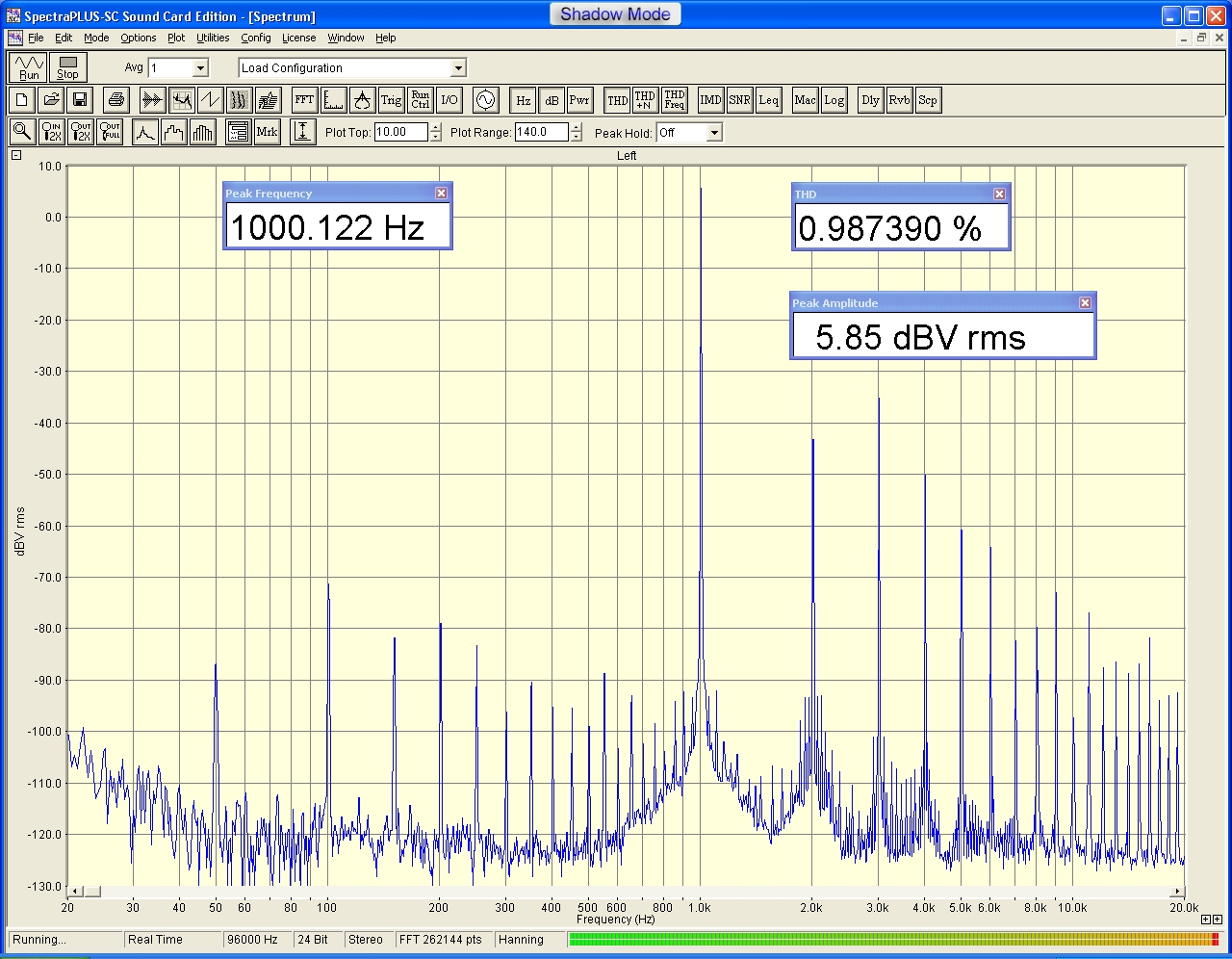

On 8ohm resistor load:
Measured THD
0,28% THD = 1W
1% THD = 3,9W
5% THD = 5,5W
Meas freq response (with PC soundcard and Digital wav files).
20Hz (-0.8dB)..20KHz (-0.4dB) with full GNFB in pink colour
IMD 60-7KHz: 0.25%
