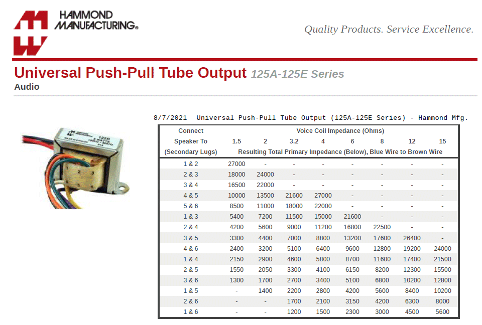

P-P, Hammond 125E
SE, Hammond 125ESE

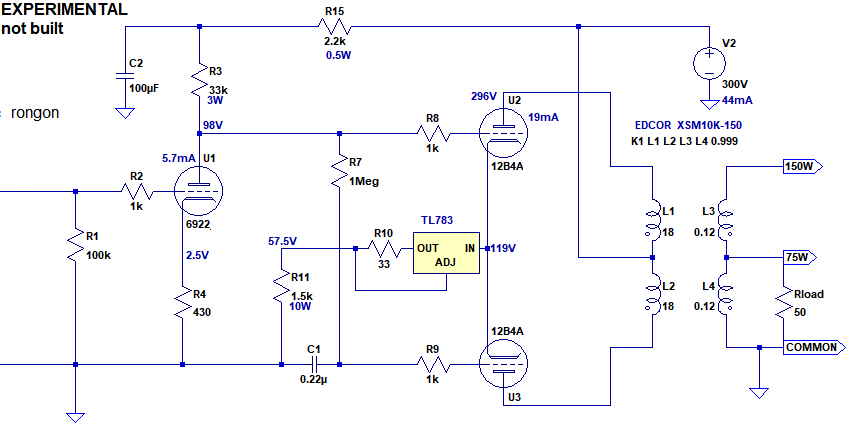

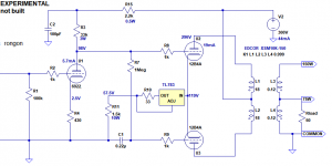

Would be fun to experiment with a headphone amp made with a push pull pair of 12B4A for the outputs. What is the primary inductance of that 125SE?
Could even make it DC-coupled by making a LTP out of the 12B4A's using a CCS from joined cathodes to ground, driving that with a simple common cathode amp stage.

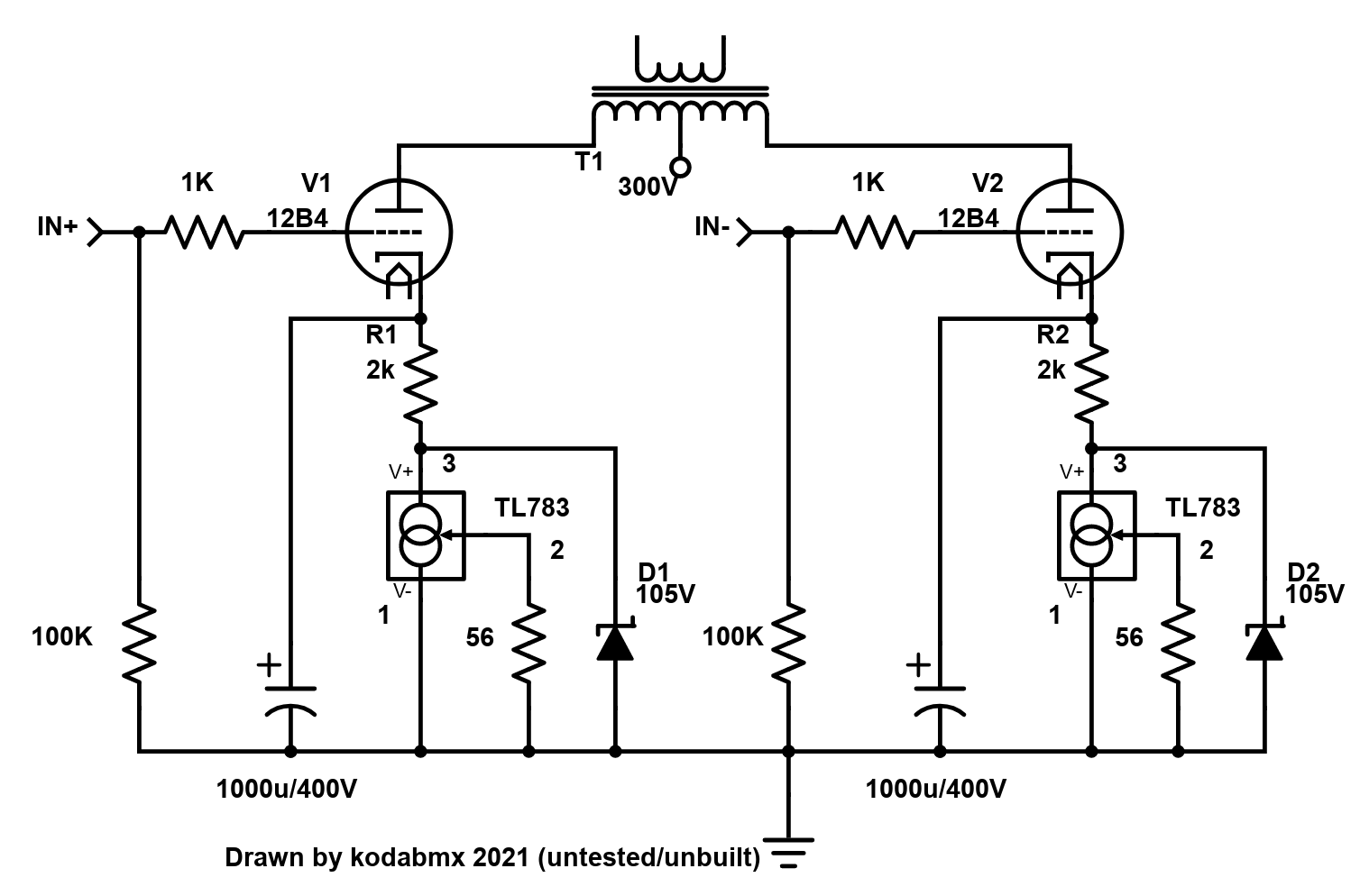

I don't like how close to the limit that TL783 is... Why not offload some of the voltage to a resistor (in series with the cathode and TL783)?
Better yet, give each tube it's own CCS (bypassed with 1000uF) to allow for mismatched tubes?
I added zeners to protect the TL783, and HV caps to protect against a tube failure (arc).

First off, you can't use a separate CCS for each 12B4A. In this circuit the two 12B4A's are also the phase splitter (it's a long tail pair) so the cathode loads have to have as high impedance to AC signal as possible. Bypassing the cathode loads takes away the AC impedance to the cathodes, so the two 12B4A's will no longer act as a good phase splitter.
As for using the TL783 at all:
R11 1.5k 10W wirewound drops 56V so the TL783 has about 60V across it. It's rated for up to 125V. Or is the problem heat dissipation?
60V * 0.04A = 2.4W
Will require a good heatsink, but would work. OK, but fair point. It's not the best thing to use there. I'll try again.

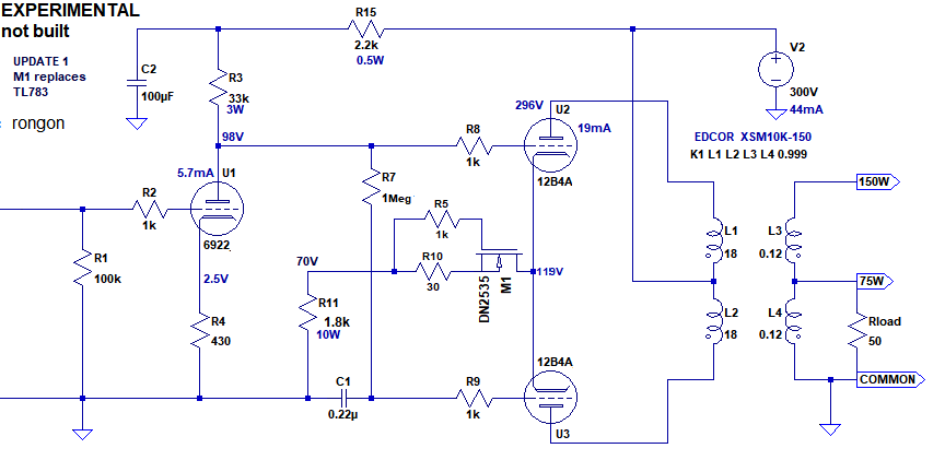

How about a DN2535 MOSFET CCS? That works. Change R11 to 1.8k 10W so it drops 70V, leaving 50V across the MOSFET which will dissipate less than 2W, which means it will only need a good clip-on heatsink.
Or just replace the whole CCS with a single 3.3k 10W wirewound resistor from the 12B4A cathodes to ground (120V/3300R = 0.036A). THD will be lot higher, but it will be more 2nd harmonic than 3rd.
