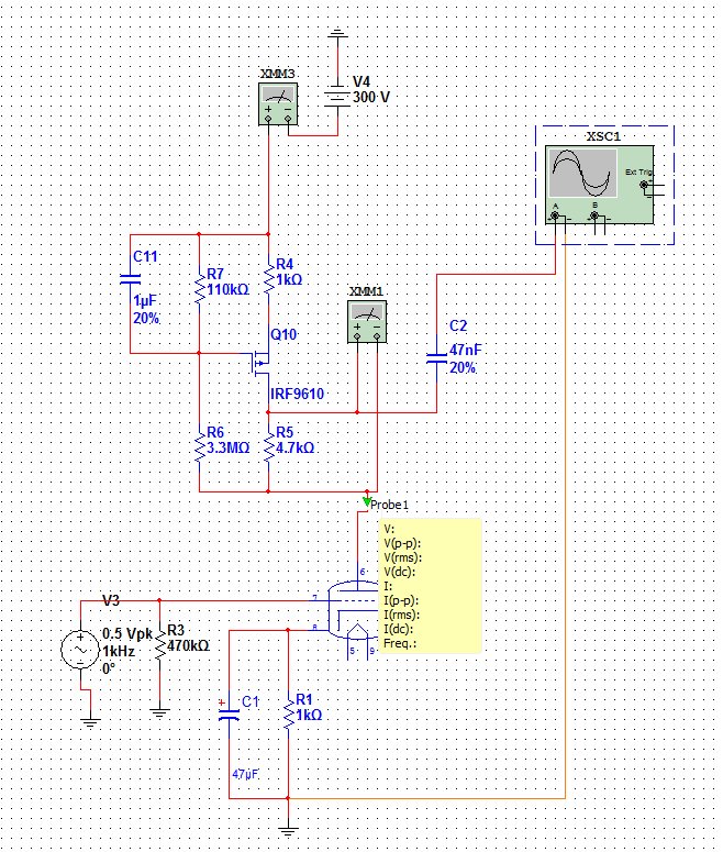

I have done the gyrator like this, it sounds wonderfull, a lot less harsing then ccs in my case, I have keeping the CCS for the cathode follower who will be changed for EL34 to drive the mosfet gate capacity, EL84 is now in it.
I see that calculating a gyrator is difficult, I have only change R5 R6 and R7 for tube idle of 1.2mA and 155 volt across the tube, higher idle did,nt work nicely the sound get very harsing.

Why did you take output from the upper leg of R5, instead of from anode?
Yes I see, it is drawn wrong in schematic as a testing purpose, I have in real live tapped from anode, but maybe it is nice to tap from source for low impedance driving a EL34 to drive multiple mosfets.
regards.
No, source does not have AC that you can use. Better take it from anode. R5 is needed for compensation on very high frequency end where capacitances of MOSFET start playing role.
Ahh oke thank you, I have it on anode but have plans to make a extra cathodefollower with this double triode to drive the EL34 later on, I have a free section left, I have because of the low current of the ecc803 where it sounds so relax that the mosfet hybride is like almost a real tube amp (but not completely this will never happen but close), the idea to change the fet for a low current one, so capacitance are low like the ones you already use, I live in the netherlands so parts from phillips is not a problem.

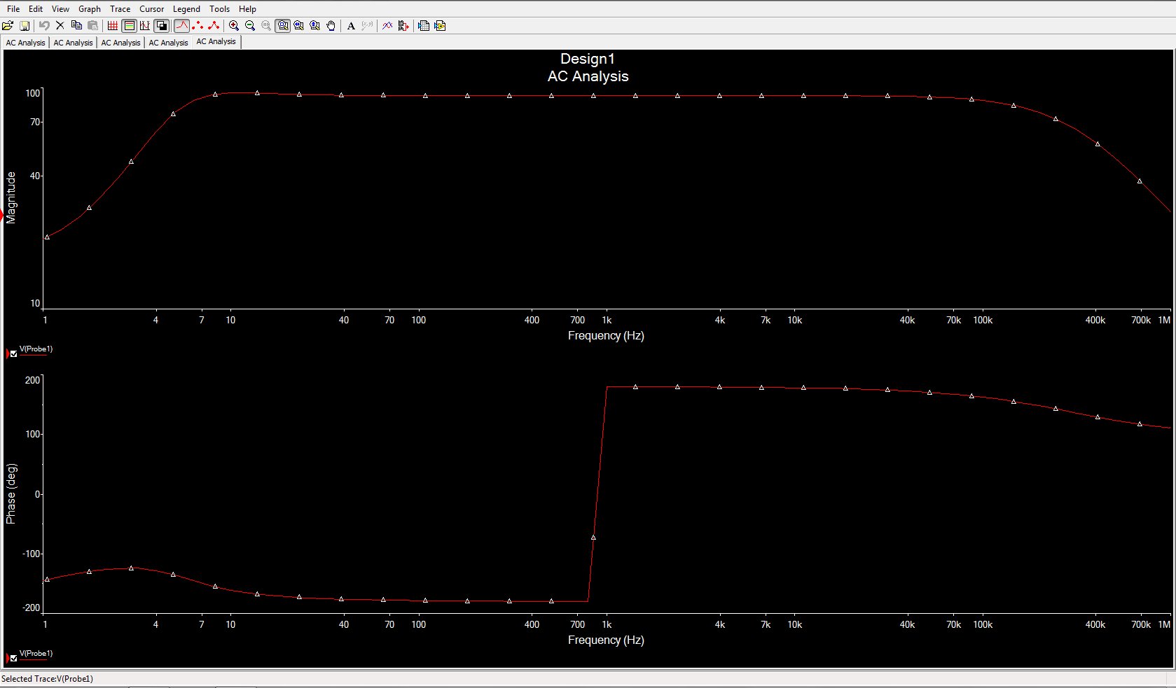

I don,t understand the fase shift around 700 hz on the ac analyses picture maybe it is not 100 procent perfect simulation, it never be but sometimes very close. .

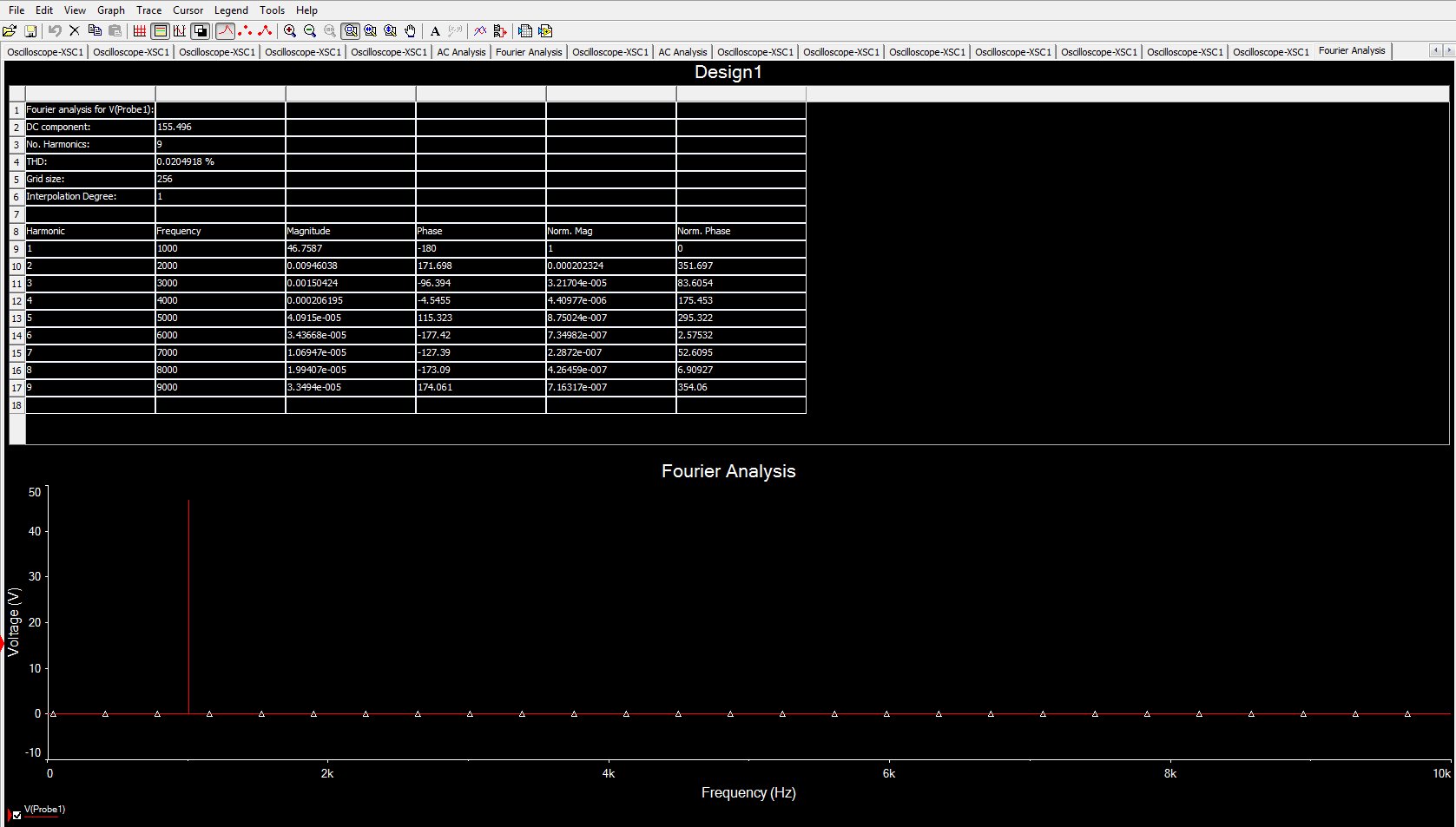

see pictures

see pictures

What is the purpose of R5?
like Wavebourn says, R5 is needed for compensation on very high frequency end where capacitances of MOSFET start playing role.
Some kind of degeneration resistor?

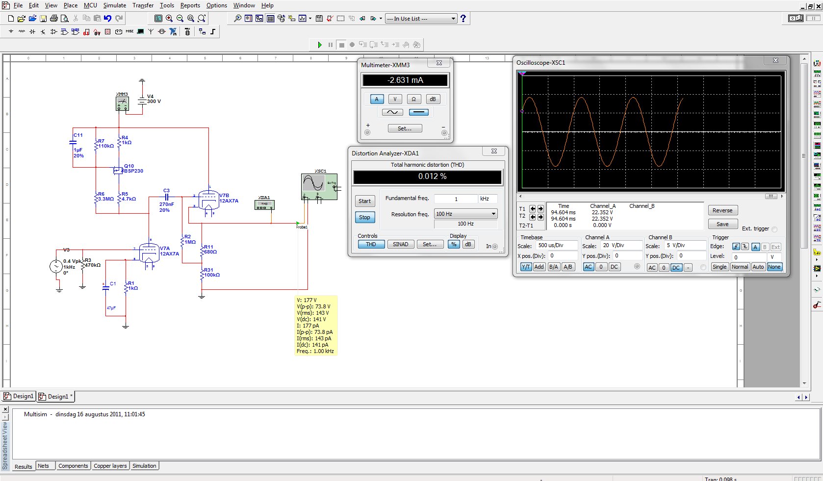

with a sweep I miss some around 15 to 20 khz, it seems that miller capacity is playing a role here, I think more it is the mosfet in gyrator (DS capacity), I use a irfu9310 mosfet, I think I get to use a small one if I use low idle currents, I have use the 12ax7 as a anodefollower and the other section as a kathode follower, I had a tip to use a cascode circuit, but then a feedbacked one, like in example, 10k anode resistor is a gyrator in my simulation, I have not a measurement in real yet, if it is mosfet problem then here also I get problems, because cascode has high resistance on output and I need low...

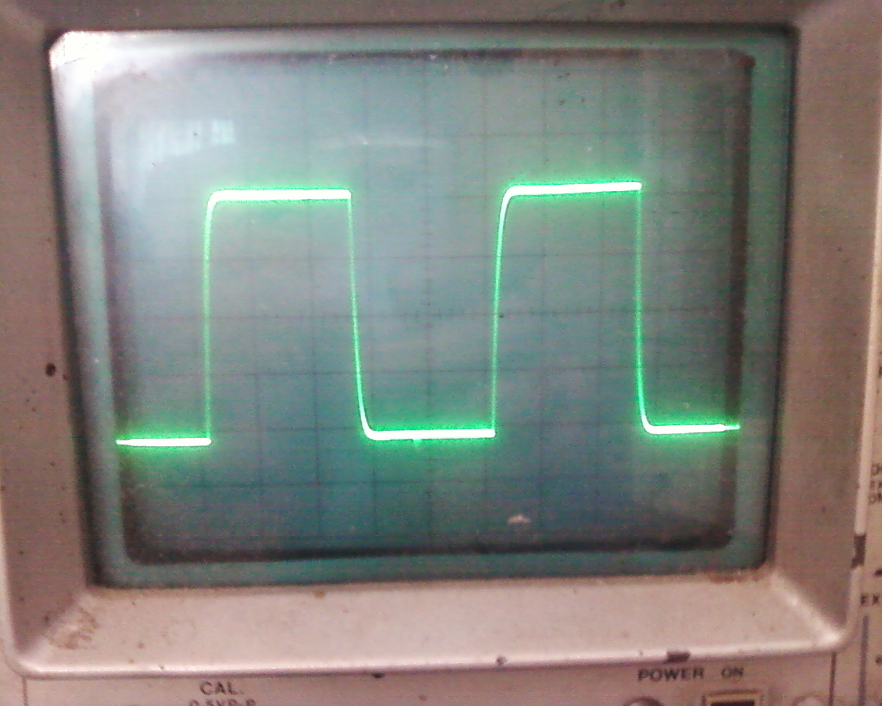

Picture of scoop was with a CCS to anode, driving a EL84 directly without a kahode follower and that was fine like you see, (20Khz) nice square wave.
Welll CCS is back again, then I have no problems with 12ax7 anymore, sound is indeed more harsh with a CCS but stage is deeper, so I have idle the follower higher so I get some warmth, later on I try the bsp25 if I can get it here, because I live in a phillips country., maybe I get answer about this problem of miller here?
