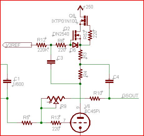

Wait - This will limit you to 0.7v on the gates due to the forward voltage....
Edit: Ignore me, back to back is not anti-parallel![]()
The DN2540 is rated for +/- 20V gate-source but at normal operating temperatures saturates at about 0Vgs, so a single 15V zener connected with it's anode to the DN2540 gate (as you would a P-channel) works fine for protection.

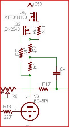

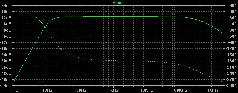

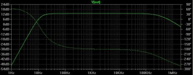

ok here is a cascode version with dn2540. any improvements welcome.

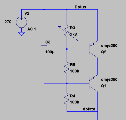

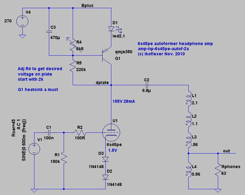

Another idea for the gyrator, which I borrowed from Anatoliy. I have built this headphone amp a few days ago and have been listening to it; I think the sound is very good, very dynamic, smooth, no lack of bass, nice full mids. The autoformers I got from a surplus shop for a few dollars. These are the type of line matching transformers used in store ceiling speakers.
I should add that I personally prefer using the mje350, since it's easily available at local shops and can get them easily. I doubt it'd make a difference in sound, when compared to using a dn2540. But that is just a guess.
Looks fine to me. Since your gate is driven by the plate supply, I think protection diodes aren't necessary. A short from output to ground would be a problem, but that should be easy to avoid.
BTW, with the cascode, a low voltage JFET is an option for the bottom device.
I am just this minute drawing up a similar version (but with much smaller cap and a pnp cascode). I'll sim it to make sure no boo boos.

Indeed, I have made an excellent CCS using the dn2540 in the upper position, and a 2sk170 in the lower position. For higher current one can either parallel 2sk170s, or use a higher Idss jfet.

The big difference to me in the gyrator circuit (MOSFET style) is that the resistance between plate and source can be made larger, thus reducing the influence of the MOSFET gfs characteristic. However, the DN2540 has a relatively linear characteristic. I find that the resistance I need to get 10-20 mA current with a DN2540 in CCS mode is enough to get excellent circuit performance.
I agree with Sheldon as long as the capacitor doesn't get charged above the max Vgs there should be little risk. Still, I only omit the diode in the CCS style circuits... I've not yet blown up a MOSFET (in an audio circuit that is...)

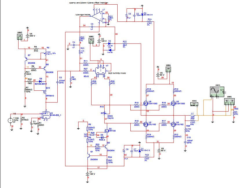

Hi

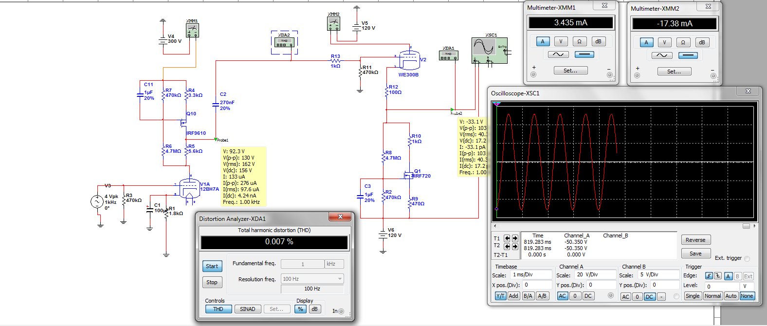

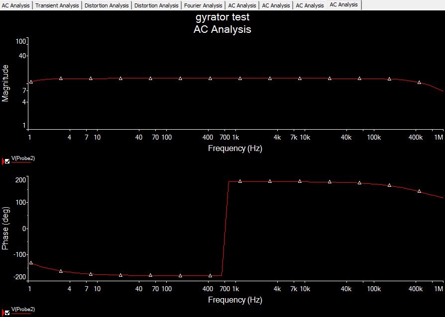

I have made a example what i do, it is a dc coupled hybride.
now I use a CCS for the first and second tube, the sound is hiss to much, the mid is to sharp, feeling of compression of music but this can be the mp3 I did listening to, but resolution of music is exellent, maybe mp3 is much irritant when listening on high end.
foto 1 is a test and the amp I now listen to is foto 3, 2 is the test measurement in multisim of the gyrator in work incl one for the cathodefollower..
I couple the cathode follower dc to the mosfets with a offset ic control it.
I have change the tube EL84 for 6n6p this tube looks more harsing, sharp mid, with the el84 it is was warmer, maybe because of the double triode being paralell.

I don't think that gyrator load of cathode follower is a good idea. Better would be stabilize it by bias voltage on control grid, and load on plain CCS.
Isn't it the equivalent of fixed grid bias? With a low mu triode like 300B it should be OK...
