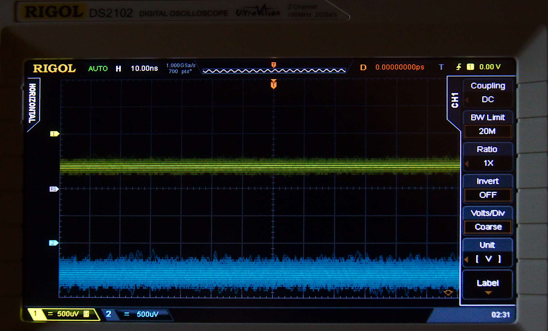

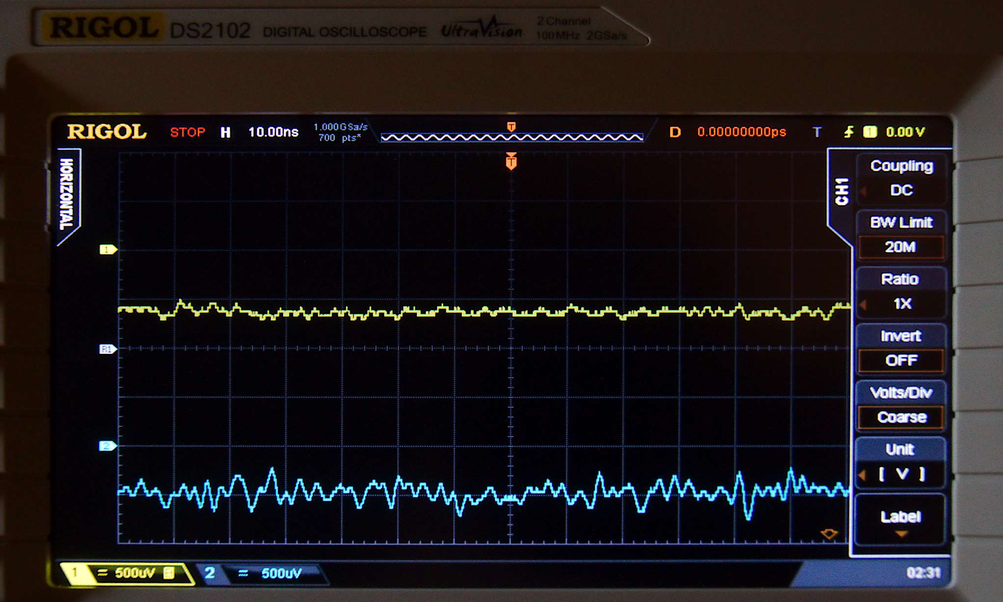

How much is noise RMS at 500uV sens for full out bandwidth and 20MHz limit with the crock clip shorting the probe's tip?
Here the pictures, Ch1 shorted, Ch2 open, Ch1 20Mhz, Ch2 100Mhz 🙂
Thanks. Looks like it has a good front end as DSO's go for noise.

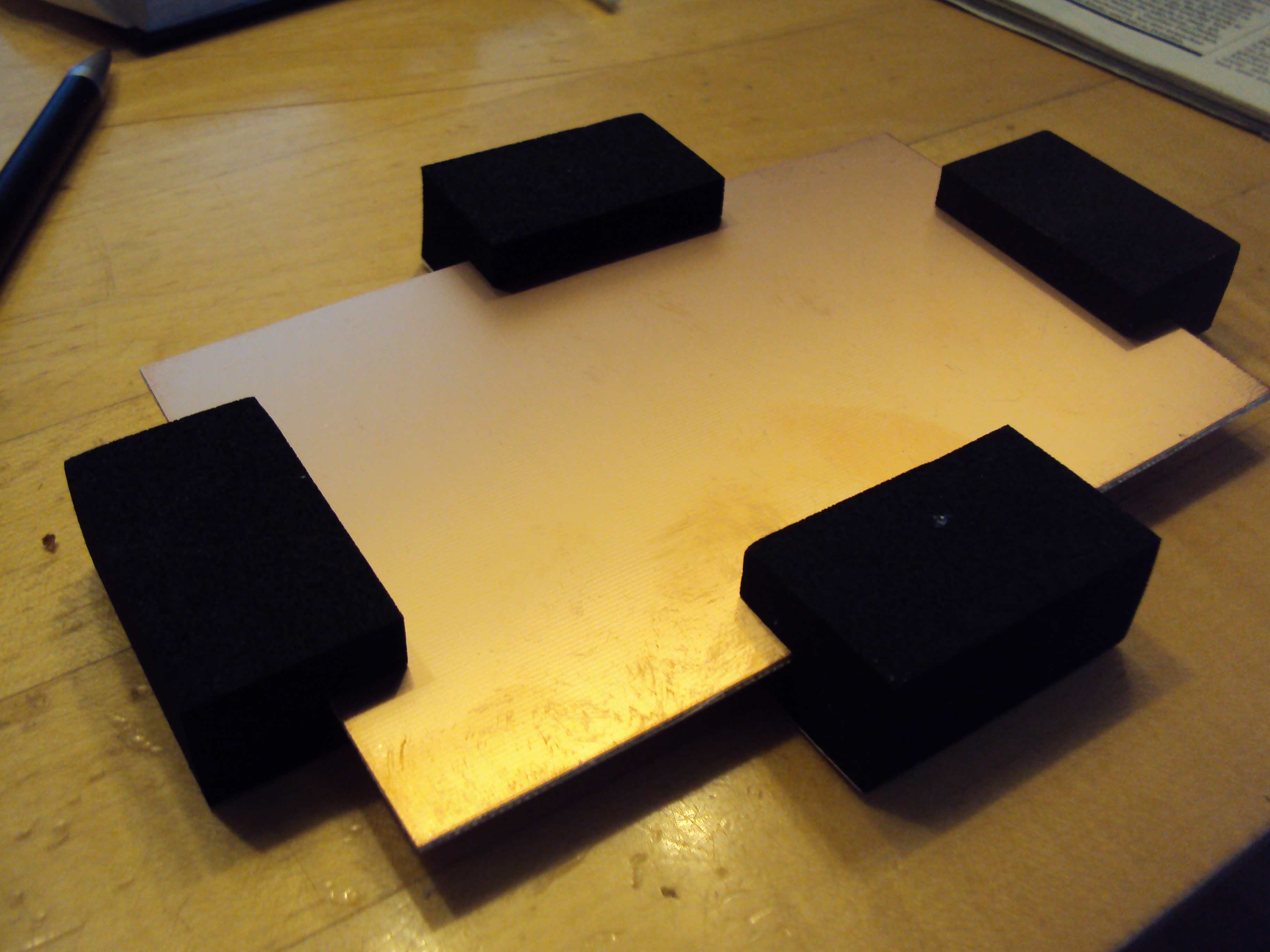

It´s like this.
One possibility that can be transported. The pads can be cut and made smaller or used at the edges.

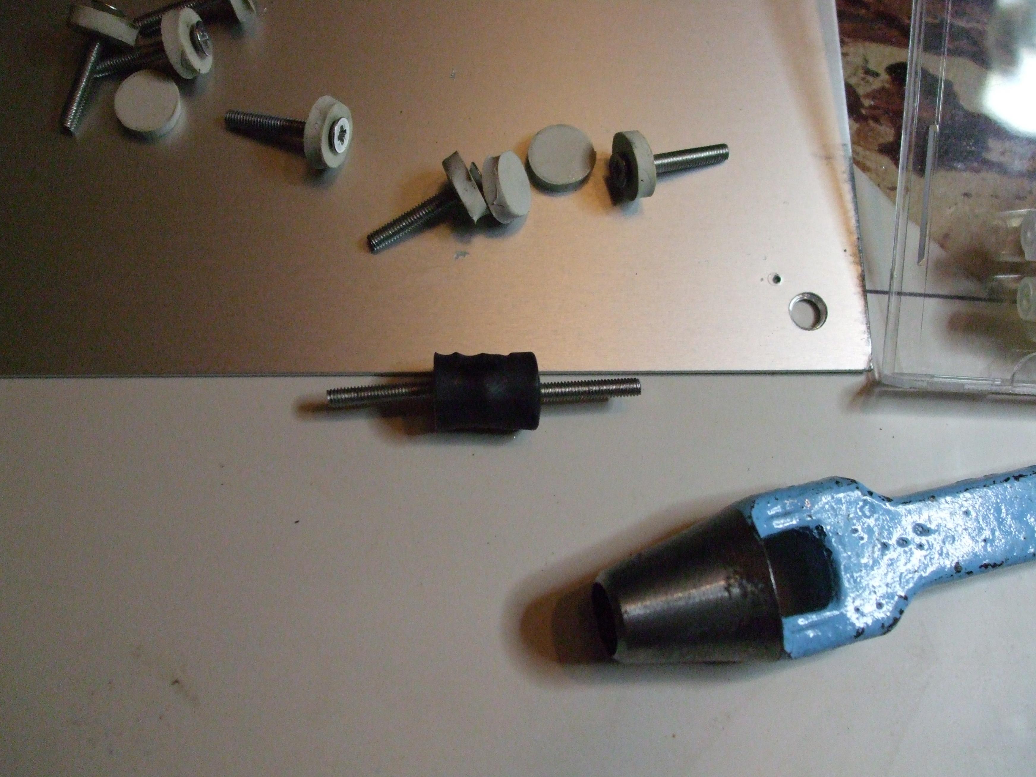

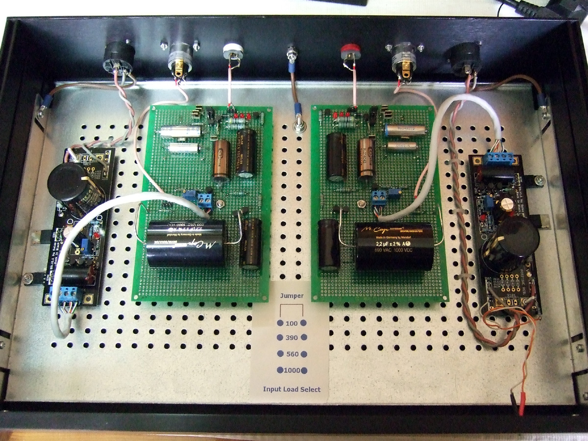

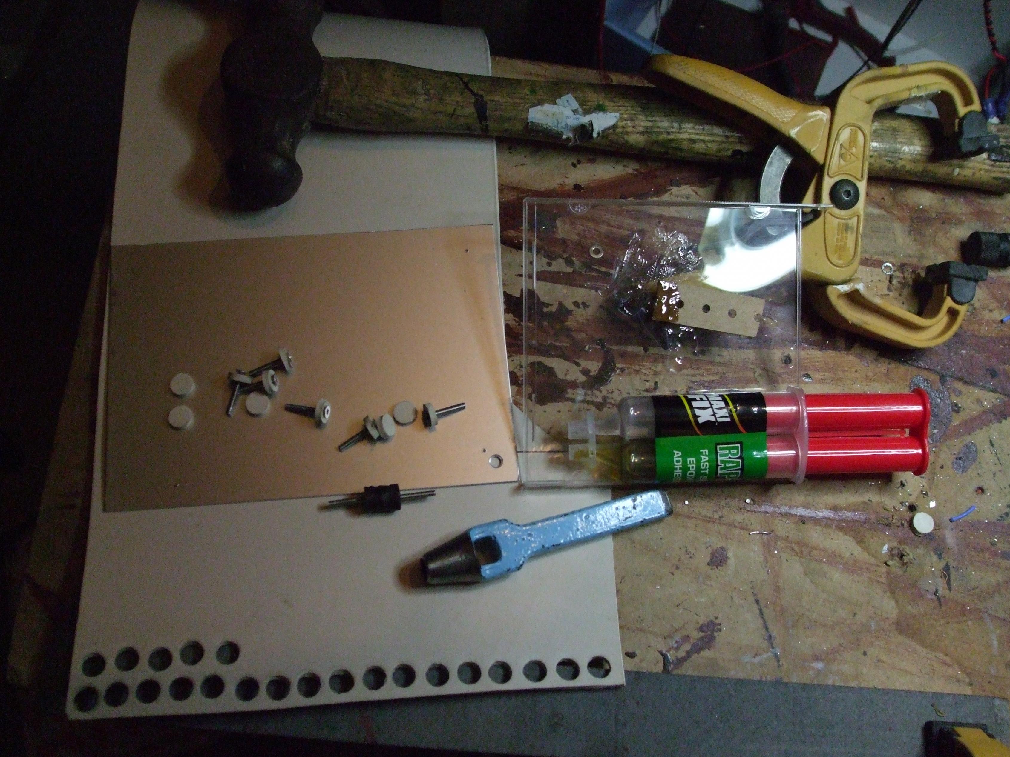

I use a single, little off centre, screw to tension the PCB safer on the pads when choosing some give in mounting. SYLOMER supporting blocks under green boards in this example.
Not only cheap, they can be tuned with or whitout epoxy and with number of circles or rubber type .😀
screws or nuts or duble sided stiky tape avvaliable depending on what is in one draw
